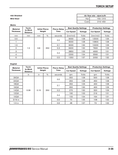

  1. Can you do the thin metal work with the signs etc with a 65? The hypertherm cut charts only show the 65 specs down to 10ga. Can you install the fine cut tips and dial the machine down to cut the thin stuff? I noticed the minimum amps on the 65 were 20amps while on the 45 it goes down to 9amps. I just dont want to buy the 65 and then find out it is totally unsuitable for the sign work because that is what a lot of my work will probably be just starting out.

You would certainly be able to cut thinner material but you would turn the amperage down as you have already noticed. I have the Hypertherm 45XP and it has those lower amperage settings (down to 9 amps) because it has a “marking” ability. You would not be able to “mark” with the 65/65Sync. Personally, I have not been impressed with the “marking” demonstrations so unless you need that feature, I would not worry about the lower amperage.
There are other tables for Hypertherm 65/85 in the manual that go into the thinner metals but it is all based on decreasing your amperage to 45 amps and below. Using fine-cut consumables would also be the key.
Example of one such table:

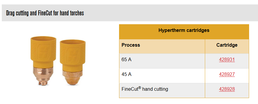

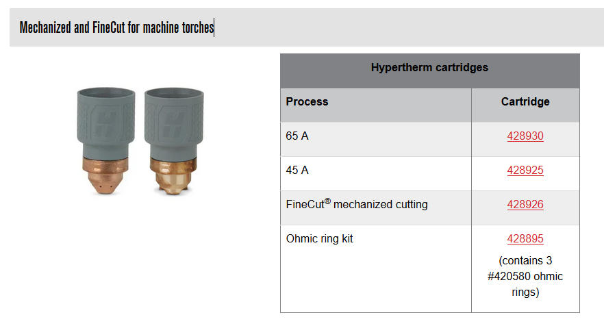

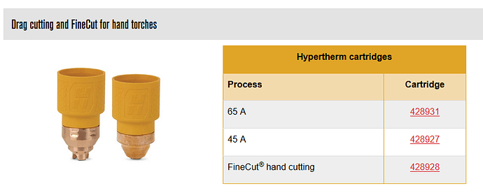

For the Sync machines they have the fine-cut available (This is listed on Hypertherm’s website under the Hypertherm 65Sync machine:

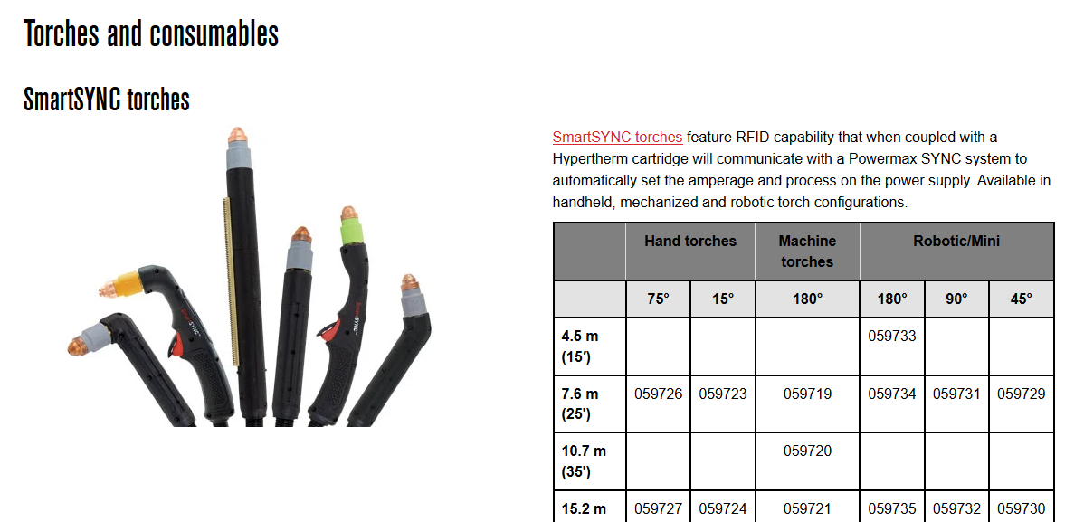

I don’t know that answer but looking on their website, they are not allowing the option to buy anything other than their SYNC torches if you have a SYNC machine:

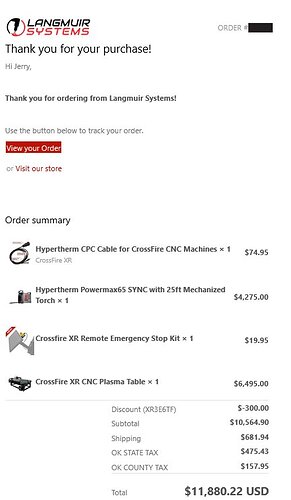

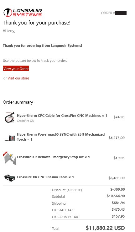

Well I decided to go with the Sync 65. I did some searching around and it is not easy to find just a standard (non-sync) Hypertherm. Reading between the lines they will eventually stop making non-sync consumables for them and you will have to go with aftermarket or use the adapter to run the sync catridges. That is all guesswork though.
So just decided to embrace the suck and get the SYNC LOL
So XR Pro, CPC Cable, Estop and Hypertherm Powermax65 SYNC is on the way.
