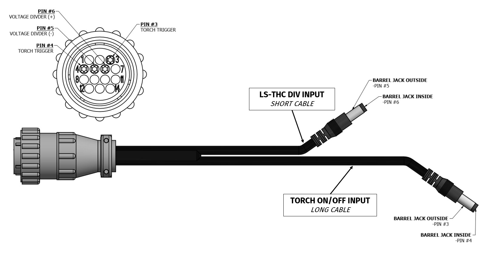

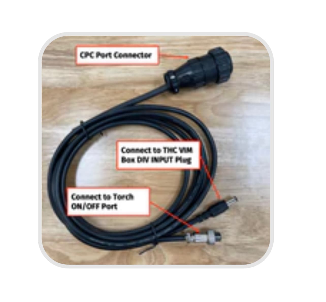

Are you using the langmuir CPC port wiring adapter to hookup the hypertherm?

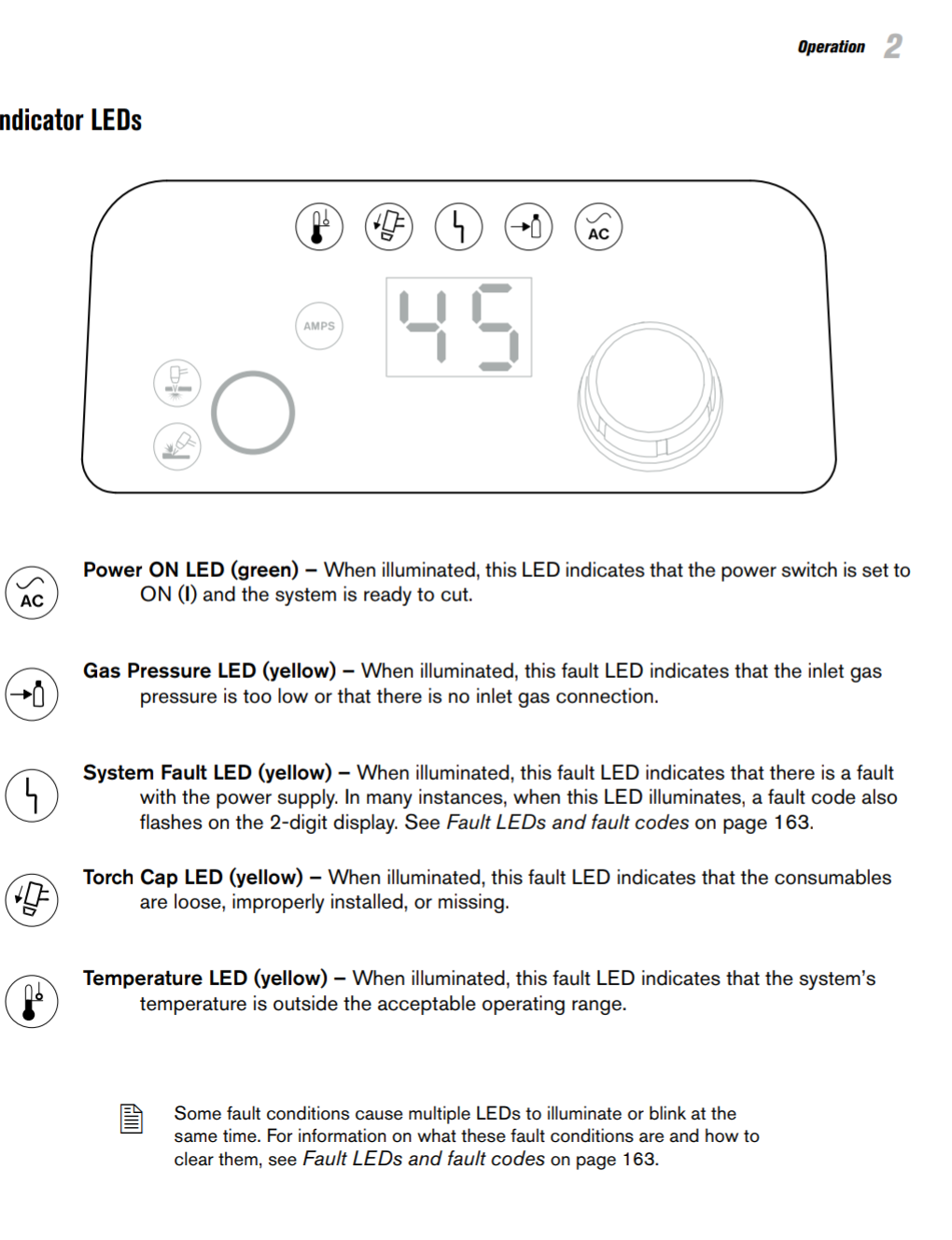

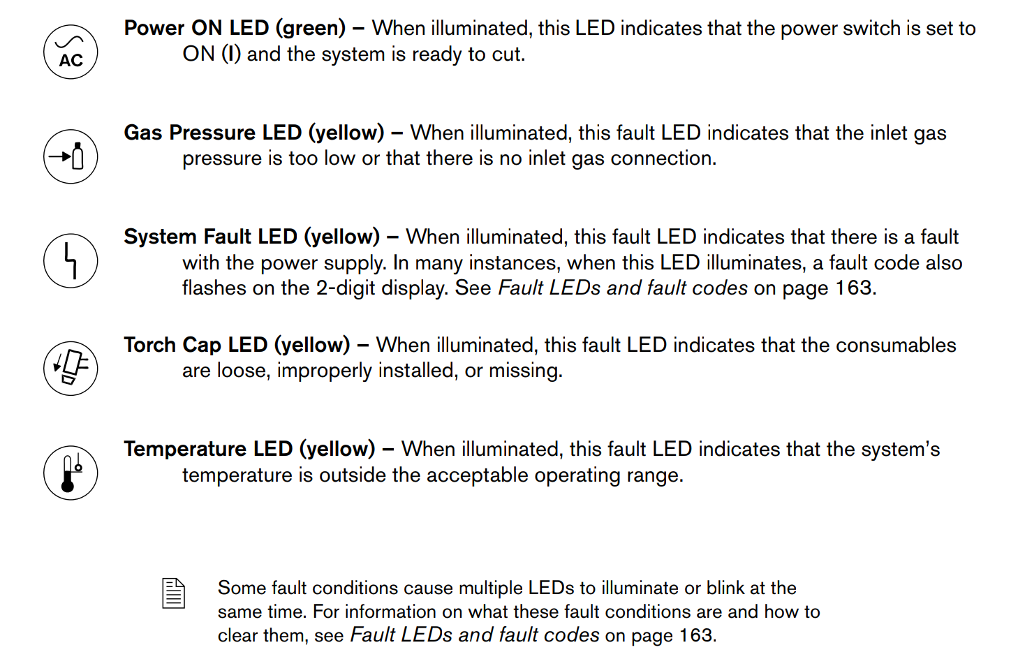

Which yellow light comes on.
That machine should have a green light on it when it’s ready to go.
Yellow LED typically means a fault.

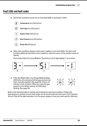

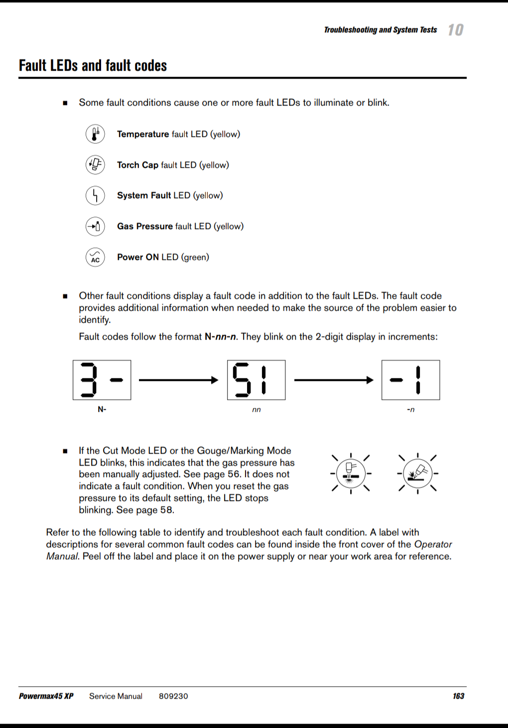

Page 163 of the service manual starts to go over the yellow LED fault indicators.

Machine torch only, COC cable from Langmuir installed Mac 120 psi straight off the compressor, what I meant about the yellow light is that it comes on when you turn off the switch on the torch indicating that the switch is working. And yellow light turns off when you turn the torch on, it’s on cut mode also, only thing I didn’t try yet is to unplug the Cpc cable and see if it fires
Could you possibly have the two barrel connectors mixed up off your CPC connection?

My Cpc cable has one end that goes to the div and other than is a screw on type that goes to box off the table
And with your torch and a safe location , if you just jump out the end of the torch on/off cable it doesn’t fire your hypertherm?
Cuz if you hear no relay click maybe the relay is not seated correctly. The relay inside the langmuir electronics enclosure.
The only click I hear is from the thc box, I get 0 arc or air off the torch
I don’t think anyone suggested that running unconditioned air into your hypertherm would cause it not to fire.
Try to jump out the two pins on the end of that screw type connector and have your torch a safe position to see if it fires.

I’m having similar issues- 45xp machine torch won’t fire consistently. I can often hear a click when it’s supposed to start, but usually no air and no pilot. Following this thread, I tried “jumping” the torch on/off cable as suggested and it did fire. What are my next steps? Replace that cable? Happy to share more about what it’s (not) doing and what I’ve tried if more info is needed. Thanks!
