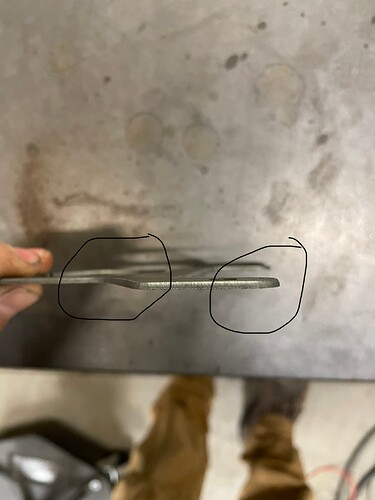

All cut directions are correct. I changed to non fine cut consumables this morning and ran a test. I will post pictures of the bevel I am seeing all the way around the part.
@ChelanJim here is a picture of the most recent cut. I even manually input the voltage and the cuts are identical to the cuts utilizing the THC.

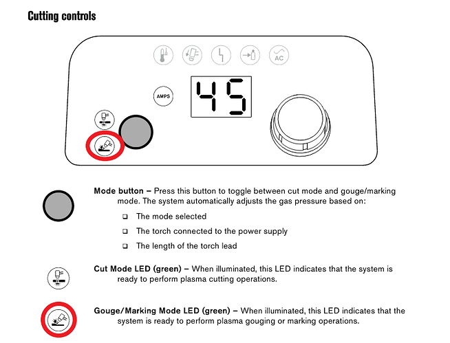

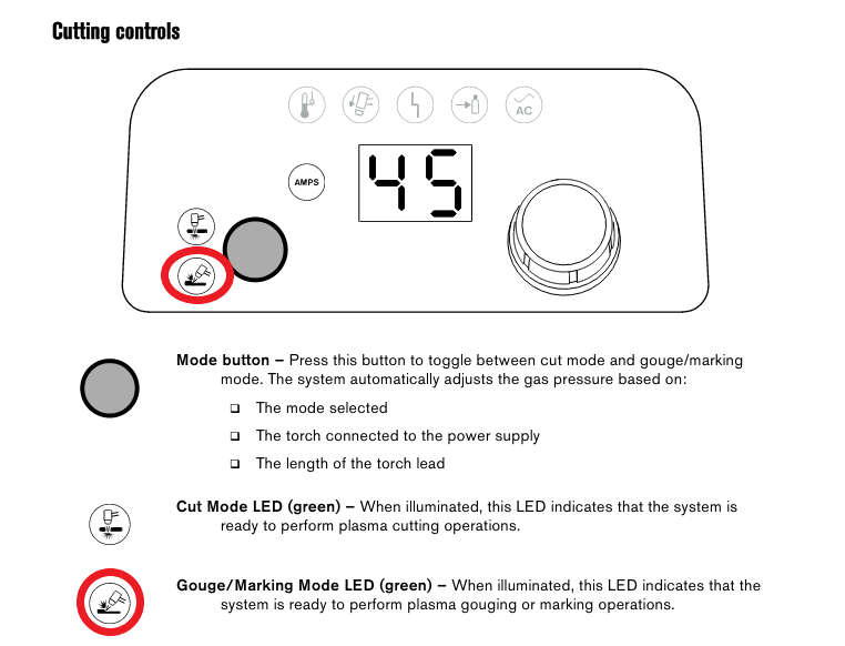

@SpecBuilt - You don’t by chance accidentally have the gouge button pushed/mode selected on the Hypertherm do you? Left side of the control panel, soft button, and two green LEDs. Top one should be lit for cutting.
Sticks, that is an excellent thought/suggestion.
