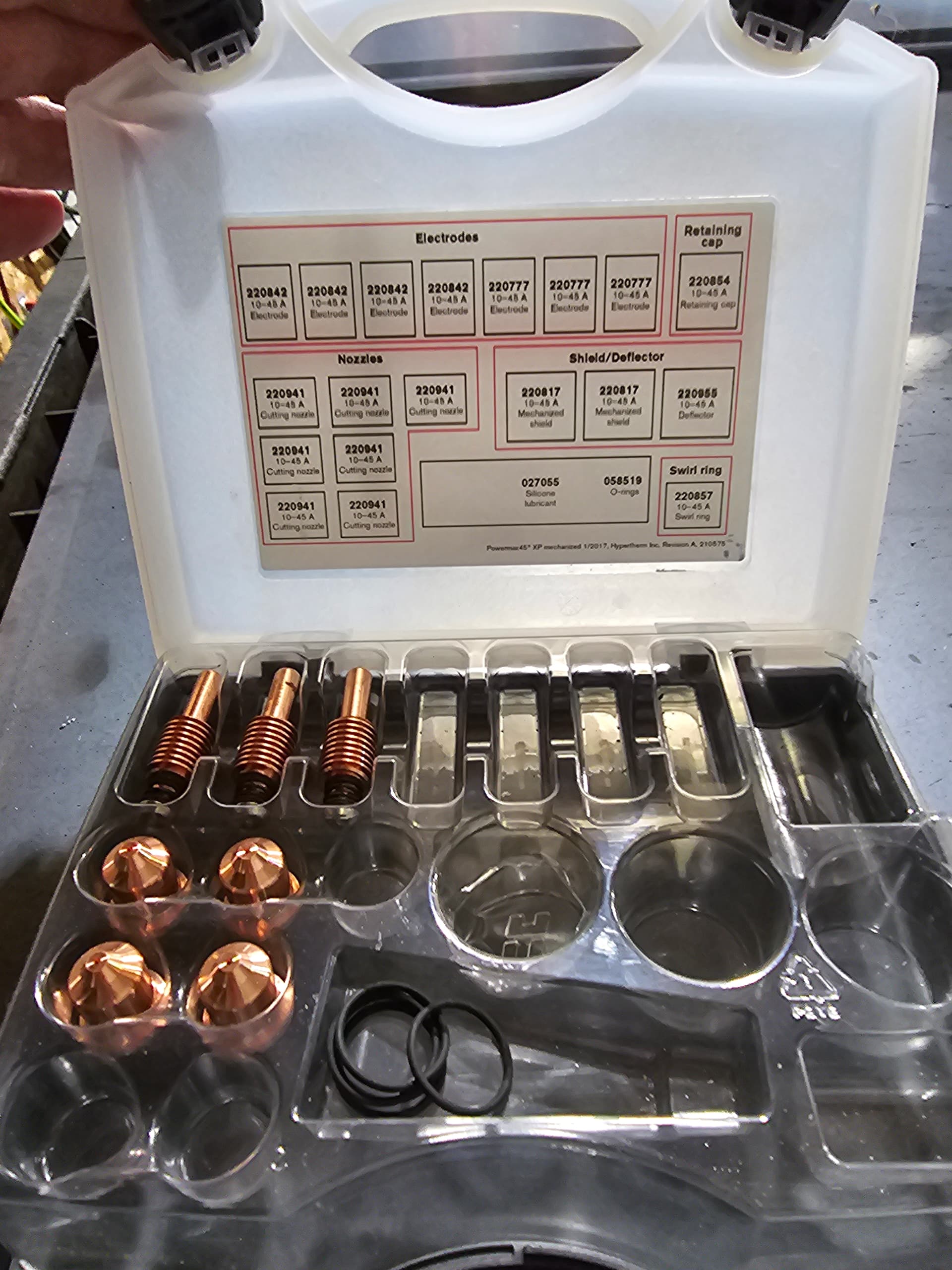

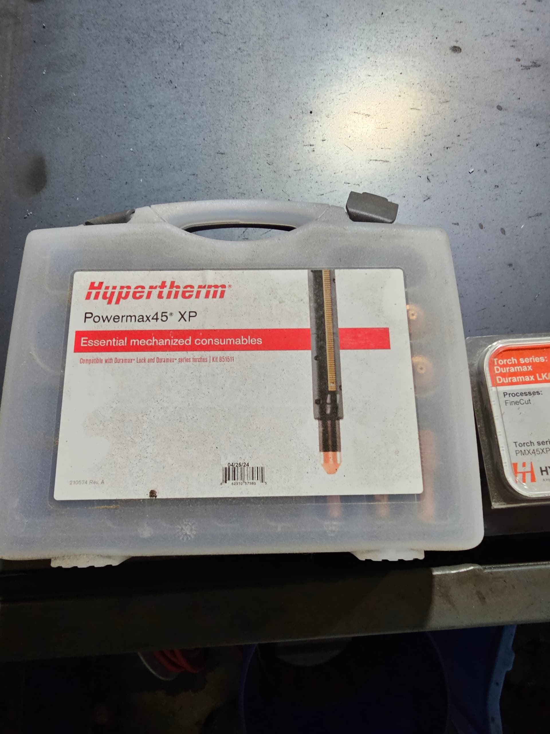

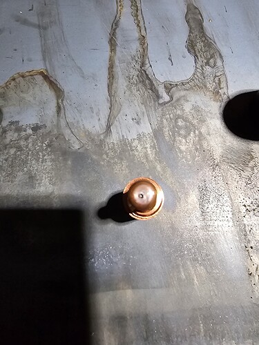

Consumables Packaging

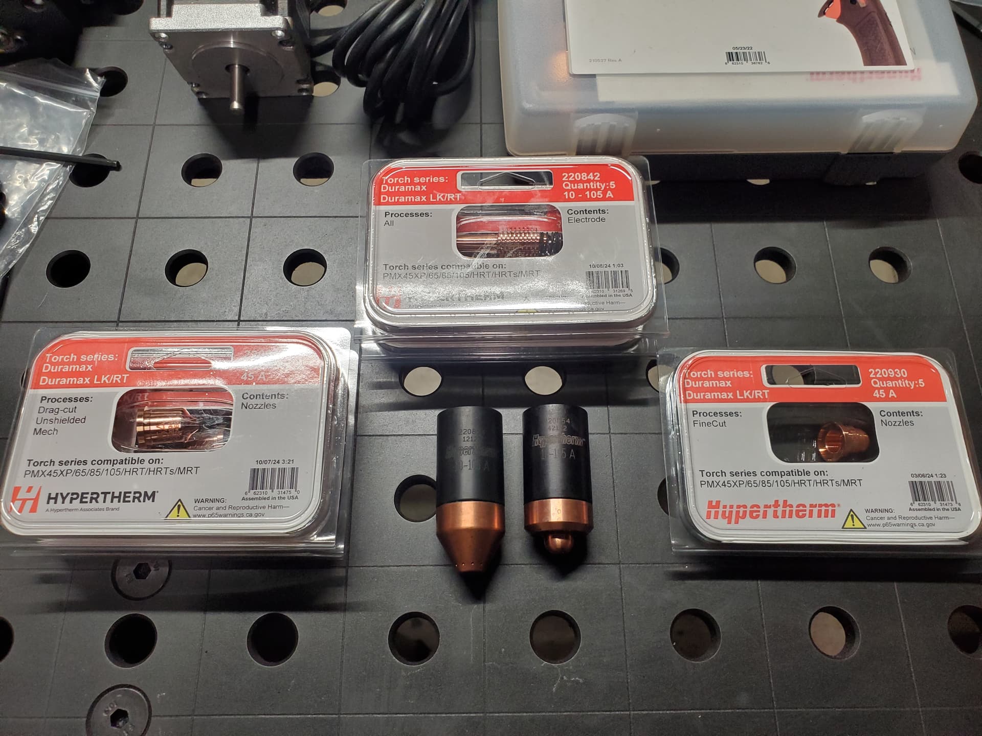

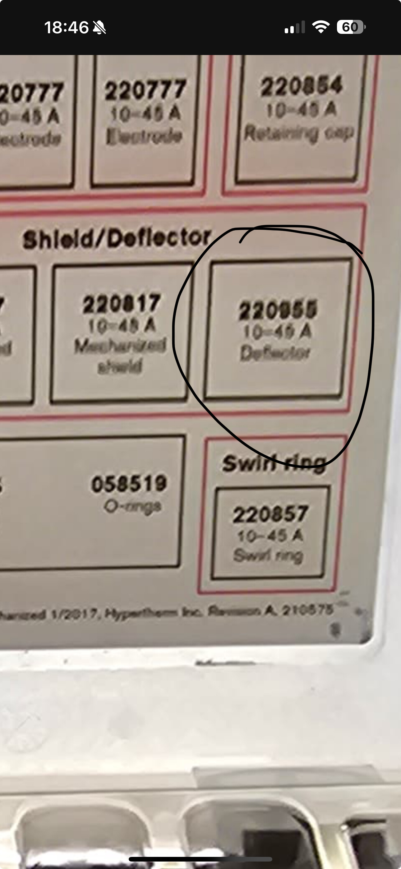

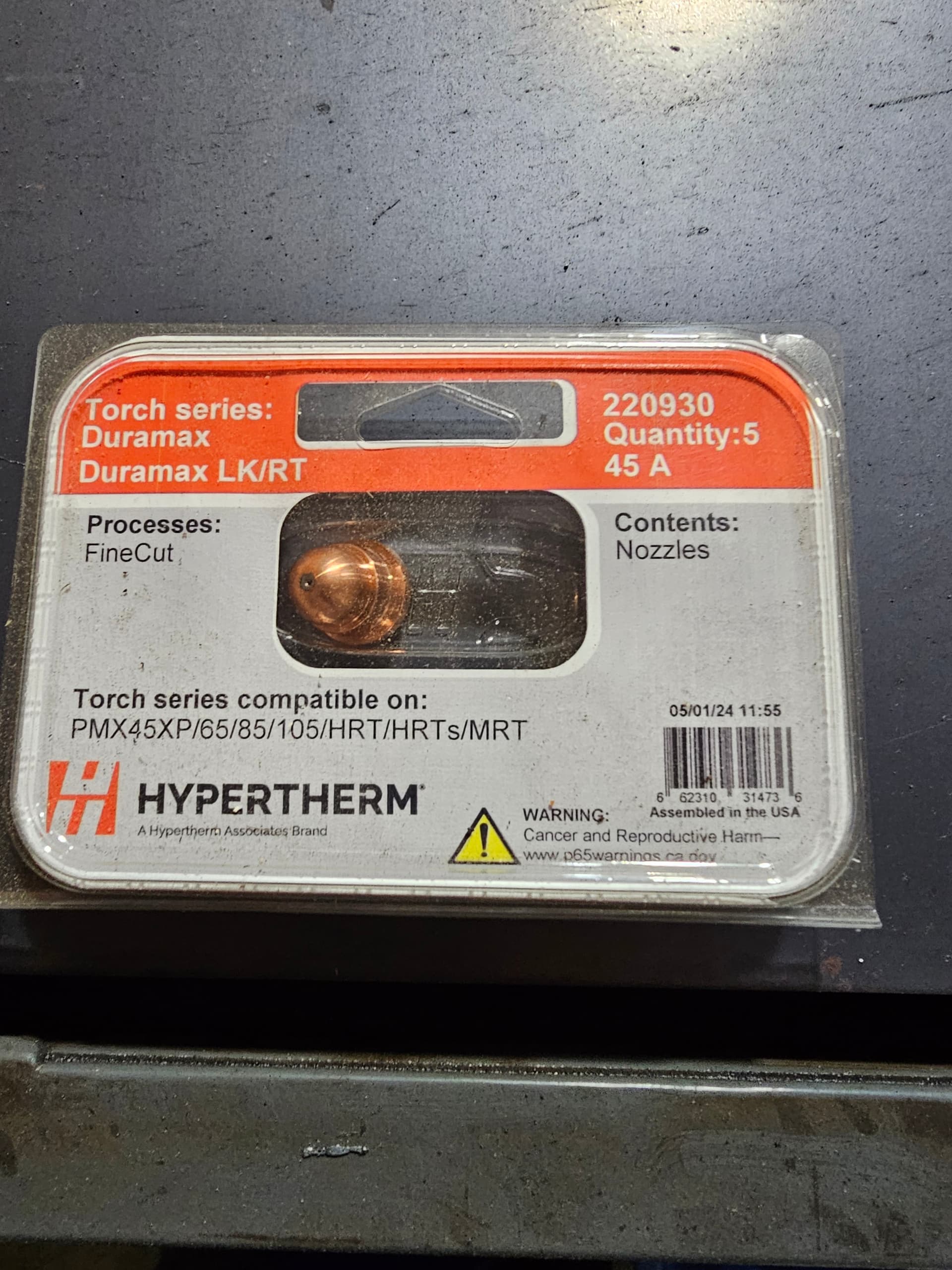

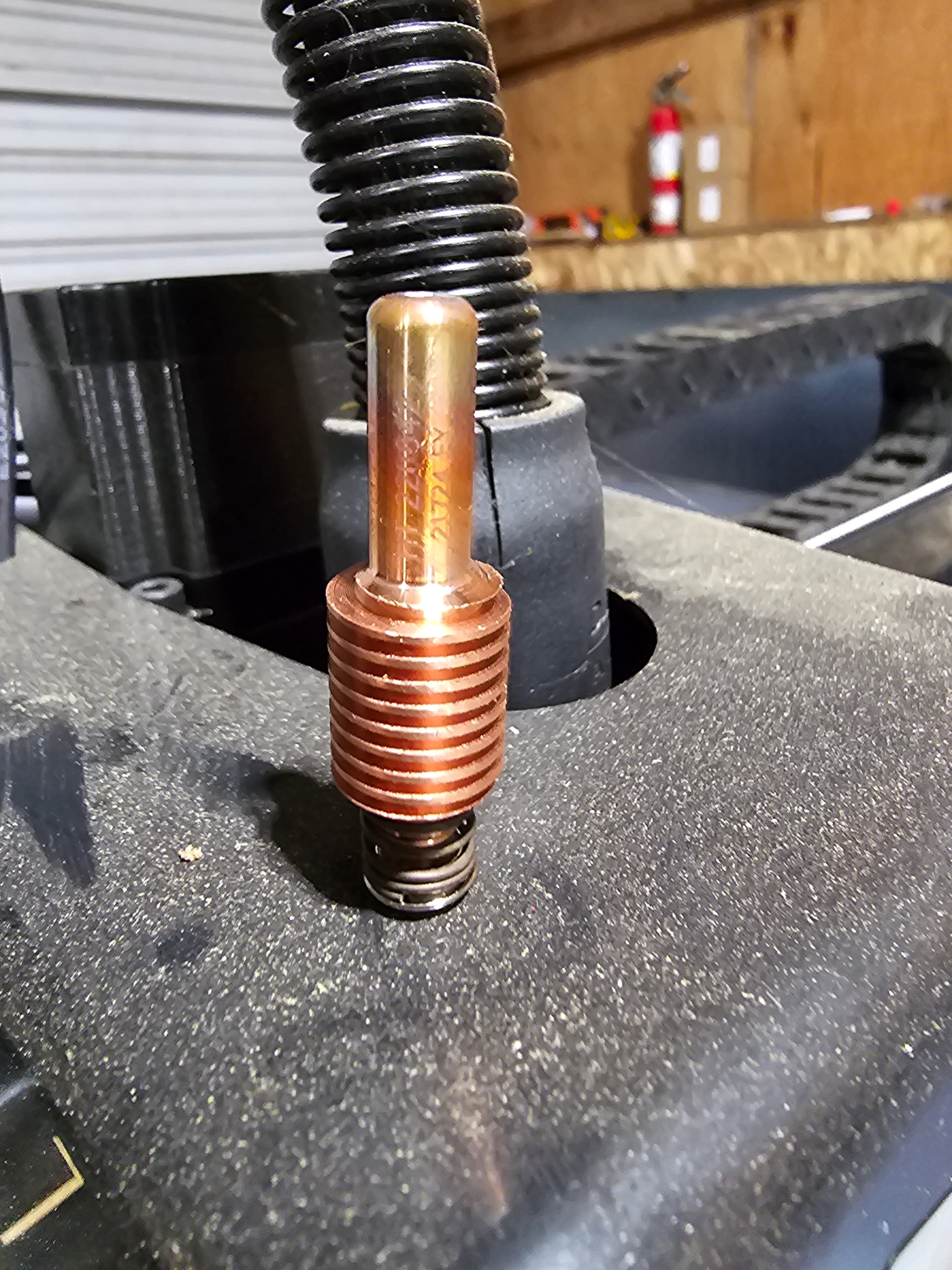

You might be mixing consumables. That mechanized pack lacks three of the pieces you need: deflector, swirl ring and nozzle. I see you only showing the fine cut nozzle.
When you try Fine-cut are you changing the three components? If not, that could explain your situation.
Solid advice, although he did say he’s using the appropriate components per his other post.

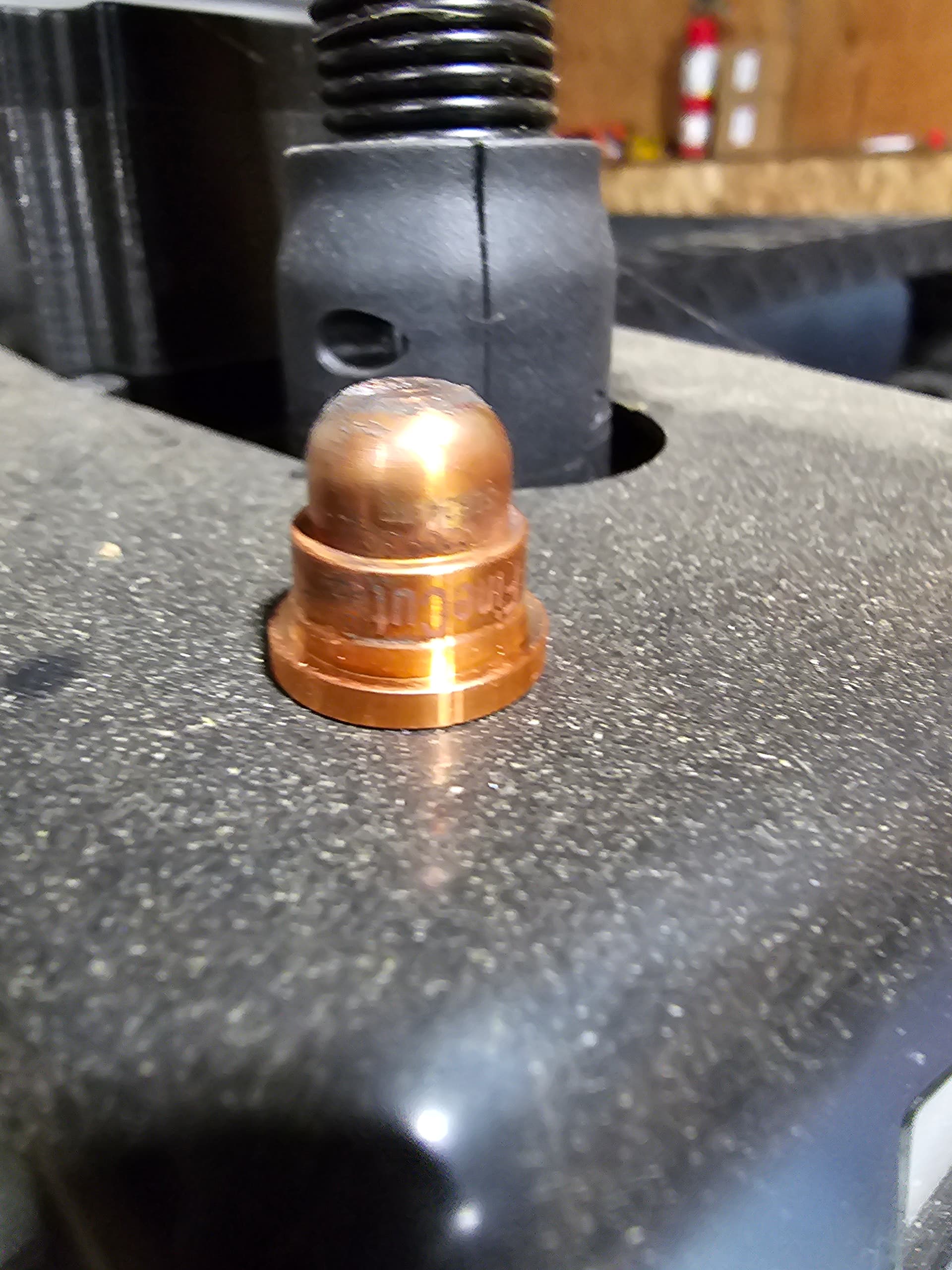

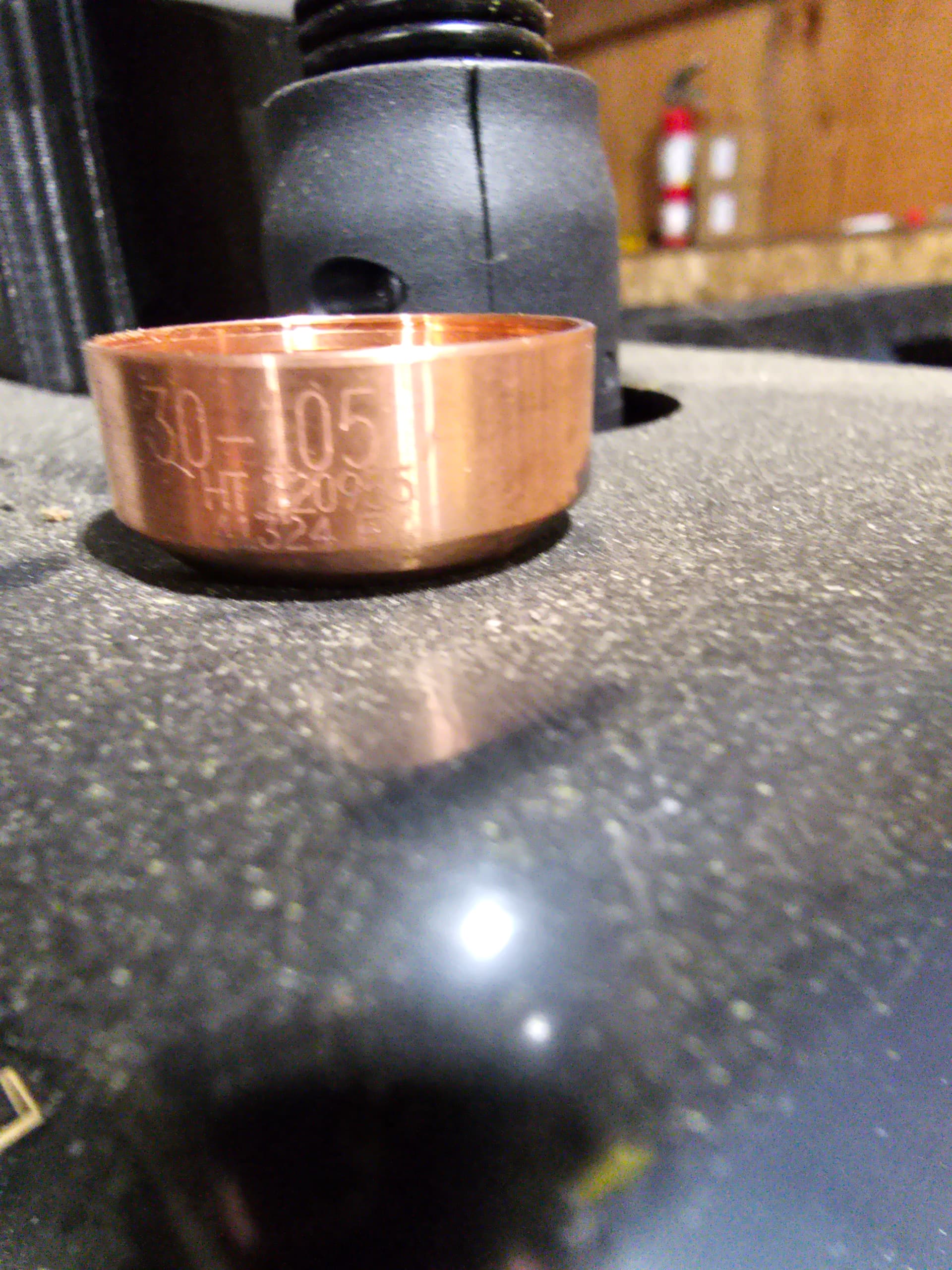

I kind of need to see pictures of the actual components now. :wink:
No, the deflector comes in that pack, it’s just not in the pic.
Fine cut swirl ring is not required to be changed. I have a screen shot from Jim Colt confirming this.

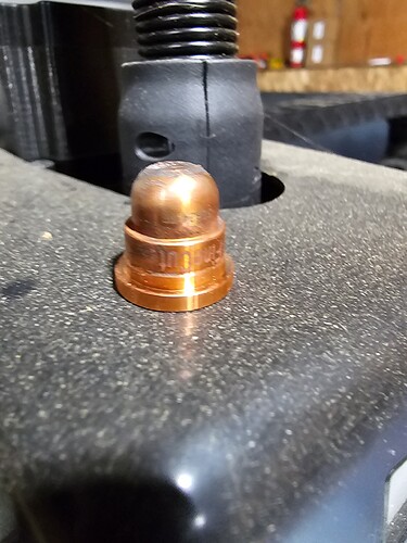

Yes me too. And the condition they are in.

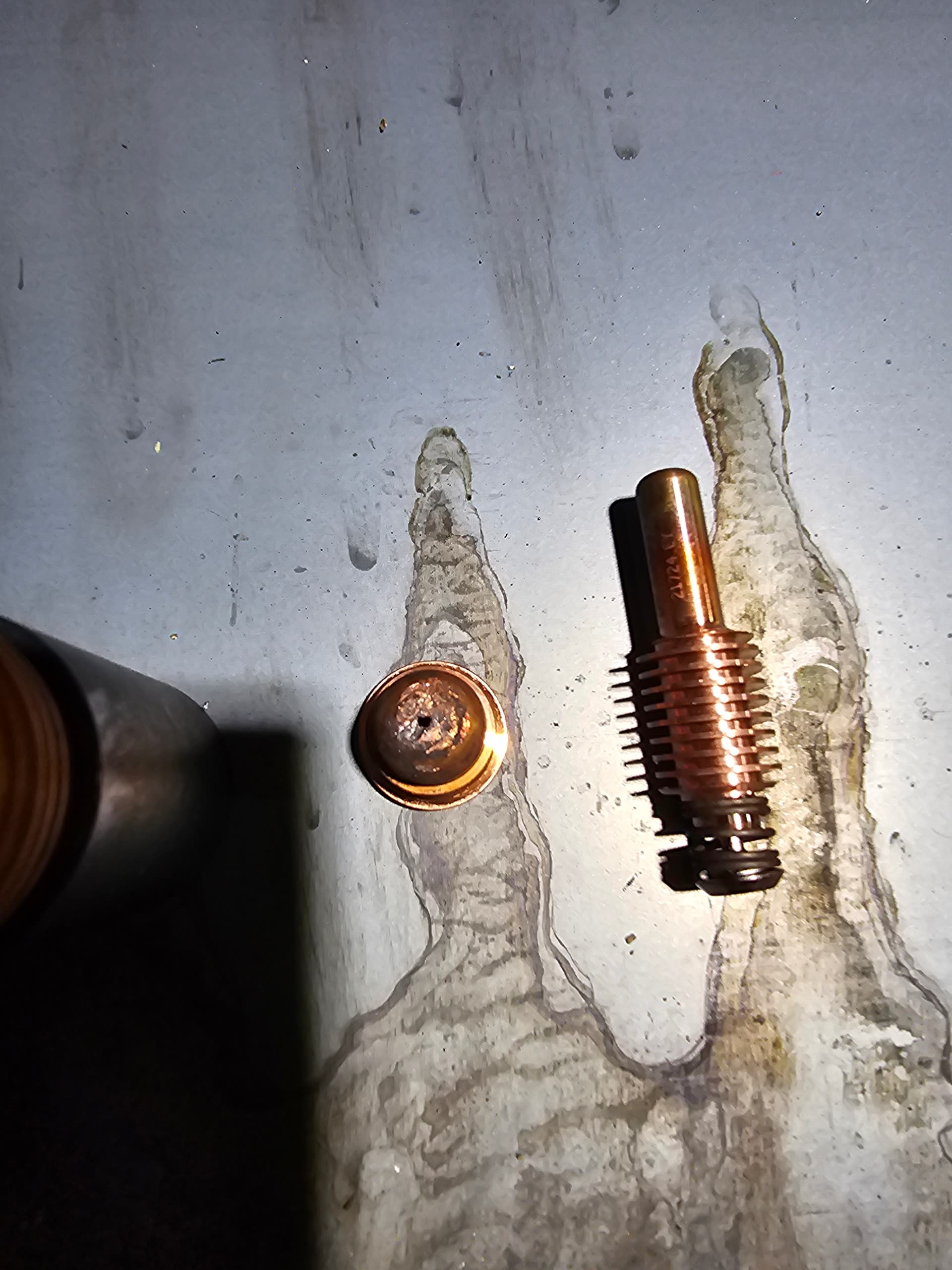

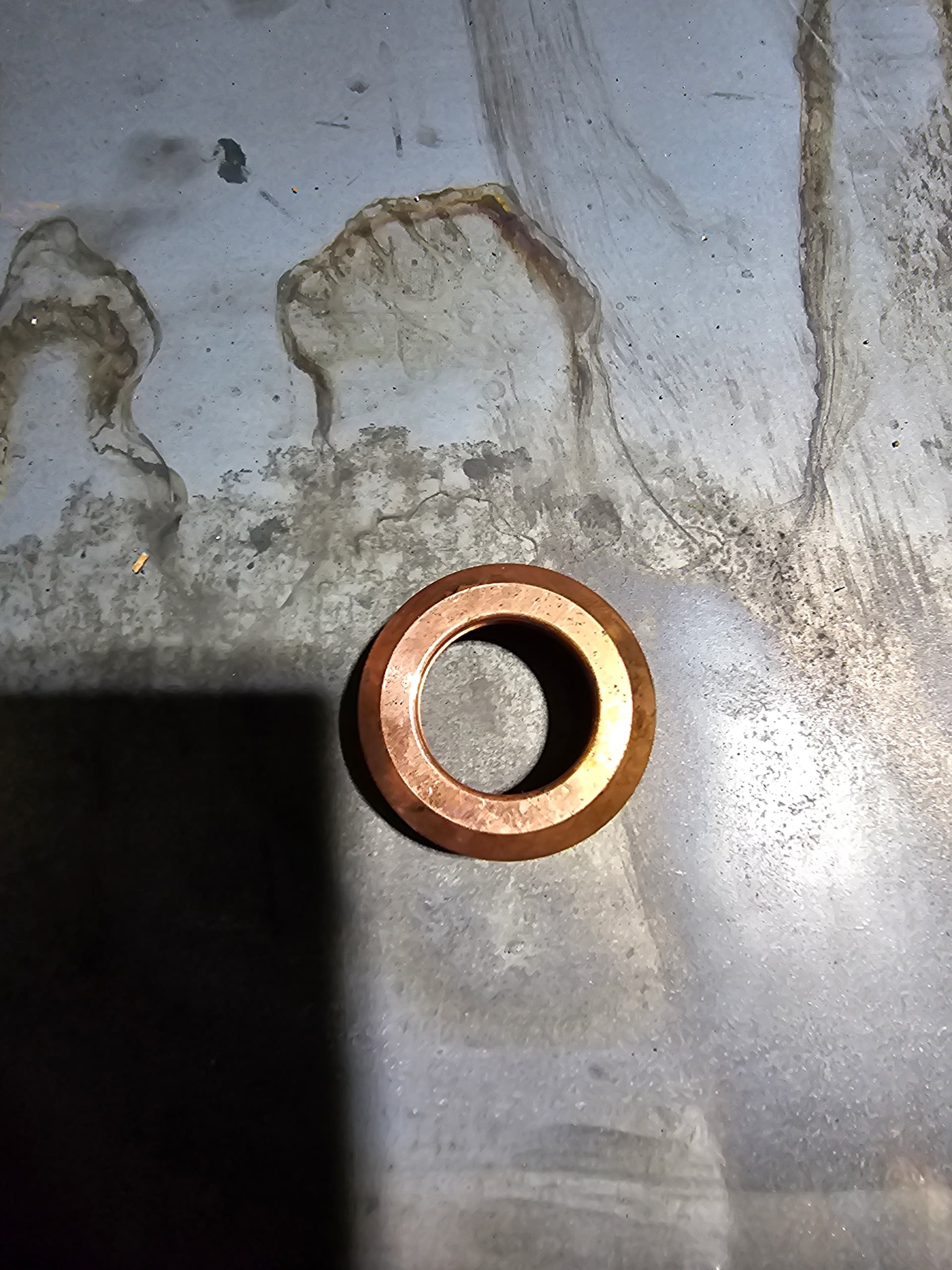

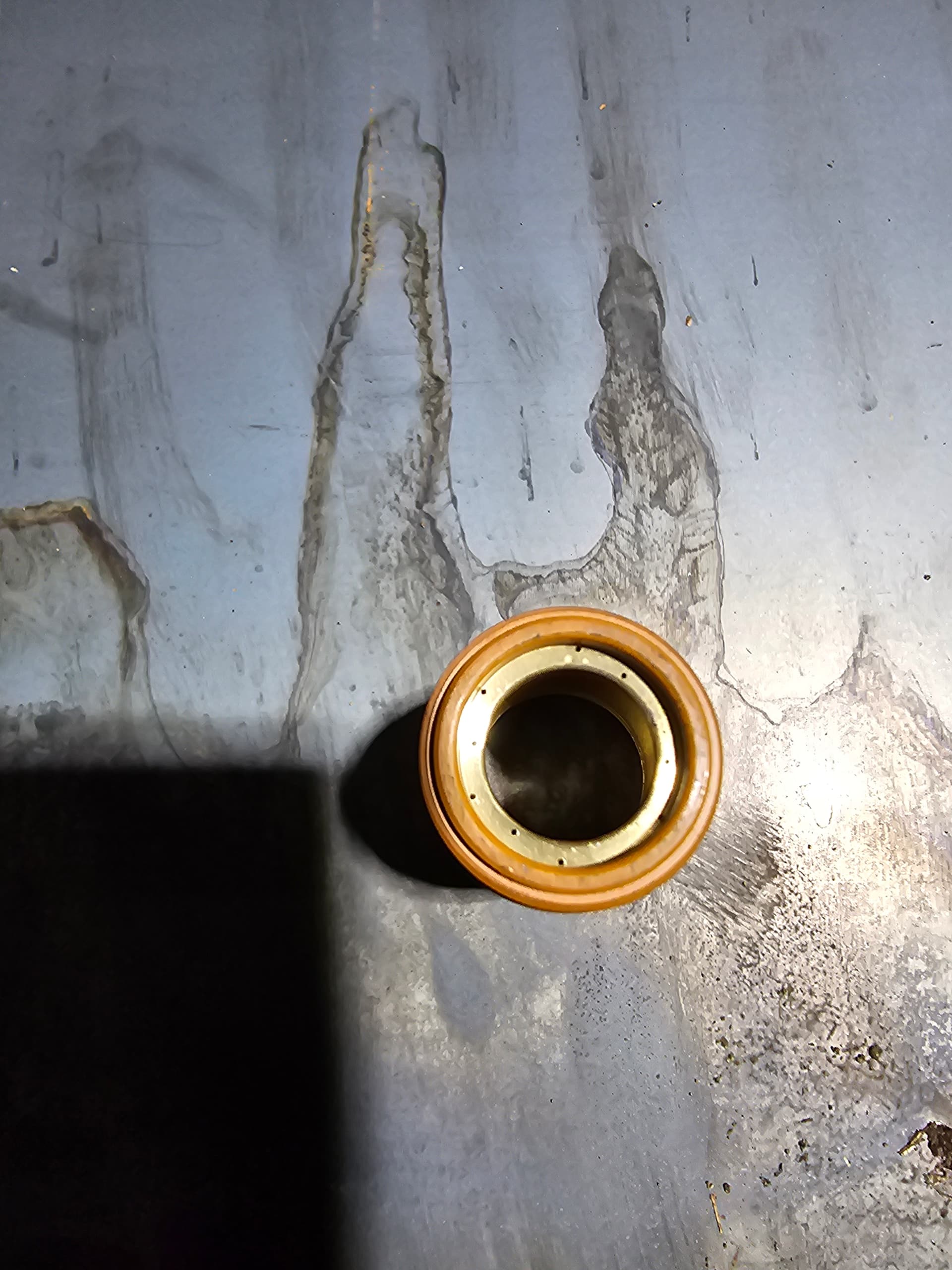

Just pulled the consumables out of the torch. Whatever was going on, totally shot the nozzle and possibly electrode.
No time to run the table tonight, too much to get done around the farm. It’s gonna have to wait til tomorrow.
