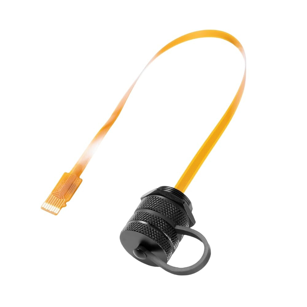

I see they make a SD card extenders
Wonder if that would work
Work great, use them in many of my consoles.
Hopefully, you won’t have to touch it again. I have looked at the through-panel type and kept it on the front of the machine. It comes with an 18-inch lead and a dummy SD card to plug into the PI.

I used this contraption and drilled a hole in the side. You can plug the card in from the outside. Amazon.com
Well now, would you look at that handy dandy!
It have to go out the side. The ribbon cable is only 12”.
Ah yeah I’m using an extension but it’s a tail inside the machine. Nice find on that one.
Its waterproof as well.
