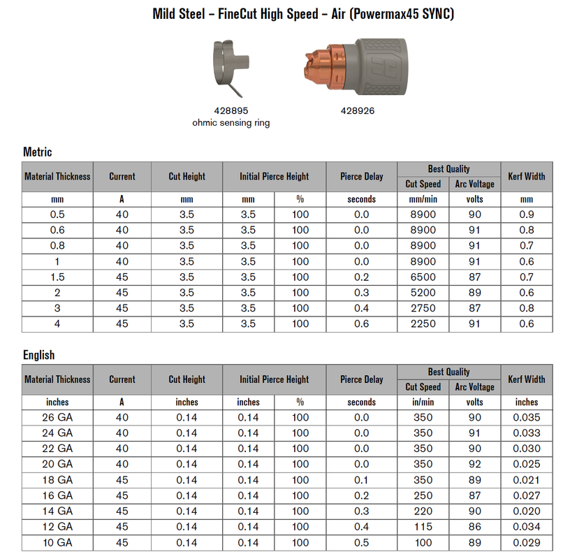

I have been using the Hypertherm 45 SYNC mechanical cut chart. It says to Peirce and cut at 0.14" this is way higher than the .06" the RazerWeld used.
For 11g I split the difference between 12g and 10g for my cut settings.
Slowing for the inner circles down to 70% and with the right kerf set, the thing is cutting within .010" if not better in accuracy with the new cartridge.
I think my bevel is more than 3%. I will bust out the pin gages and see what it is exactly. But the dross build on the bottom of the cut also says the voltage is too high per the book.
Thank you for the info on where to edit the voltage for the cut. I have left that alone. So starting point, one needs to test cut and just watch it? Its hovering around 95v. I see the THC saying OK, then Up Z as its cutting. So I will change that starting setting from 0 and put in 95v. and see what I get.
But I’m concerned about the .14 cutting height from Hyperthem settings… maybe that’s the issue? I have that set to that as I am posting the program.

The sync uses a lot higher cut height. I would either pause you cut and measure or run this program and measure to see what you are off.

In F360, I set up a duplicate of the tool profile and renamed it 250-45A-ID-Hole. Set the slower cutting speed that has worked the best so far and decreased the kurf size so it would “cut oversized” by .009". This is putting the final cut almost dead on the money for the ID cuts in the 0.250 MS.
This way I can repeat all the data for any new 1/4" MS parts with ID features I need to slow down for. This way I don’t have to oversize anything in my drawings in case the ID feature is driving another part or I move the part over to a vendor with a laser table.
