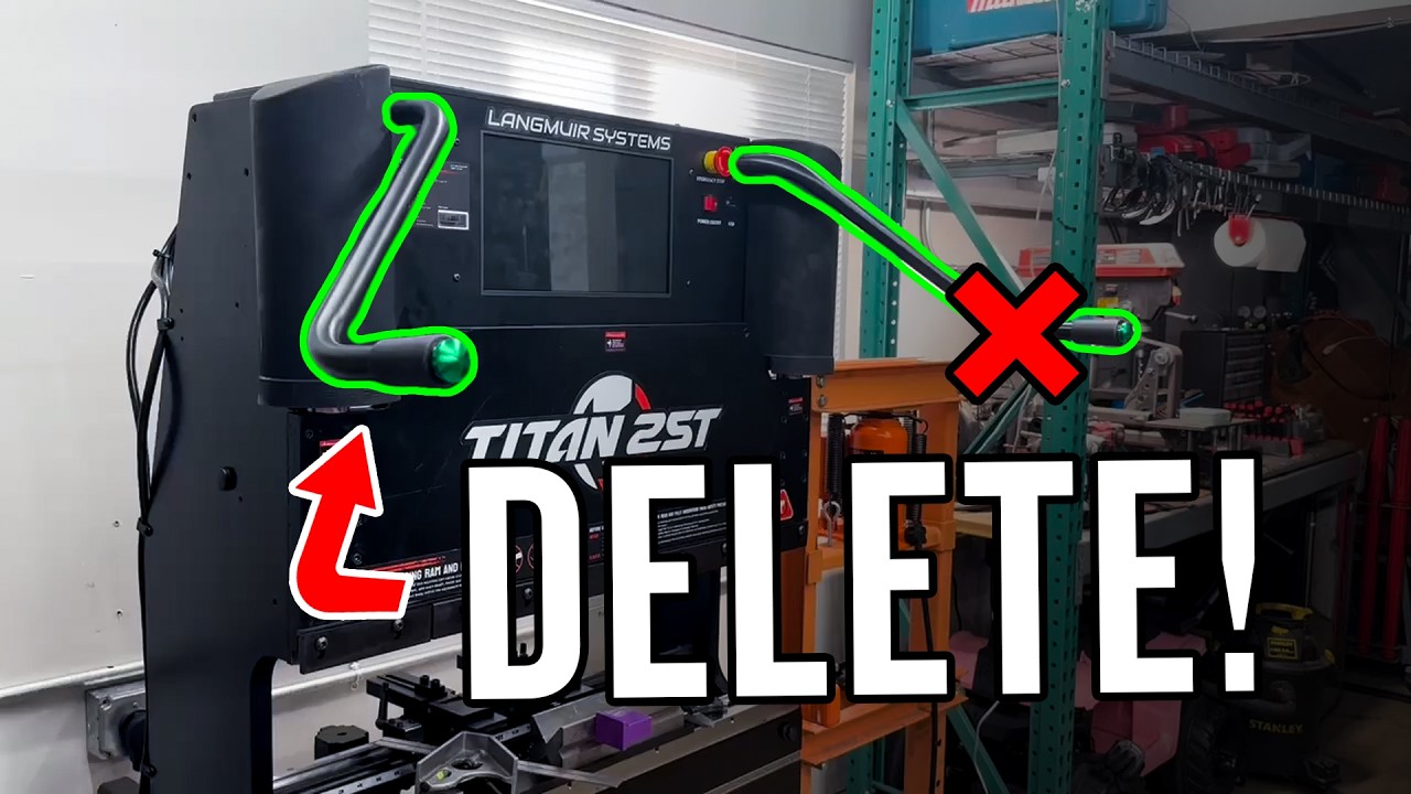

How to DELETE the JOG ARMS from the - Langmuir Titan 25T Pressbrake
In this video I will be showing you how to bypass those horrific jog arms that come from the factory. This modification will be incorporating all the jog function and bending into a single foot petal that has two switches or pedals one for the jog and one for the bending.
I’ve also made this diagram to help.
Ratha, you are killing it on the 25T! Love your videos on IG and YT. I have a lot to learn. I wish you lived closer so I could just pay you for a few lessons!
Folks, if you also want to delete your (skull bashing) arms, here’s a slightly easier, but not as fancy method…if you know someone with a 3D printer.
I installed these in about 10 minutes, start to finish. The files are from “casperonics” - https://makerworld.com/en/models/981374.
