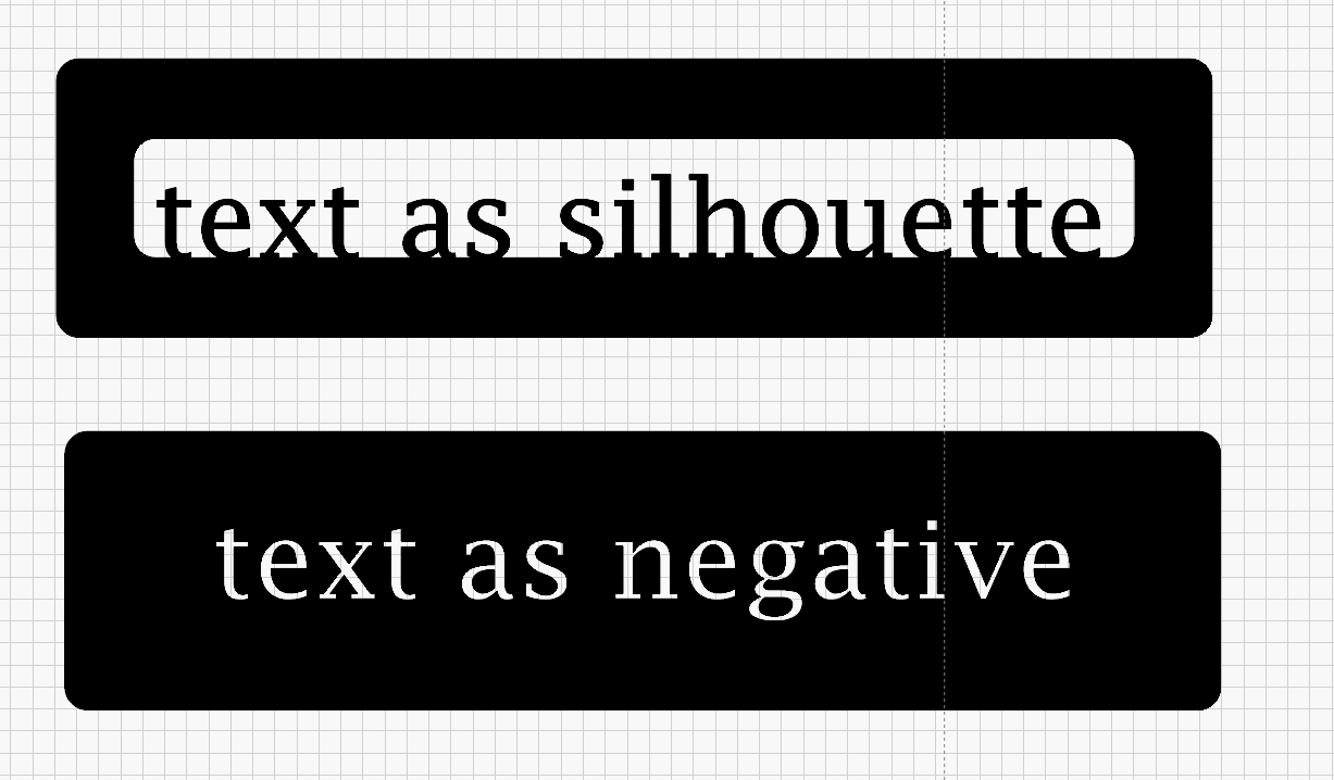

I have found bridging to be all manual CAD manipulation of the text shapes once rendered as individual objects/shapes. In Lightburn CAD, its fairly easy and quick, it has boolean shape melding tools that facilitate bridging. Even quicker is to make the text a silhouette shape instead of a negative silhouette, then no bridging needed.

You can’t union or difference a string of text. It has to be broken apart and done one letter at a time
