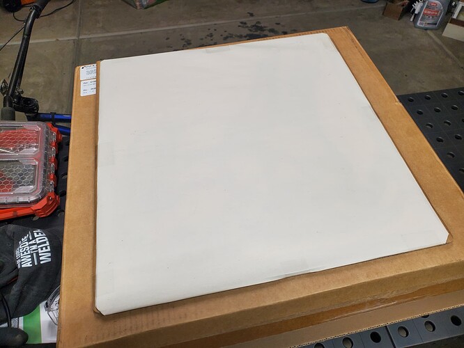

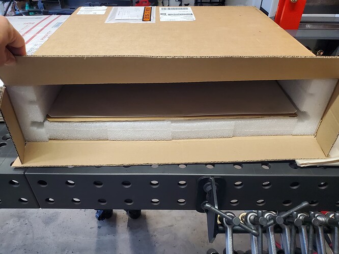

I don’t do signs, but if someone wants one enough I give them realistic expectations of shipping costs because I like to double/triple up to prevent any flex.
However, my last customer paid for and shipped me a box with foam so I could send him a sign I made.
I’m in CA and he’s in NY so…it was traveling quite a bit.

This may help too…
Seth
P.S. Cardboard, like with most things being shipped, is never enough. Enjoy…
