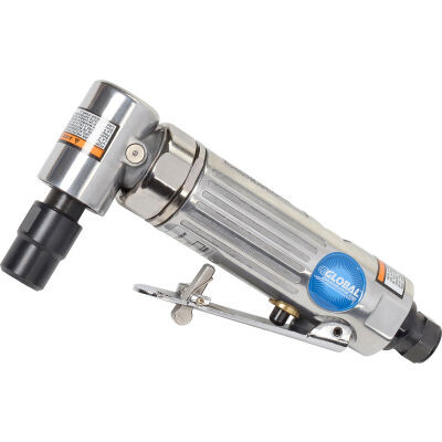

Will look into it. I currently have a pneumatic die grinder like this and using maroon rolec discs.
I’ve read in the forums that some people use these. Just not sure what’s appropriate. I’ll be further dialing in mild steel and stainless soon.

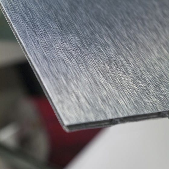

No, No, No… Swirl marks are not suitable for aesthetics. Those tools are great to have, but if you are going for pretty, then you need a better tool. Nice smooth straight lines​:grin::grin::grin:
Haha yes agree on the aesthetics part…just trying to avoid spending more $$$ on tools right now…although it is Black Friday :sweat_smile:

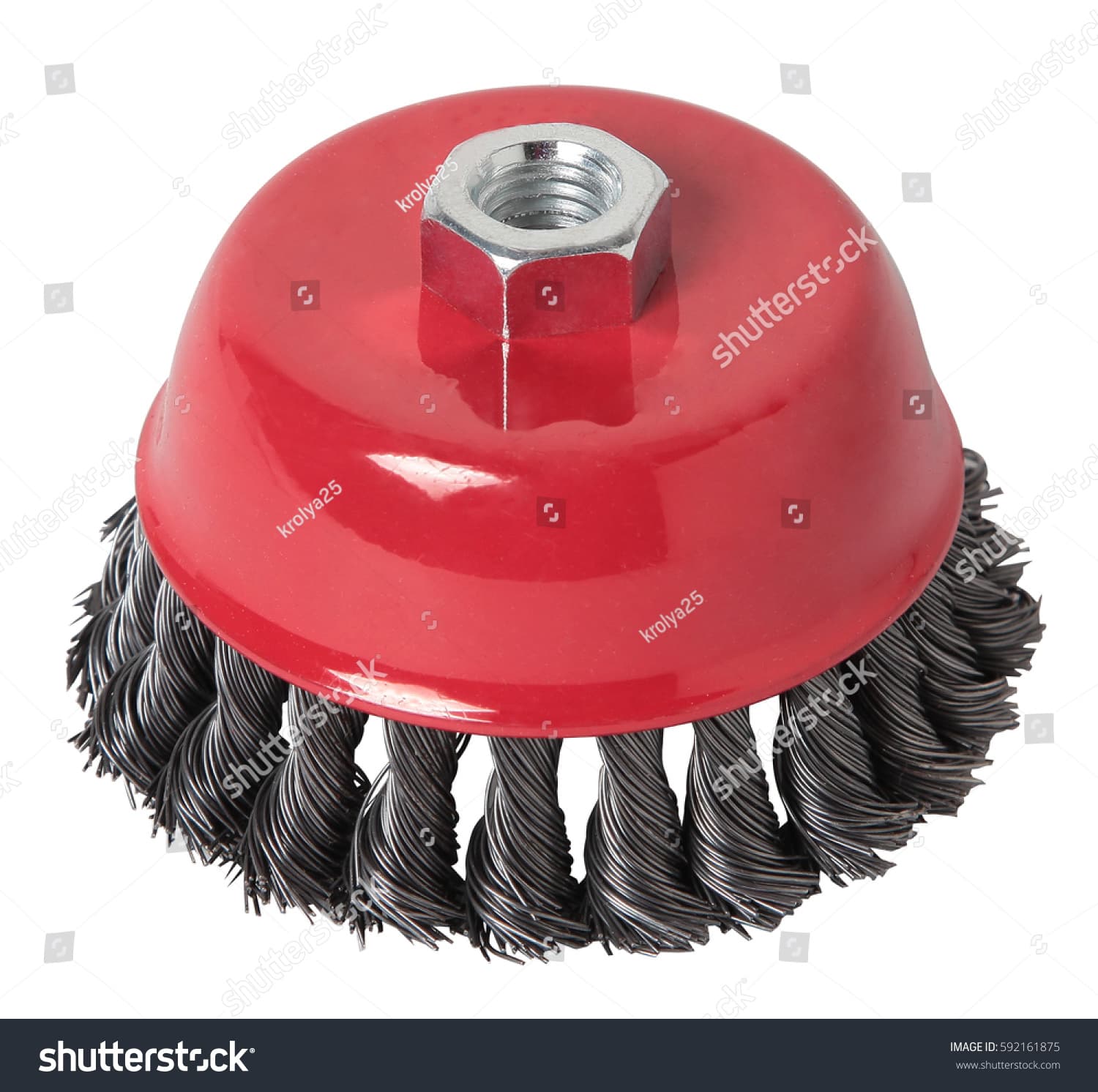

Most people use the wire cup or wheel at one time or another.

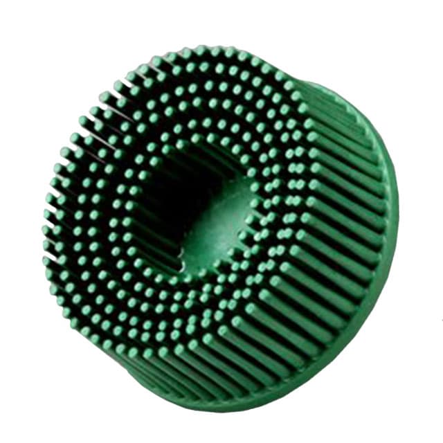

The bristle brush, I have one, as it was recommended in MTD Racing video for mill scale and it really works great. To remove slag/dross, it is an expensive alternative. It will wear down quickly with hard dross.

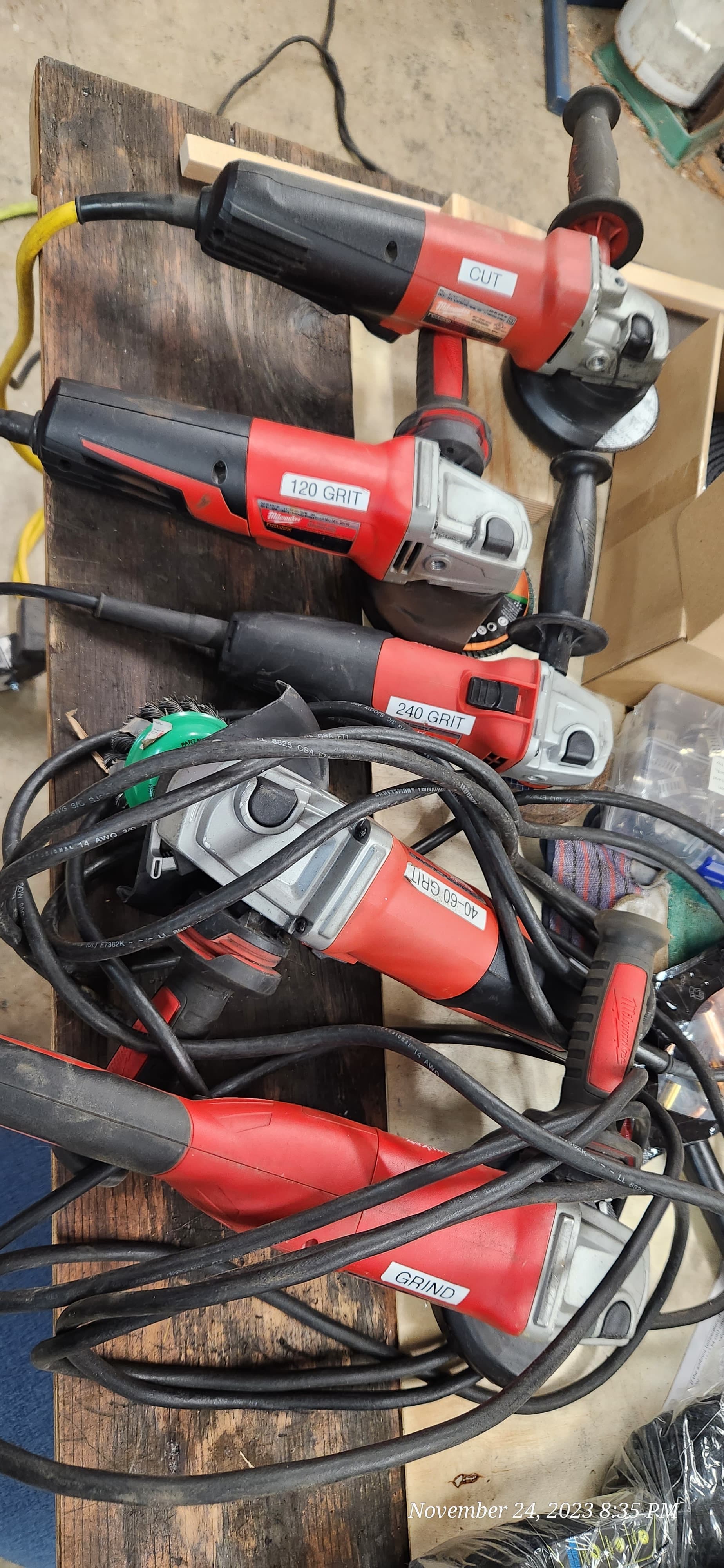

The die grinder, depends on the type of attachment device. I have six angle grinders each with something different on them: flapper discs 60 grit, 120 grit and 240 grit, wire wheel or cup, grinding/cutting abrasive disc and a cutting disc. Plus I have the FireBall slag removal tool that BigDaddy insisted I buy. :rofl:

Do you find the wire cup/wheel good for mild steel or stainless dross? The maroon rolec is great for aluminum but not really hard enough for the mild steel dross (it works, but could be faster). From my tests yesterday, it was actually best to knock off the dross with a file first and then use the die grinder to polish up the edges a bit.

I’m going to the shop in the morning. I will send you pictures of what I use.
The Fireball tool is very heavy. It knocks off dross very effectively.
Corded Milwaukee grinder with 5-inch 36 and 60-grit sanding discs mounted on it.
Several 90° air grinders with 3M Roto discs mounted on them. 60 grit and scotchbrite discs.
A burnishing tool like I showed you.
I rarely use a wire-wheel cup for anything but pre-rust removal. You want to screw up a surface that will take hours to fix. Use one of those.
