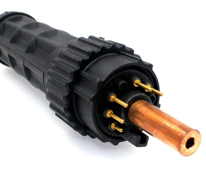

i have learned the machine torch came with only two pins on the machine side connector, these pins are for the pilot arc. (they were inserted in pin location #1 & #9)
i learned the HF needed the pins in the #5 & #6 location so i moved the pins over.
Retried using the torch and i had the same problem so i dug deeper. took apart the machine torch and found it had wires for the “part in place” safety but they weren’t installed on either end of the torch. i jumped on Ebay and found the pins i would need, soldered everything together and reassembled. (new pins were installed into #8 & #9)
IT WORKED! no more F03 trouble code!

I’ll add photos of what I’ve done up to this point in case anyone else can use the info I’ve found out so far.
pins 5 and 6 are pilot arc, the 2 red wires. I am guessing you just made a jumper from pins 8 and 9 for the parts in place/safety. That is all that is needed for the torch to work as long as you have the plasma cutter wired correct for the trigger to the control box. Air pressure need to be set to 70psi for the machine torch to fire correctly.

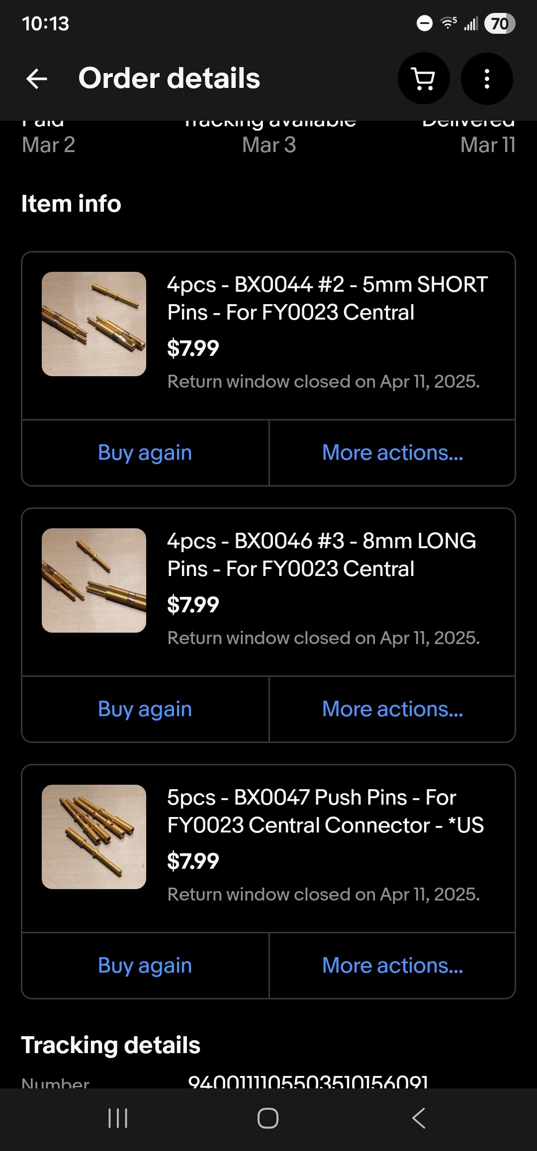

where did you get the pins from? Can you send me a few? I have the same issues
check these out on eBay. Let me know if you need any further help
I found these. I measured the trigger signal pins are 5 mm and the rest are 10mm.
For our purpose, do we have to get the BX0046 #3 and BX0047 Push Pins? In the picture, it looks like BX0046 has one push pin. Confusing..
So the bx0047 get crimped/soldered to the wires on the torch side and then plug into the back side of the connector.
The other pins slide/plug into the front side of the connector and interface with the pins soldered onto the wires in the back side of the connector.
Hopefully that makes sense.

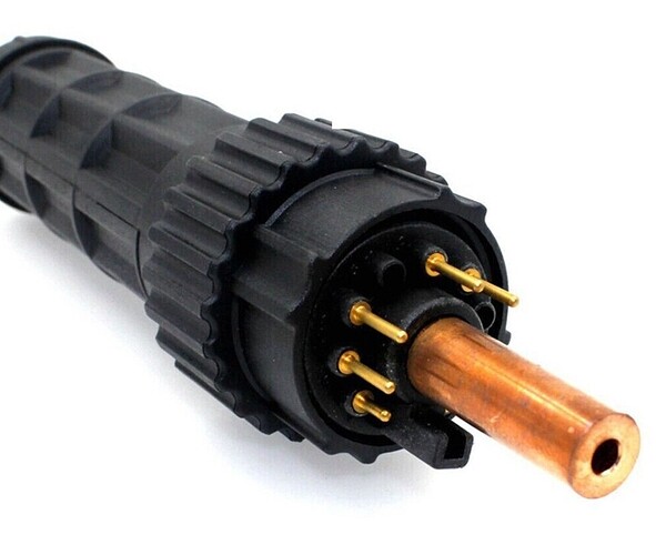

I added a photo I found off Google to show some torches have different length pins. I can’t remember if I used both sizes but I ordered both just in case. Next time I’m with my torch I could send over better pictures and which pins I did use but you definitely will need the pins that go in the back side of the connector as well.
