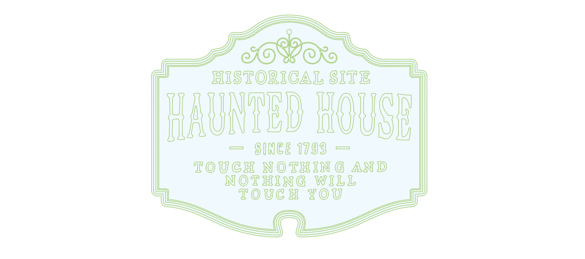

Here’s a DXF of the project for anyone who wants to take a stab at it.
Haunted House 1793.dxf (739.1 KB)
looking at it the smaller font is going to be very tough to stencil at that size. Also the frilly scroll work at the top will likely have to be reduced to a single line stenciled cut. The 16 by 13 size constraint is tough for that smaller font.

I bridged the letters and reduced the scroll work at the top to single lines. The distance between the section was too small to be cut at this scale. I also eliminate all the layers around the border.
The scroll work is single line so a separate tool path needs to be made with Center Compensation.
I also created a back layer that is 1/2" larger that will provide a border and a background color to make the letters stand out.
I think its much more manageable now. I am out of time. I gotta get off here. Maybe you or someone else can go ahead and generate tool paths/gcode.

Haunted House Sign for Daniel - final Version.dxf (683.6 KB)
These settings would work for me, but you…?
Haunetd House Single Line Toolpath - 16 gauge settings.nc (16.4 KB)
Haubted House Sign Main - 16 gauge.nc (265.2 KB)
Haunted House Sign Backgrnd - 16 gauge.nc (9.0 KB)
Amazing Sir thank you I will take a stab at the tool path.
Just so you’re clear, those are .NC files, meaning you can load them into FireControl and run them. If you want to trust the settings, they are ready to cut metal.
