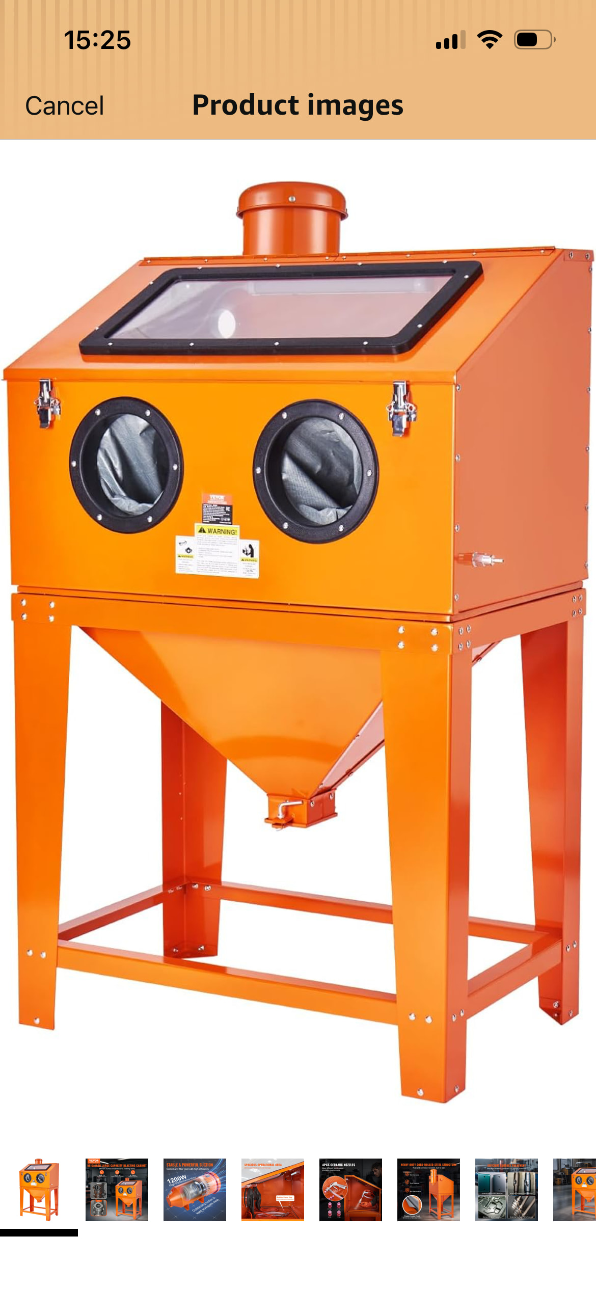

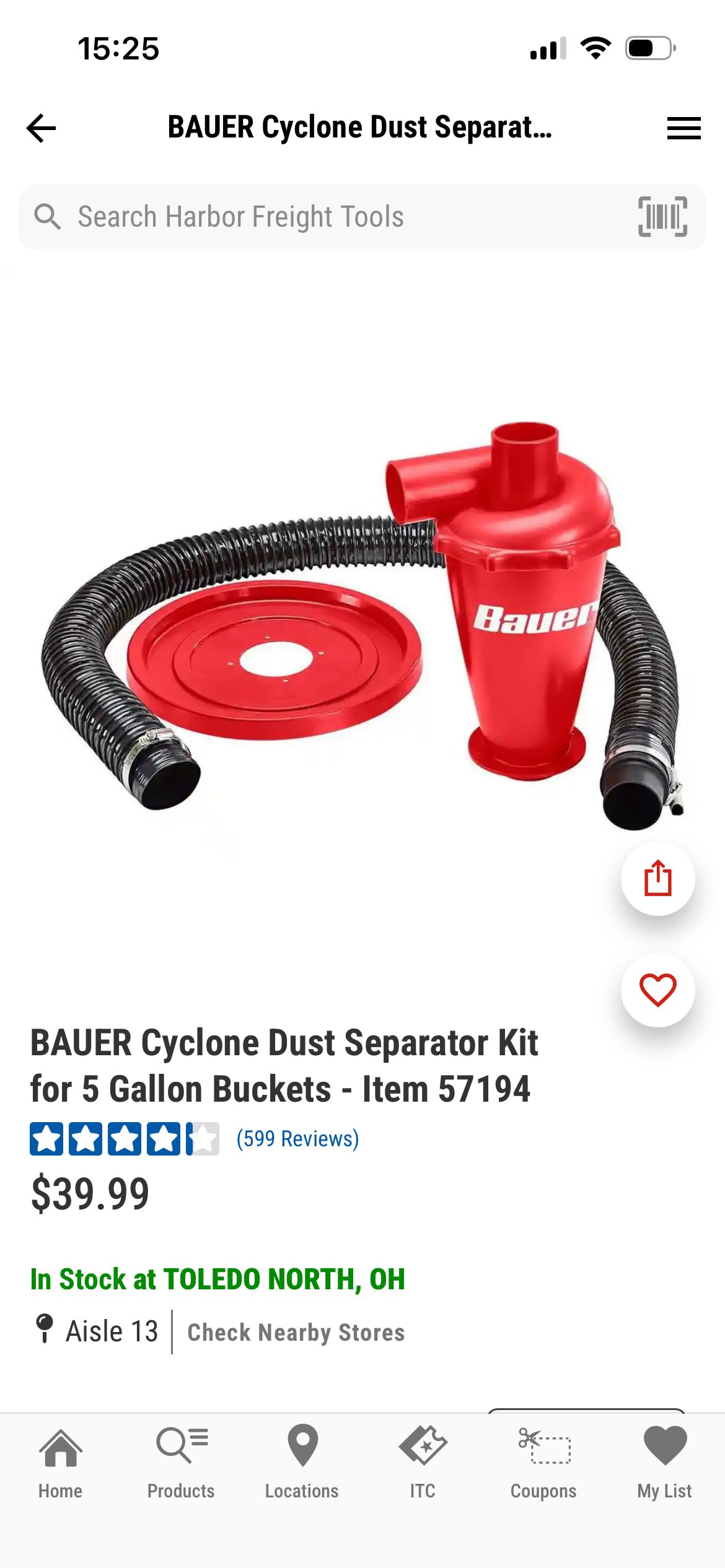

Just wanted to clarify a couple things. From your wording (and I may be misinterpreting it too) it sounds like you’ll have both the orange dust collector, and a shop vac (pulling through the hf separator) hooked up to the cabinet?
Yes I have a orange dust collector that came with my cabinet and then the Harbor Freight dust collector that goes to a 5 gallon bucket
That all has to do with how old the mix is, how strong the mix was and how long you let it soak.
Gotcha. Yeah all you’ll have to do is just modify that collector a little and you’ll be set. I think I may have had to move the latches when I moved the brackets, but all in all, pretty minor job.
