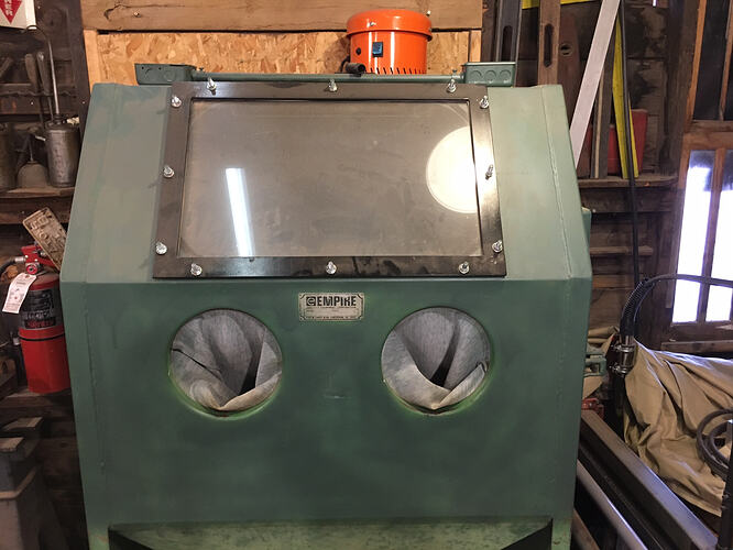

Blast cabinet is an older Empire unit (industrial/professional mfr), this is probably the smallest they’ve made. It’s a suction cabinet, so it relies on the venturi effect to draw media up through the hose. The alternative would be a pressure pot cabinet, and those are typically very expensive, large, and require serious CFM.
For the window, I had a local glass shop cut a piece of 1/8” plate glass (not tempered) and I have some clear window “tint” film on the inside. Replace film as needed when it gets frosted up.

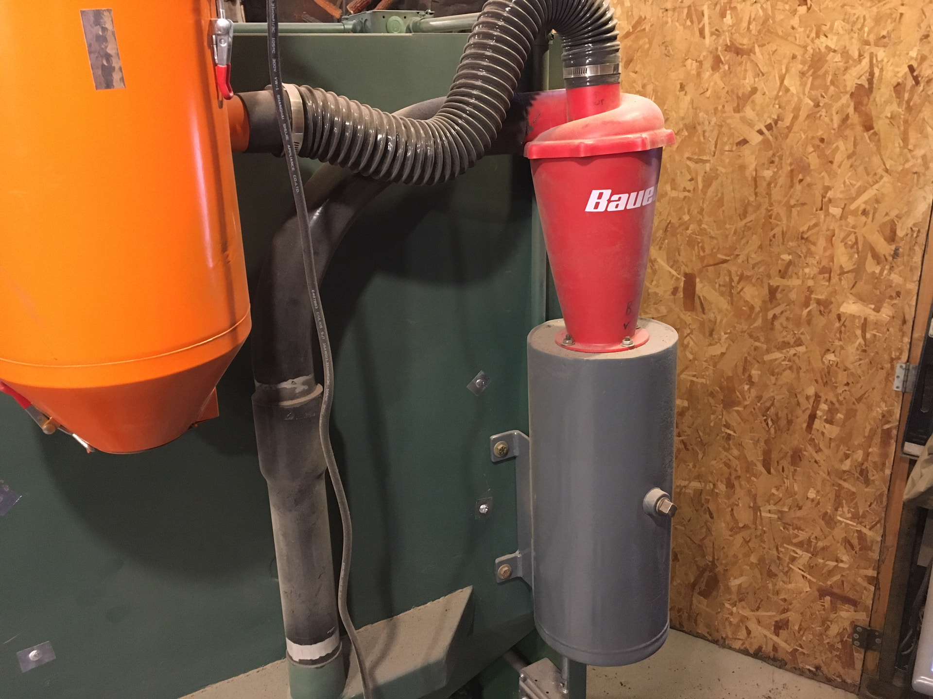

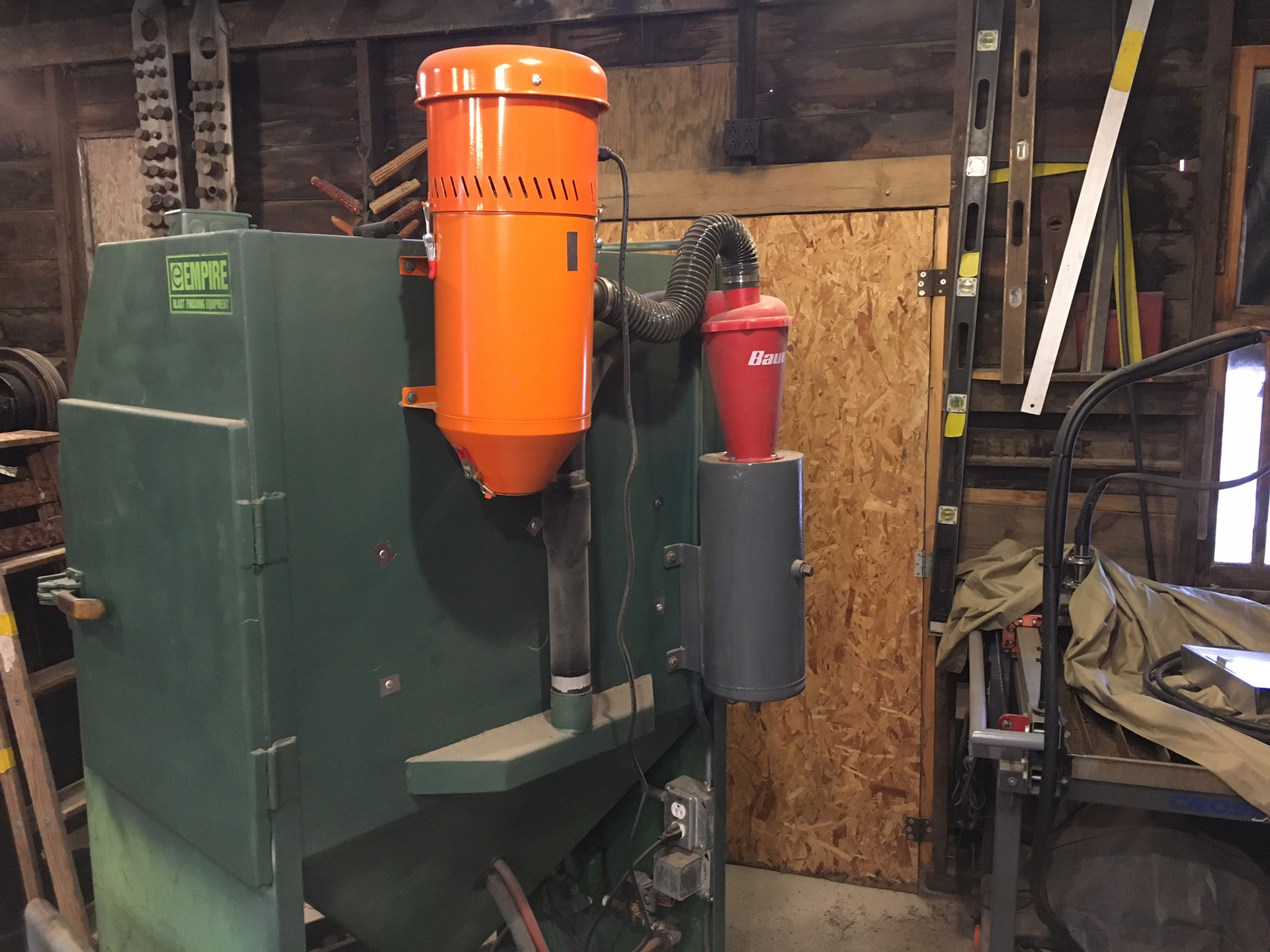

On the backside, you’ll see the orange Vevor dust collector. Originally, it was designed to pipe right into the cabinet, but I didn’t want to continually load it up with dust and media. I cut the brackets off, clocked the unit 90 degrees, and welded them back on. This way, its suction inlet points towards the Bauer separator.
Instead of a five gallon bucket, I have the red Bauer separator mounted onto an old air tank, that holds the collected dust/fines/etc. Empty that out the bottom periodically. Basically I keep using that coal slag media until it all pulverizes itself into powder. The separator collects all that powder, so I’m always blasting with good media.
Used a PVC conduit sweep and a straight piece to make a smoother connection from the cabinet, and then used some of the included flex hose to make the connection from the separator to the collector. Painted the PVC to reduce the static cling it always seems to have. You could use all flex hose, but I figured I’d maximize efficiency.
Inside the cabinet, there’s a baffle covering a long rectangular slot. That slot feeds into the protrusion you see on the back of the cabinet, which connects up to the conduit. From there, it goes into the separator, and then to the collector. The collector really doesn’t see any dust, but has an air filter element in it to catch any miniscule particles.
Fresh air comes in the top of the cabinet, through a chute that brings the air down over the glass. This helps keep dust clear from view, and also helps repel media from hitting the glass. The dust collector is pulling a vacuum on the cabinet, so replacement air has to come from somewhere.
Clean, dry air is pretty important, but I don’t run a refrigerator-dryer or anything past a basic centrifugal water separator/filter/regulator unit. I have a latching foot pedal from harbor freight, connected to an air solenoid. This way, all I do is tap the foot pedal on, resume normal posture, and then tap the pedal off when I’m done. Don’t bother with a trigger gun at all. Your hands will cramp up quickly, between the stiff gloves and hose. If you get a unit with a trigger, just ziptie it or bypass it, and go the solenoid/foot pedal route.
This setup all together works incredibly well, and the only other addition it needs is a finer mesh screen inside the cabinet to catch rust flakes/paint/etc so it doesn’t clog up the media suction hose.
I’ve used blasting systems from the cheapest $20 TSC hand guns, all the way up to industrial sized pressure pot cabinets. Yes, a pressure pot system is nice, but I’d say that what I have is at least 80% as good, which is plenty considering the cost and complexity difference.
