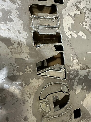

Hi I’m cutting 16g steel with my Everlast 62i with a ptm60 machine torch using .8mm tips
Cut height .063 in
Pierce height .15 in
Pierce delay .5s
110 ipm @ 30 amps
I had some beautiful cuts before this I’m not sure what is happening
could it be the torch height control? ground issue? my piece is warped to all hell now for trying to go over it again

Suppose the work clamp is on the metal. Then, pull the consumables out and look to replace the electrode and tip. Make sure you don’t have Chinese Amazon crap that you are installing. Give that a try.
Just one or two no pierces will destroy a tip in seconds. This is assuming that your cut height is correct @ .060.
The green color is the copper in the electrode burning, because the hafnium core is gone. Copper doesn’t make a very effective cutting plasma stream. What you get is what you see in your picture, with the top surface gouged and not cut through.

Your consumables may be new but there are a few things that can significantly reduce consumable life.
Air quality: you need an ample supply of clean dry air. If you are still running with only the coalescing filter you will likely burn through consumables pretty fast. At minimum, depending on your climate add a quart sized desiccant filter and a motorguard filter.
Consumable quality: the cheap ones won’t last long and won’t cut as well.
Cut height: if you haven’t already you need to verify your actual cut height matches your programmed cut height. You can program a straight cut and pause it after the IHS cycle… or there are a couple of programs available on the forum that do it without firing the torch.
Post flow: the time the air blows after the cut is done. This should be 30 seconds min. It is a setting on the plasma cutter itself. If the hafnium isn’t cooled between cuts it will blow out and you will be left with only copper as David said.

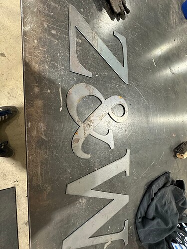

here’s the pics of my consumables, and a pic of the cuts I did right before (from a different sheet if that matters) and my ground, could my ground be too corroded?

so what I see here is a worn out tip…the hole does not look smooth and even…it looks pitted…which makes the arc messy.
the electrode does not look to bad…how many pierces and time do you have on the electrode and tip?

The swirl marks around the electrode are signs of extremely high dew point. Water in your air. That is a major reason for the nozzles failing so quickly.
We see these threads pop up each summer.
Anyone who starts in the winter without an air drying and cooling system doesn’t notice problems until ambient temps rise.
