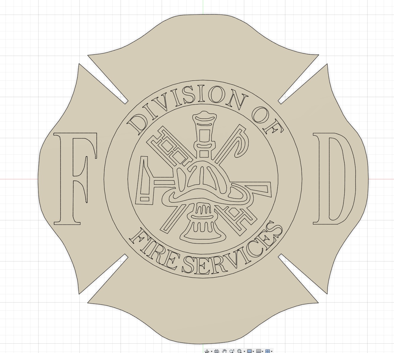

I am working on a large maltese cross project for my mancave and need some help. The cross body is about 45" in diameter, and the center crest and all the lettering will be mounted to some form of standoffs so that it hovers above the cross base. The finished project will have three total layers, with each layer hovering an inch or more above the one below to give it depth. My initial thought is to have 1/8 indexing holes that pass through the letters and the layers below. This will help ensure the letters and crest are indexed properly. My question is about how to attach the lettering to the layer below. With the 1/8 holes, and using some type of standoff spacer, I would think I may still have some movement in the lettering unless I use self-centering screws like a shoulder screw or countersunk. Ideally, I would like to have no visible screws, but not a deal breaker. Any thoughts or ideas on the best way to go about this? The pic below is the project in Fusion 360. I will probably use 16-gauge steel for this and cut on a Crossfire Pro.

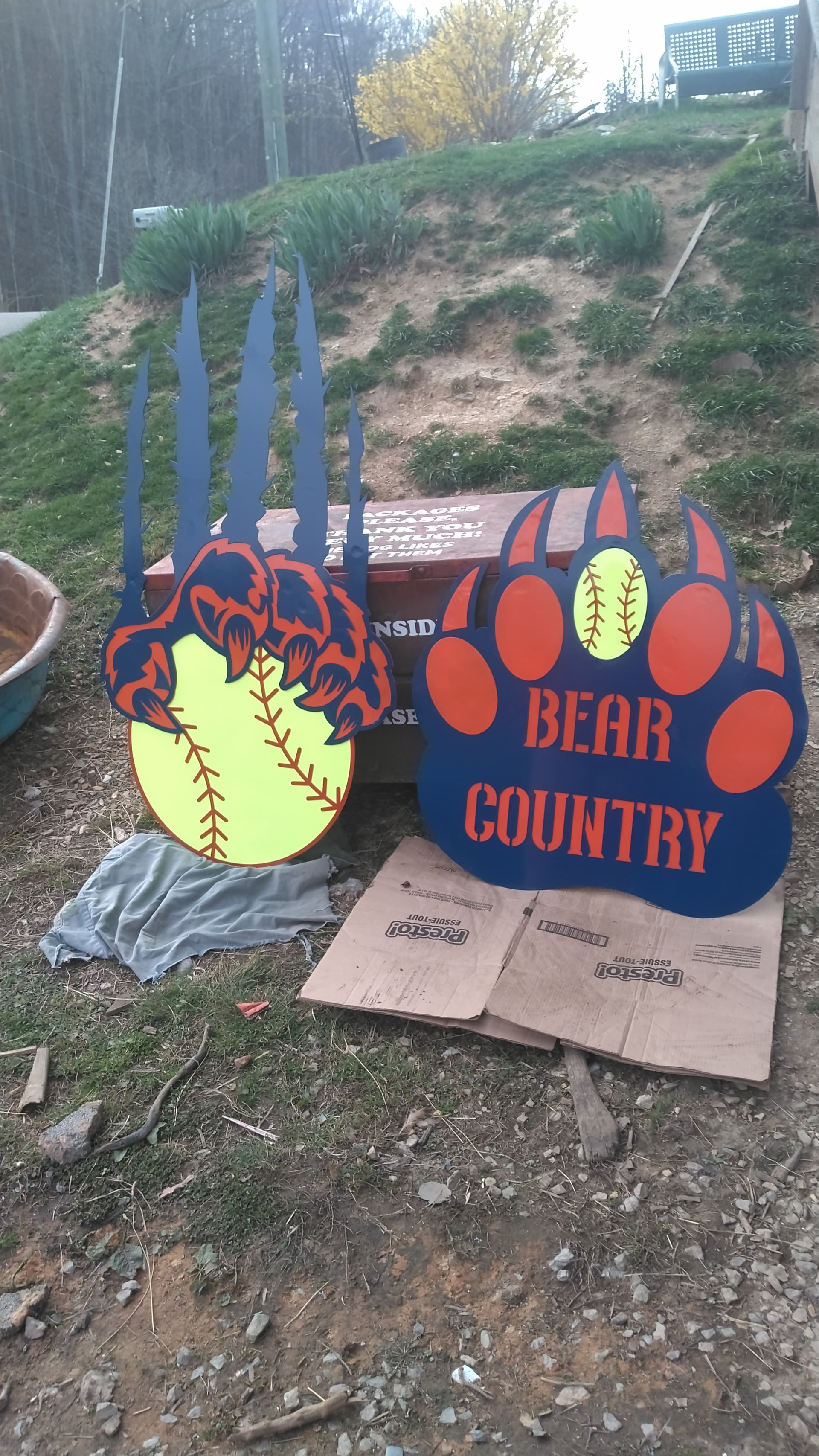

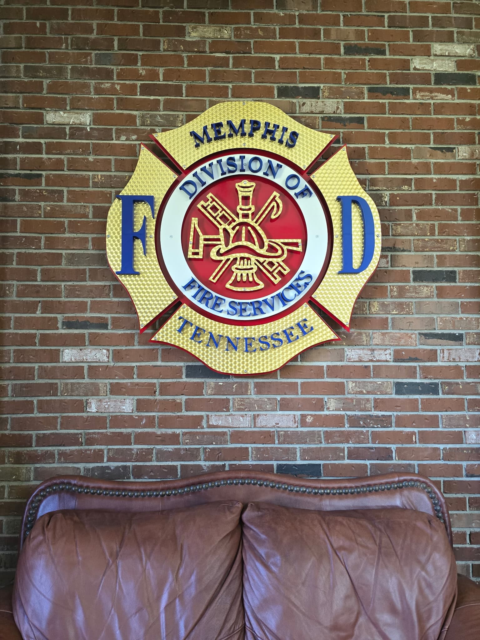

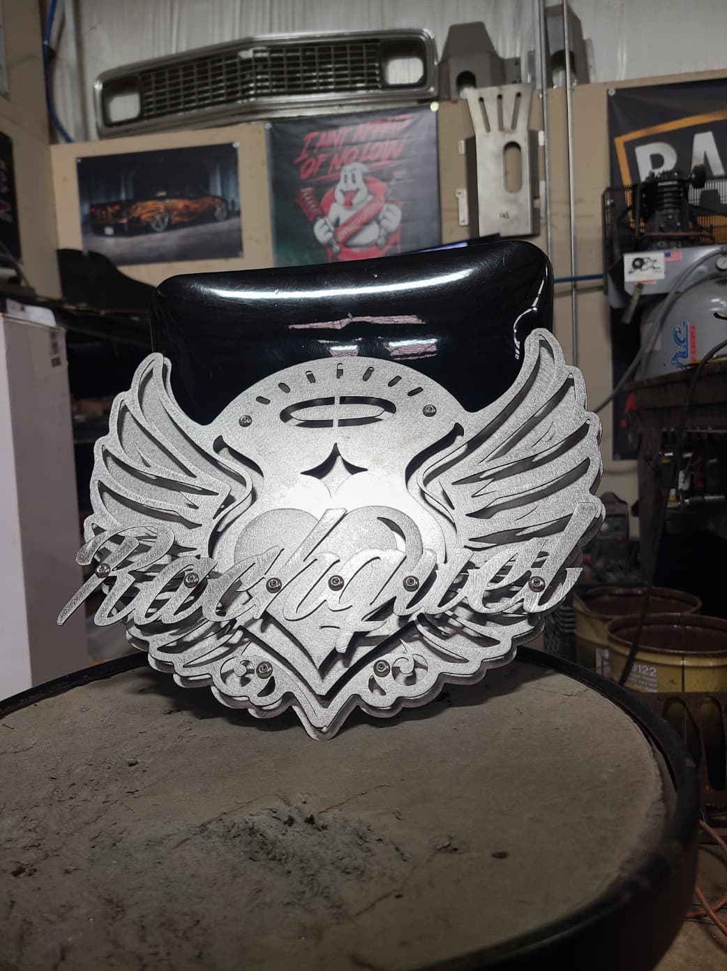

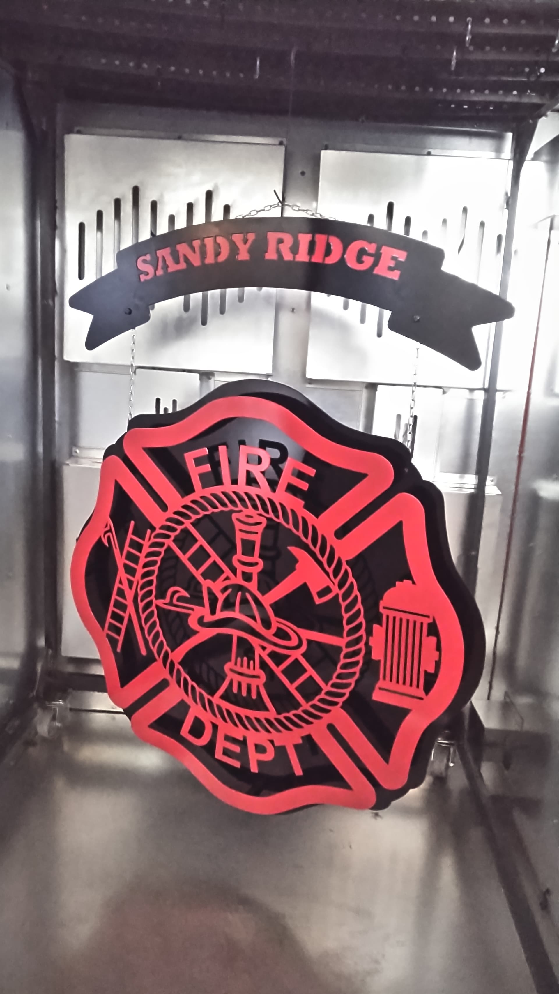

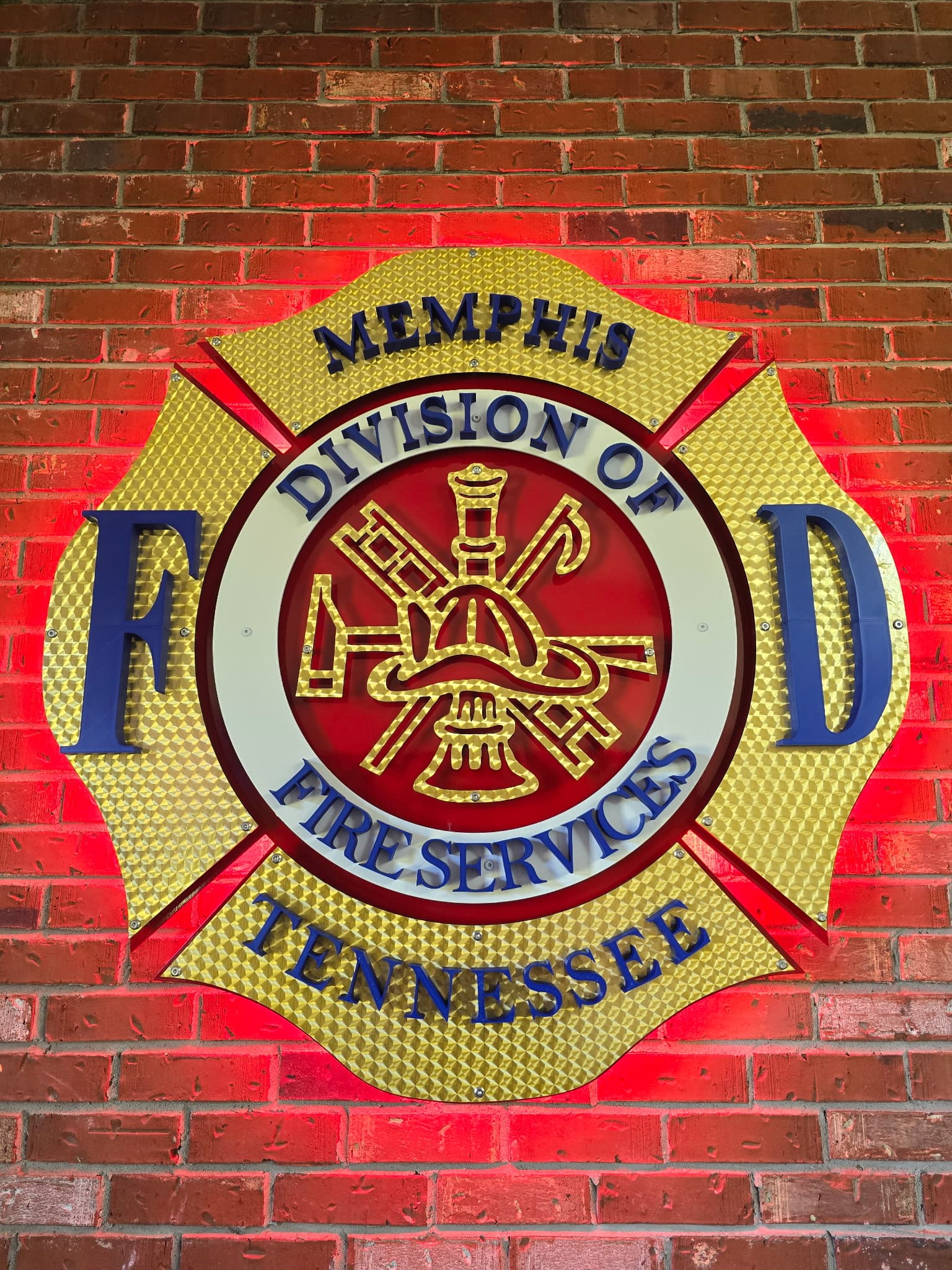

Here is one I did for the local firehouse it doesn’t have multiple layers though. I will include a picture as well of a project that does have several layer it just doesn’t have stand offs.

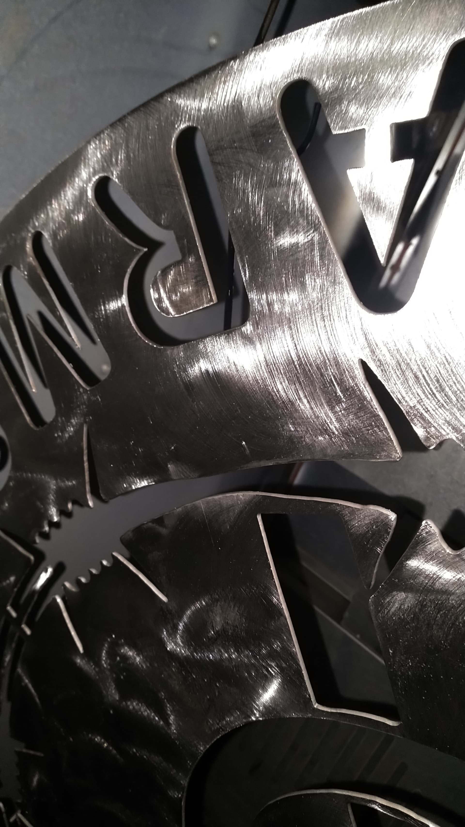

I add the holes I want to the drawing and just do a separate operation with each piece including the holes. That gives your alignment. I run the all thread all the way through. I tig weld to the front then sand down. I tig weld will generally give me full penetration so I can smooth the front…
Then I don’t weld the pipe in I use it to hide the all thread …
Give me just a few and I will update some more pictures that will give better details.
Need better pictures? I have a project ready to assemble I can grab a few pictures this afternoon…

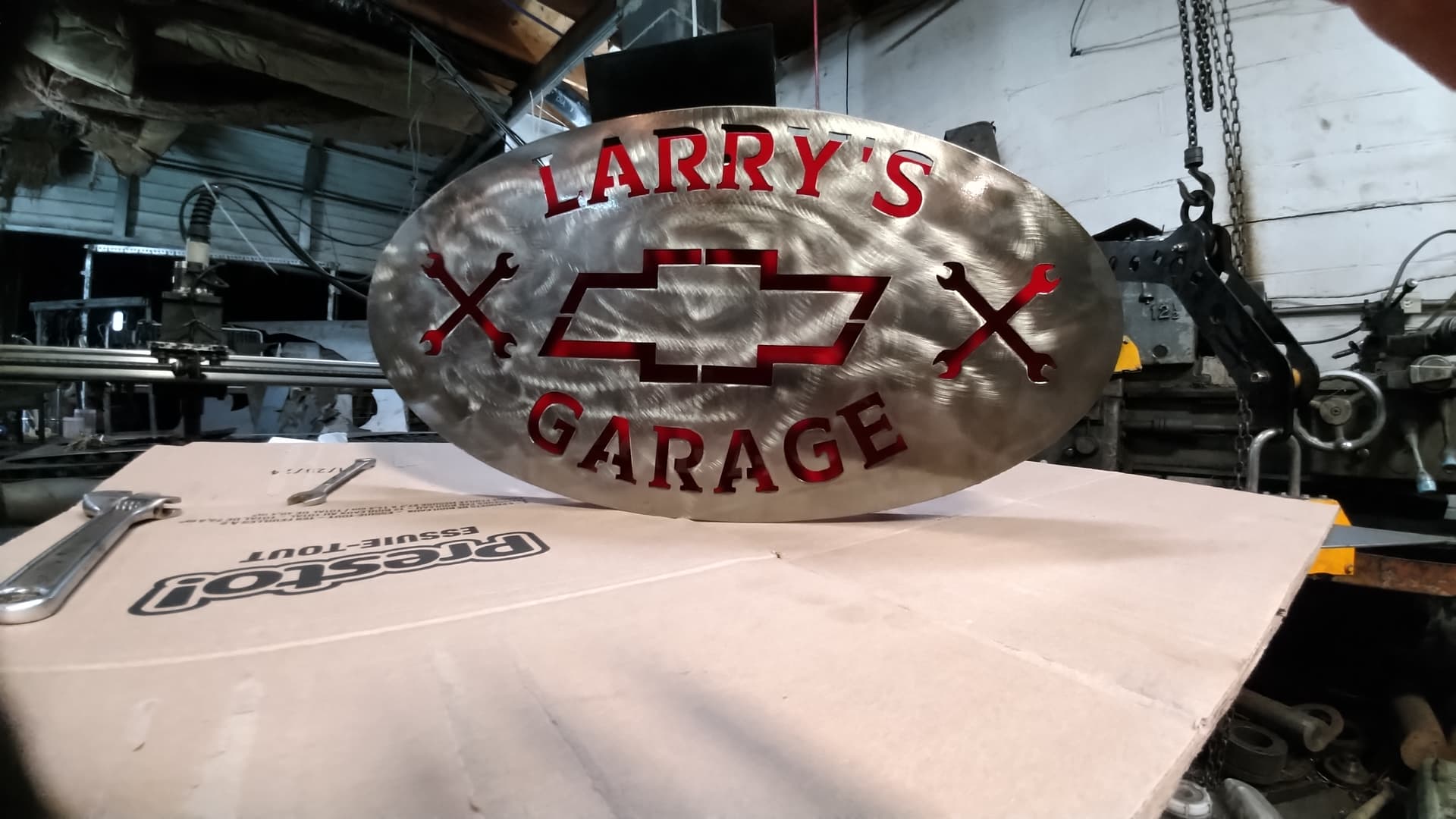

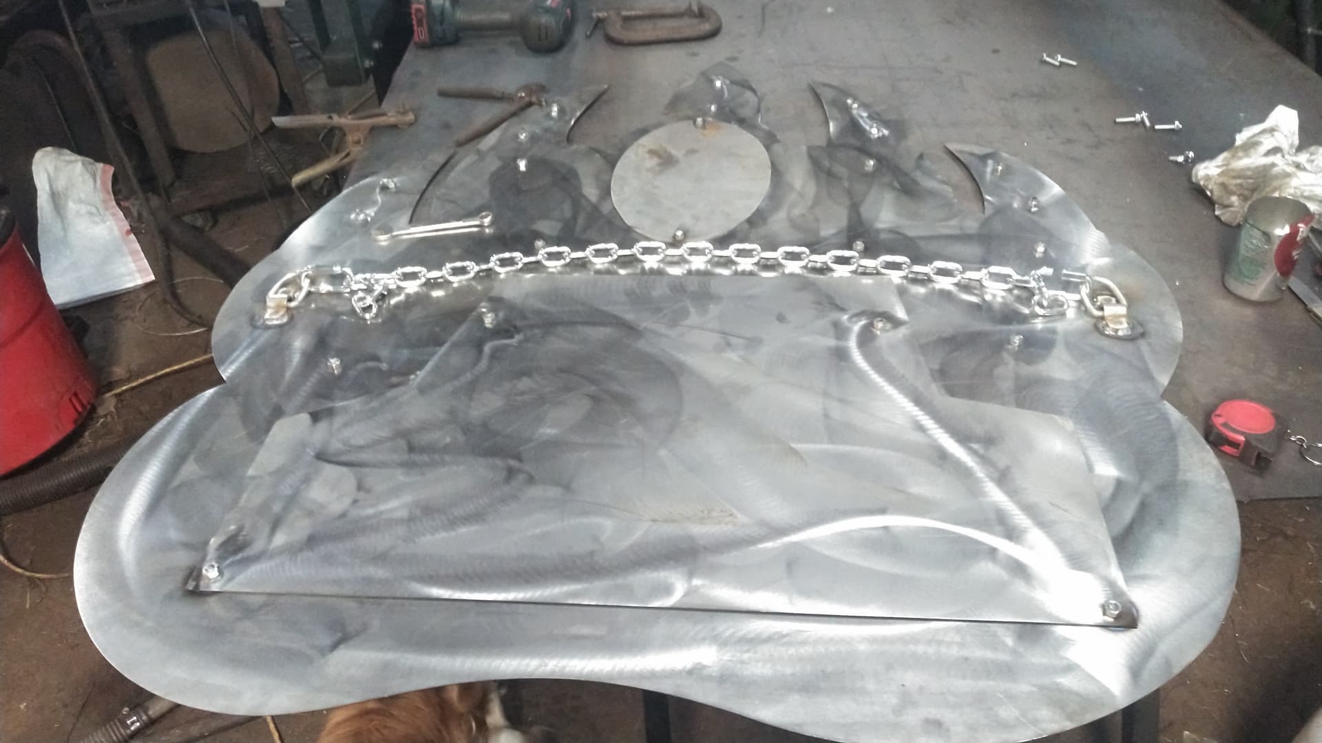

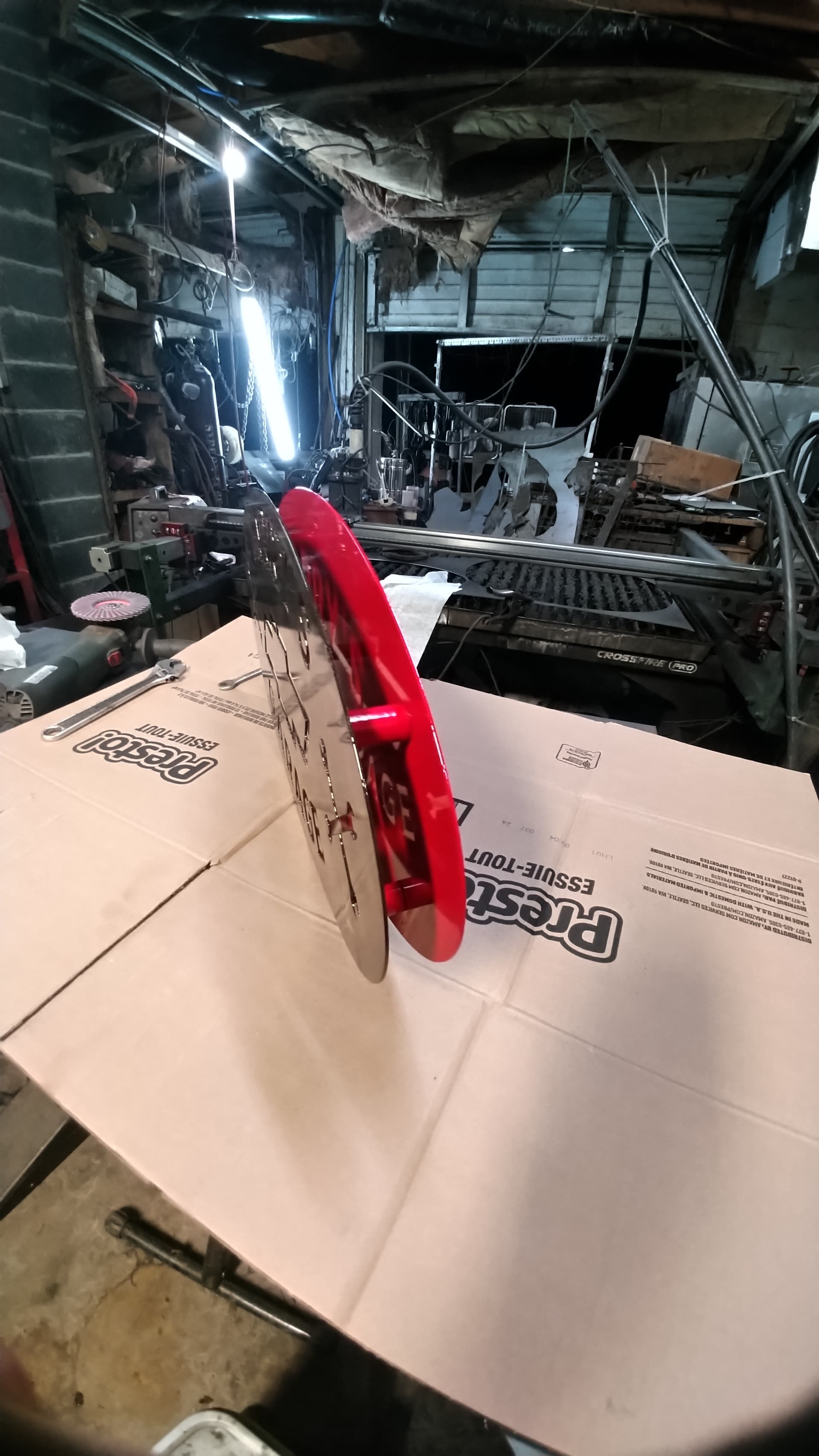

There are several ways to skin a cat. This is the way I do it

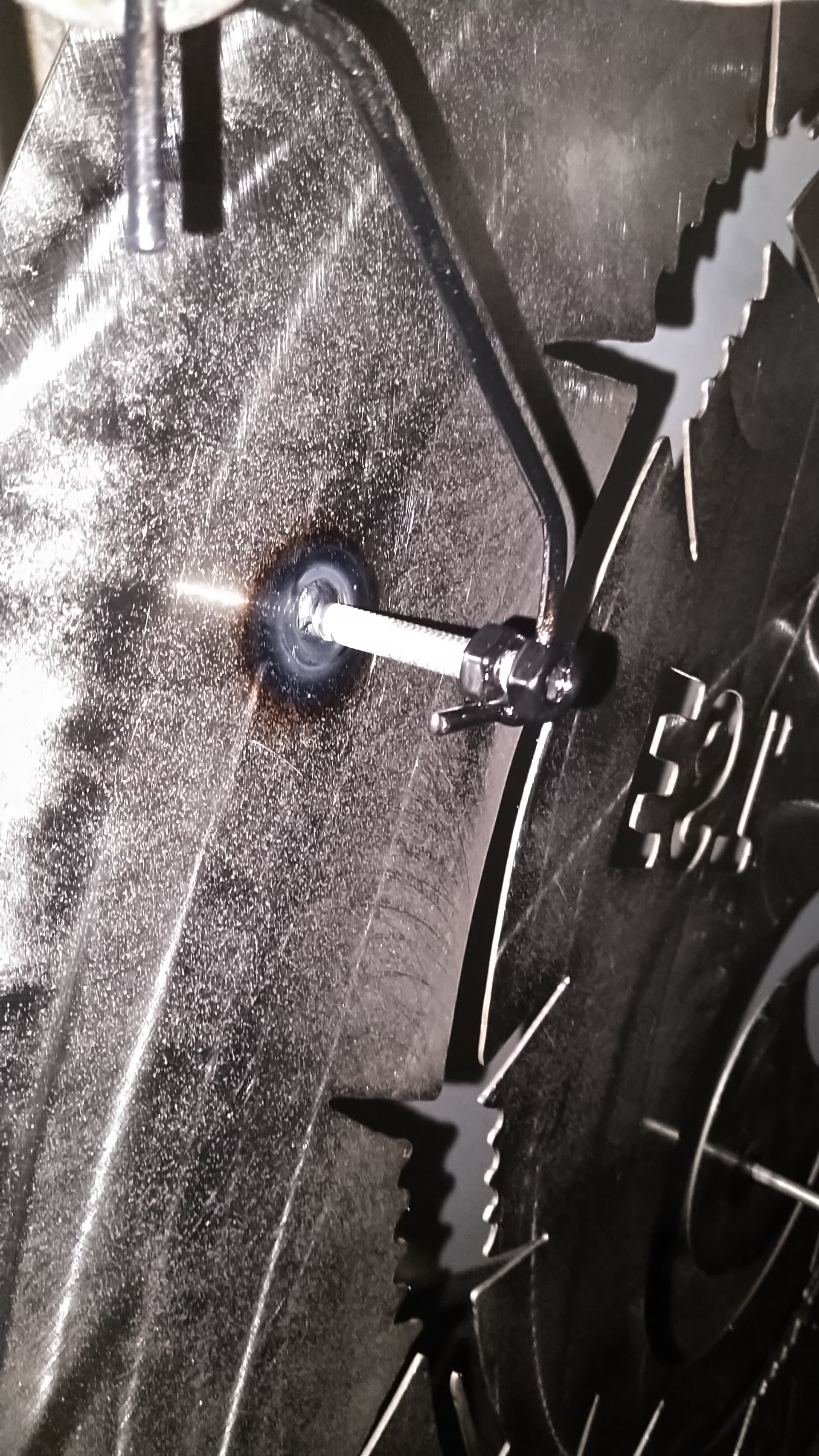

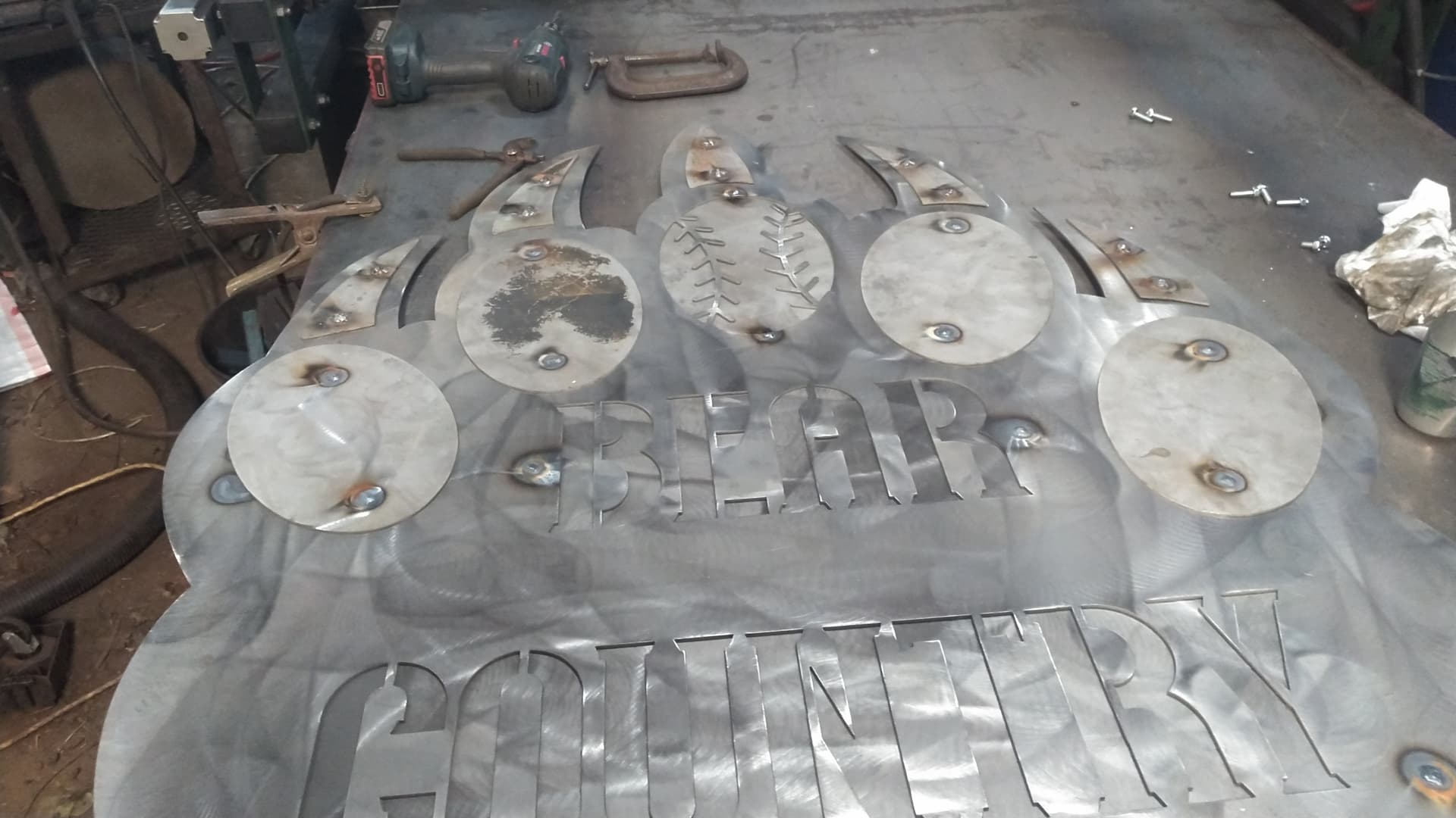

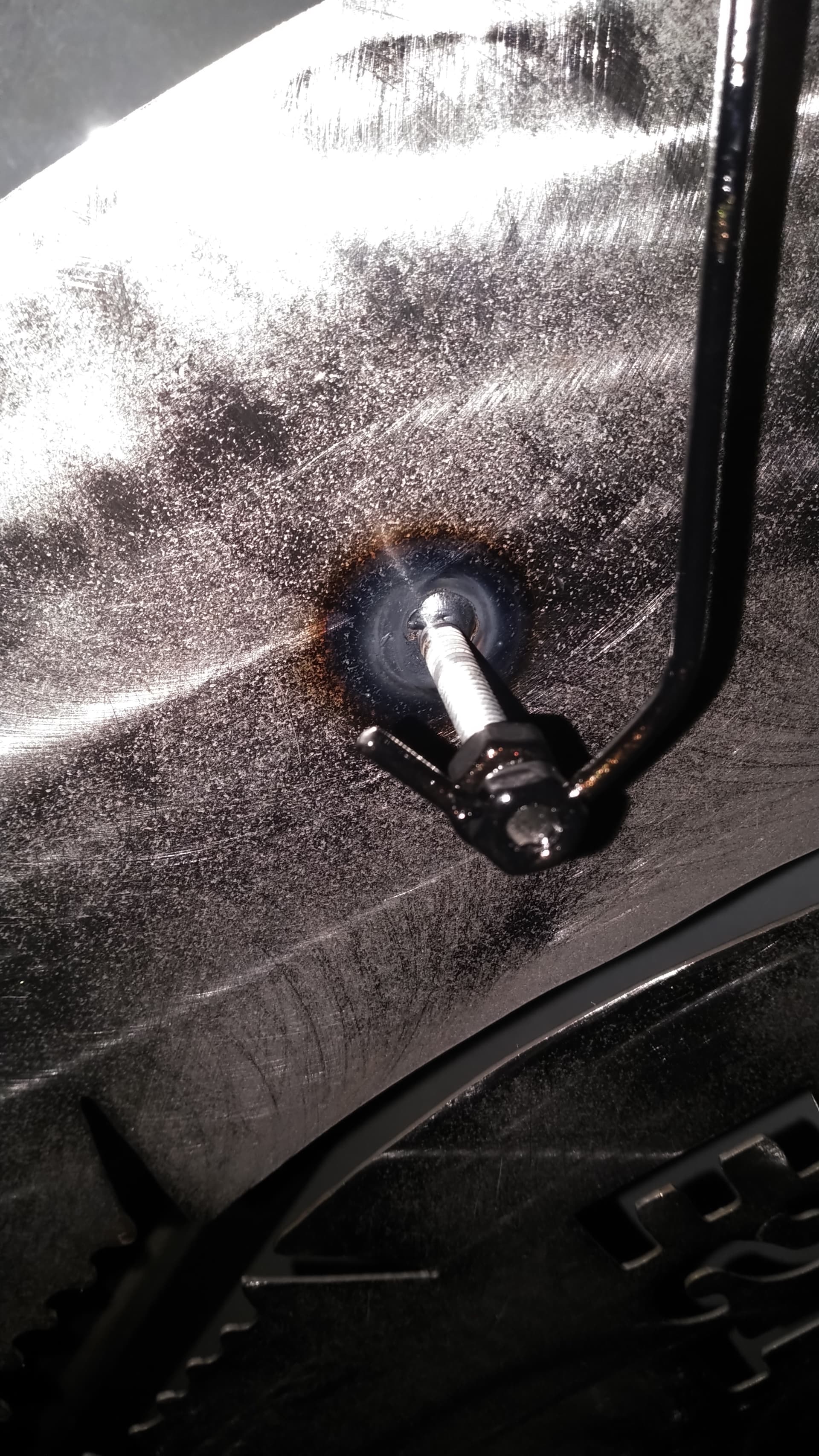

@RETFF here is some pictures I snapped today. The stud is just below the R in the one picture. You can see the weld has good penetration around the stud.
I usually have all thread sticking up about 1/4 . I fire up and flow it into a button making sure it fuses with the face of the sign . Home these pictures gives you some more insight.
