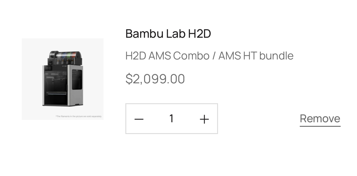

H2D AMS Combo/AMS HT Bundle is in the shopping cart. $2099.00 with free shipping seems pretty decent.
:backhand_index_pointing_up:
Should I get the vision encoder system? I’ve heard it makes no discernible difference…
