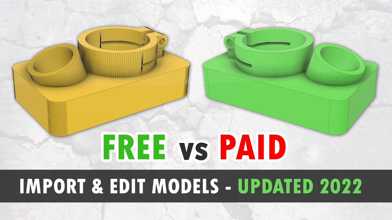

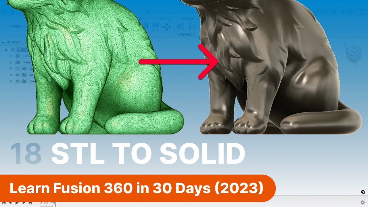

That is why I provided the links to those two videos. They go thru all the steps.
