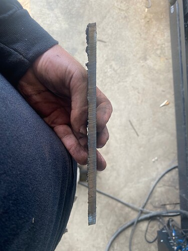

Help adjusting tension bearings to get square cuts
Hello . I have mainly been cutting thin materials (16ga) and never noticed it had a slight bevel until cutting 1/4” and 3/16”. Re watched the tutorial on how to make adjustments loosened everything up and started over. Still can’t figure it out. Tightening the top adjustment kicks the bottom out but I need it to kick the top out more. Any tips are welcome thank you .
Those bearings that you tightened to make it tilt back are the same ones you use to tilt it forward.
Loosen the bolts on the bearings and then back out the set screws until the Torch is square
