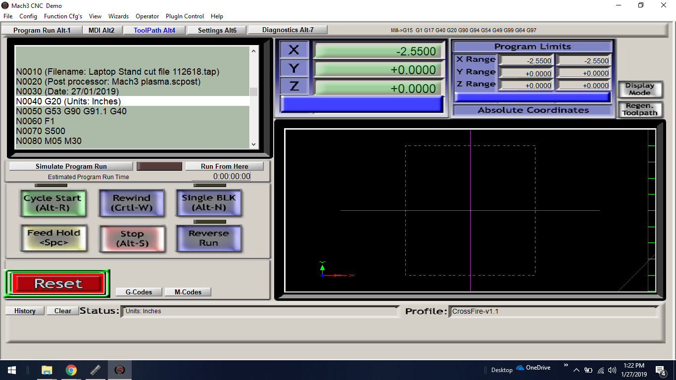

Just trying to get familiar with software. When I load a file n to Mach 3, this is what I see on the screen. What am I doing wrong. Thanks for the help.
Try clicking program run. to the left of the highlighted tool path , top left and see what that does.
I think I stumbled in to the solution. G code now loaded and running! Stopped at a point N 5000 M03. Does that suggest I am over the allowable 500 lines in the trial and need to purchase the full licensce (something I am going to do anyway)? Thanks for any help.
You are correct. 500 line max for demo. The code jumps by 10 for each line.
