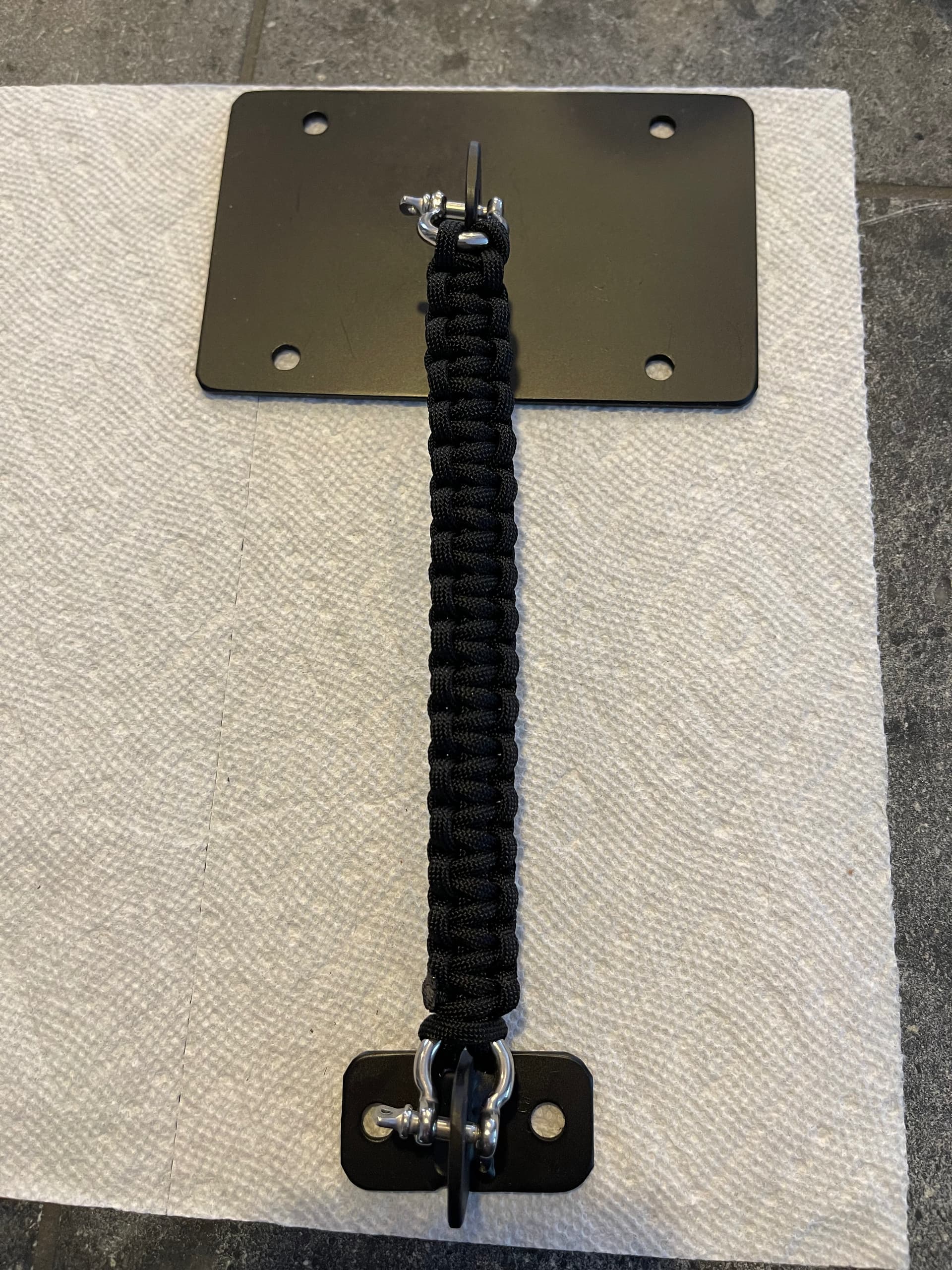

(Here are the JK tailgate checks I make. Simple solution to a poorly designed OEM check that breaks as soon as you put a larger spare on the tailgate)
Like I tell my wife when she cooks something I really like: "You could make this and sell it and people would eat it!!!.
David, You could make those brackets and people would buy them and use them. They look like they are out of a factory!
I sold $4000 worth of them last year. I’m over $2000 already this year. I’m the only source in the world for those particular parts right now
