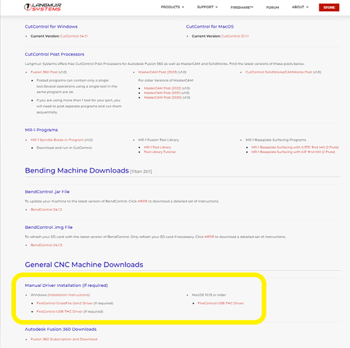

Install the driver from the downloads section of the Langmuir website. It says it’s for older Windows versions, but it’s the correct one. I know the instructions say the driver will be automatically loaded, but most of the time that is not the case
It’s near the bottom of the downloads page and it’s listed as Crossfire USB THC driver.
