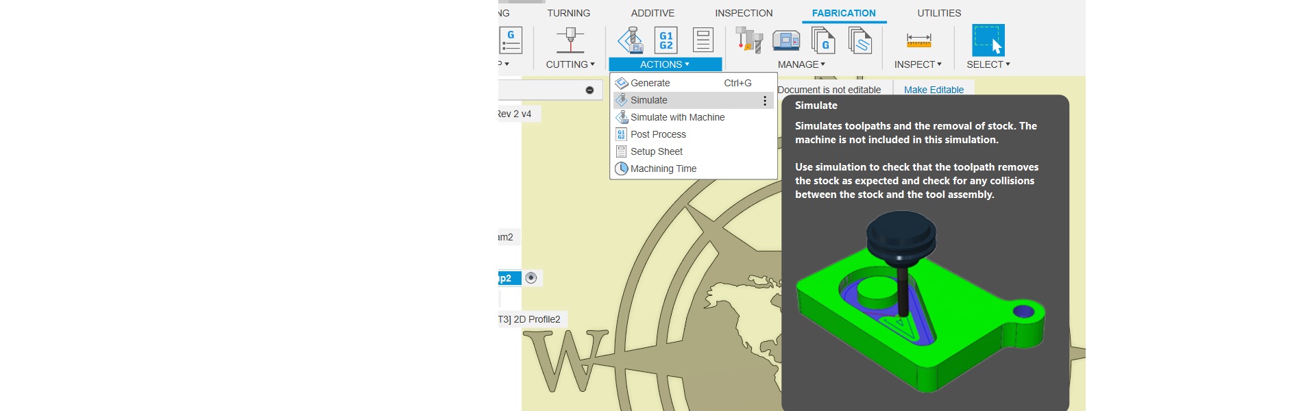

Did you try the Simulation in the Manufacture section of Fusion 360? That is the easiest way for you yourself to see if what’s happening on the machine is programmed to only cut those sections. You don’t need any knowledge of the G-Code.
