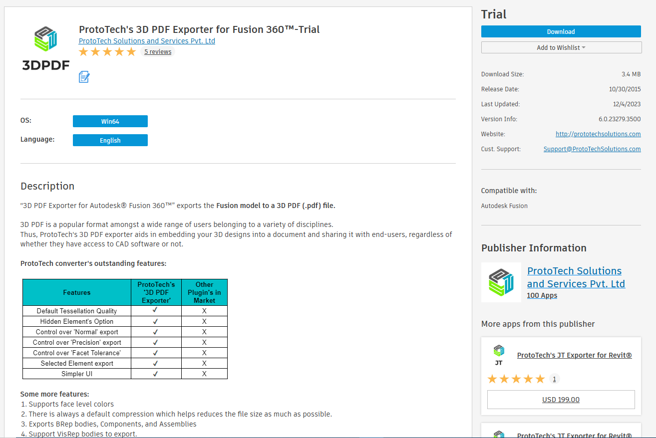

I see in Autodesk Add-on page, there is a program that was updated Dec. 2023 that says it can generate a pdf file for Fusion 360. It has a trial version and then it is $49.
I did not try it as my hard drive is already too crowded. Here is more information:
