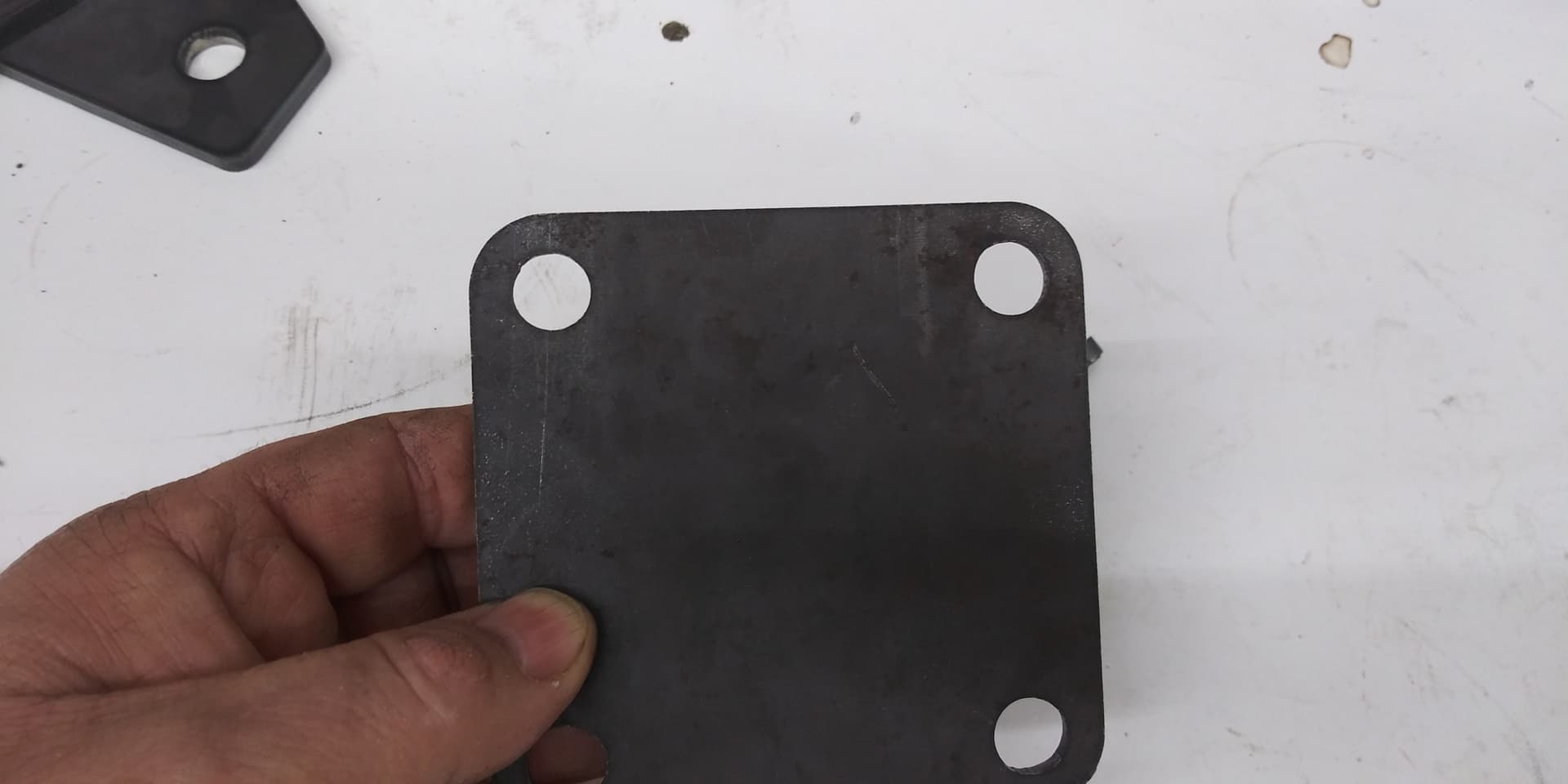

Post a pic of a cut part, so people can see if your getting the normal amount of dross.

If you want to save time, then tweak settings until there is no dross.
1/4" no dross because I tweaked one setting at a time until I got these results, lots of tweaking on scrap. Got to put effort into plasma cutting to get great results, every machine will be a little different.
First pic was cut on my pro table with titanium 45 w/machine torch.
second pic was first test cut on my XR with Hypertherm powermax 45 xp.
