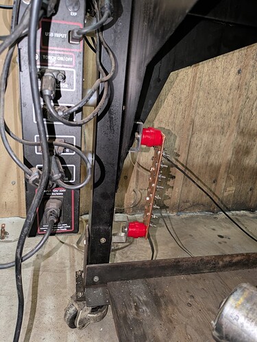

I can testify to the efficacy of @Bigdaddy2166 's grounding suggestions.
I recently replaced an ancient laptop (“Pentium inside”!) with a mini PC. The mini PC is much faster and runs firecontrol much better, but I’ve been having an intermittent “machine disconnected” message. The mini PC is a 2 prong power supply so I thought it would behave like the laptop. I always ran the laptop plugged in to AC since the battery was dead and never had an issue.
I didn’t go quite as thorough with the grounding, but I did do braid to each motor, the table, and the 8’ ground rod to a common ground bar. I ran an extra 8’ of braid to the ground rod so I can still roll the table around for big index cuts.
I just finished a 10 minute program with loads of pierces and some fairly long straight runs with zero issues. Previously nearly every project, no matter how small, would have at least one failure.
While I was messing around in the area I added some 1" plastic standoffs to the control box, and a plastic splash shield for the control box.
Awesome that your issues are gone .
USB port looks to be bent over and touching the housing too. semi-common issue.
Thanks Tin. I gave it a little screwdriver tweak based on your observation.
