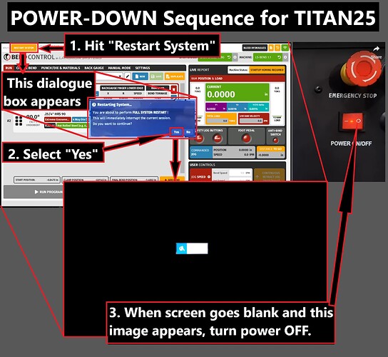

There needs to be a proper shutdown procedure required due to how Linux operating system works. Shutting down the machine without shutting down the onboard computer first might cause SD card corruption issues. So there should be an button on the interface to shutdown the onboard computer first before killing the main power.

@holla2040
He has figured this out along with some other stuff. Posted it here in the first bends thread
Here is the summary sheet for the shut-down procedure (as described in Craig’s video):
Craig’s video (and others) of this and other things can be found here:
Thank you for pointing that out. However, I am already aware of that procedure and sadly, it is not more than a band-aid solution and it is not fool-proof.
You can also shutdown the system by swiping up with 5 fingers to up and minimize the bendcontrol to reveal the taskbar to shutdown.
What it is needed is to dedicated button shutdown the system.

swiping method is much safer.
