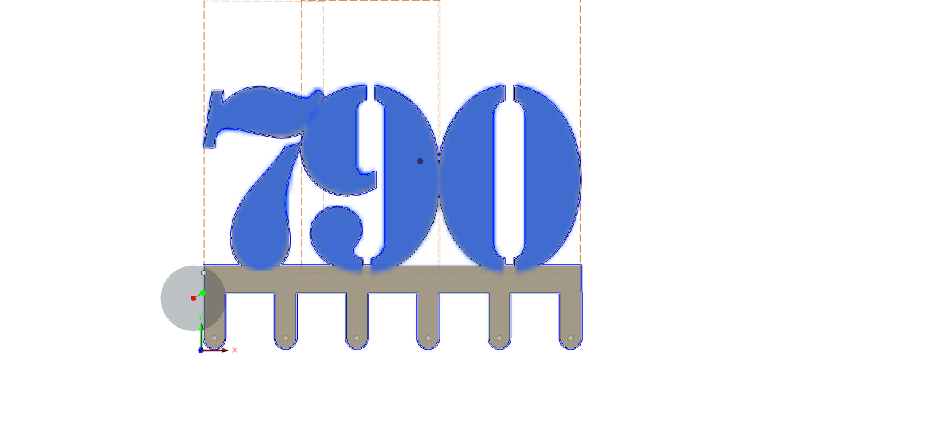

I am trying to cut a sign and when I create the cam process it simulates a good path but after posting it is a incomplete G code
Your probably still using the demo version and you part is more then 500 lines of code
It is not more than 500 lines of code
Can you post a picture of the CAM simulation?
I can after further investigation I believe oneupperformance is correct about to many lines of code
oneupperformance after further investigation I believe your correct about there being more than 500 line codes

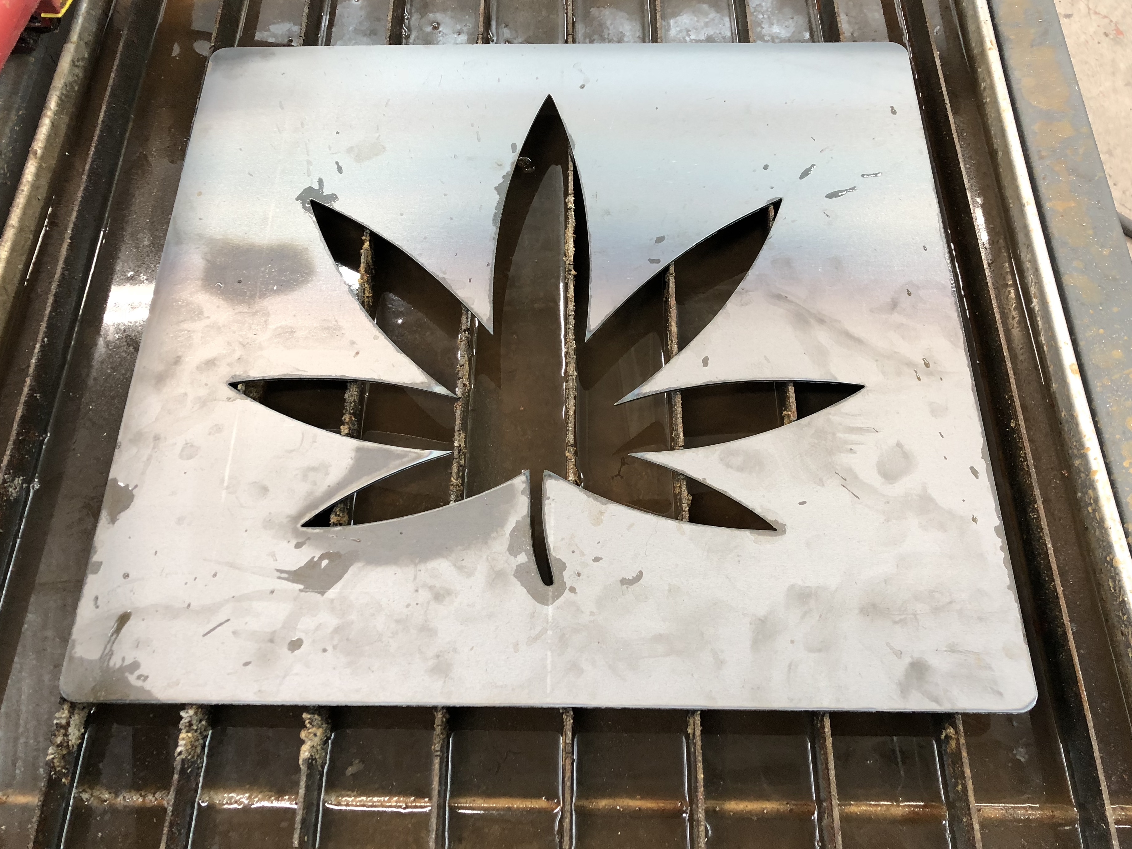

I figured. Even though it may just be a small design, it can be a lot of code. For instance, this is a 16” x 16” piece and was 1000 lines of code and it’s just one design.
