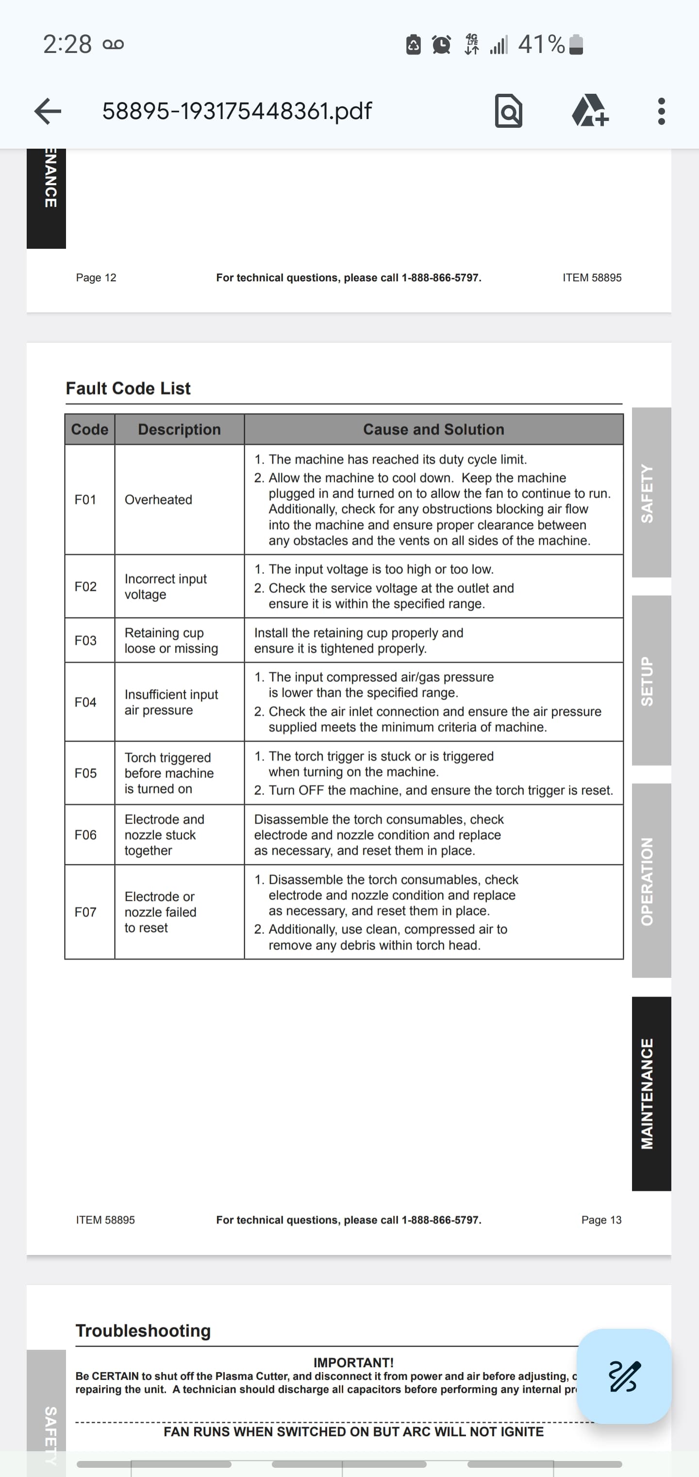

I bought the crossfire pro as a hobby garage / side hustle…. But I have only cut ONE file I got off fire share because it is one single small cut a THUNDERBOLT I don’t know why I keep getting error code F07 on my titanium 65 I’ve rewired checked and replaced consumables!!! It will only cut a single drop line not multiple up and down or pause and cut not sure if I’m explaining correctly…… but I am very frustrated… let not even get started on my cad skills :weary::weary::weary:I feel like I bit off more than I can chew and made a $5,500 investment foolishly…

Based on the error here in the manual, it seems to be related to the consumables, which is why I ask about the need to rewire anything?
What are your settings for these cuts? Too long of a pierce delay, too low of a pierce cut, etc can all easily damage an electrode which would warrant replacing just as the error code suggests.

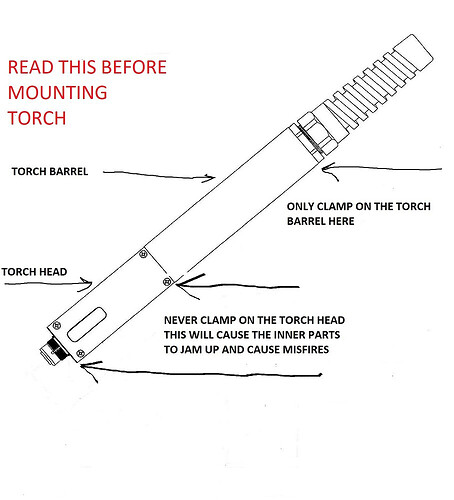

That is sounding like maybe the torch is clamped wrong? Hand torch or machine torch?

Yes sorry was frustrated and late night post… after first contour cut and it touches back down for the second it makes a popping noise and does not fire and throws the code……
If it fires the first time, the spring isn’t stuck.
What is your air pressure when the air is flowing?
If there isn’t enough air pressure, it won’t blow back the electrode to initiate the arc.

You may also need a longer pierce delay (.6). Most common failure of second cut in the same program is too short a pierce delay.

It’s the one the machine came with, how would it be clamped wrong? I don’t tighten too tight not sure how high or low the l bracket is really supposed to be!?

It’s about where you place the torch within the clamping jaws. It can restrict movement of the nozzle/electrode if clamped too low.
I have a regular hand torch??? So where would I clamp?
