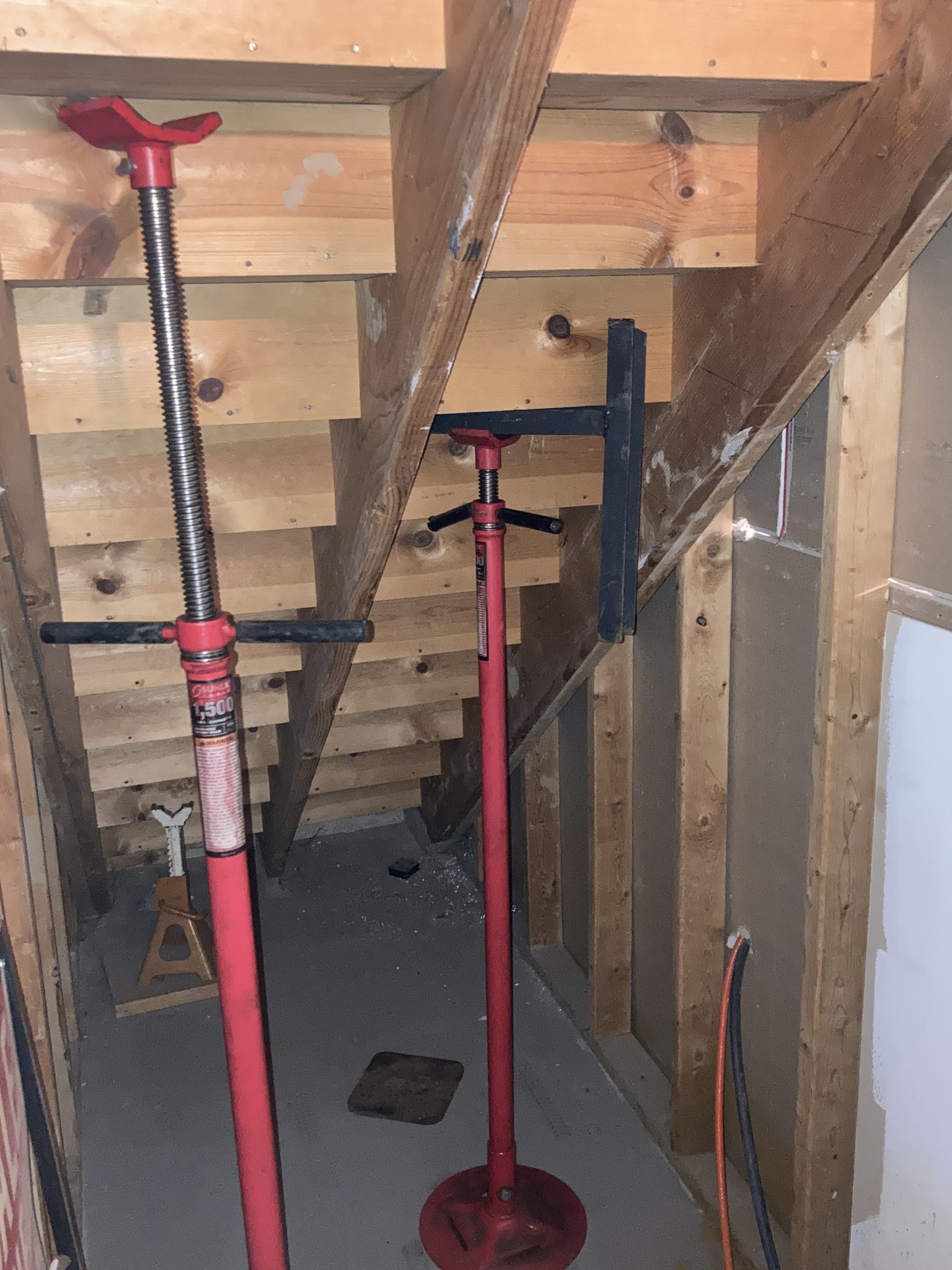

I am pretty sure my stairs could handle the weight, but this picture of me and my “new to me” lathe, crashing through the stairs and landing in a crumpled heap of blood and twisted metal kept flashing in my mind.
So I decided to “hedge my bets” and “shore up” the stairs.

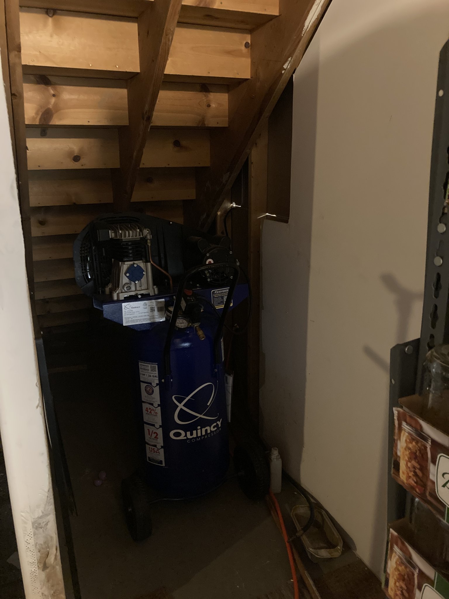

Last time I did this (for my big safe) I used a series of 2x4’s cut and placed strategically. here is the area before.
instead of timber I decide to use my “hoist jack stands”.
But the small “footprint” is not sitting well in my already crowded mind…
Hmmmm…what to do?..what to do???
Ah ha!!! It’s off to the “newly organized” scrap pile…
And they they are…the remains of the “failed PHD stand”

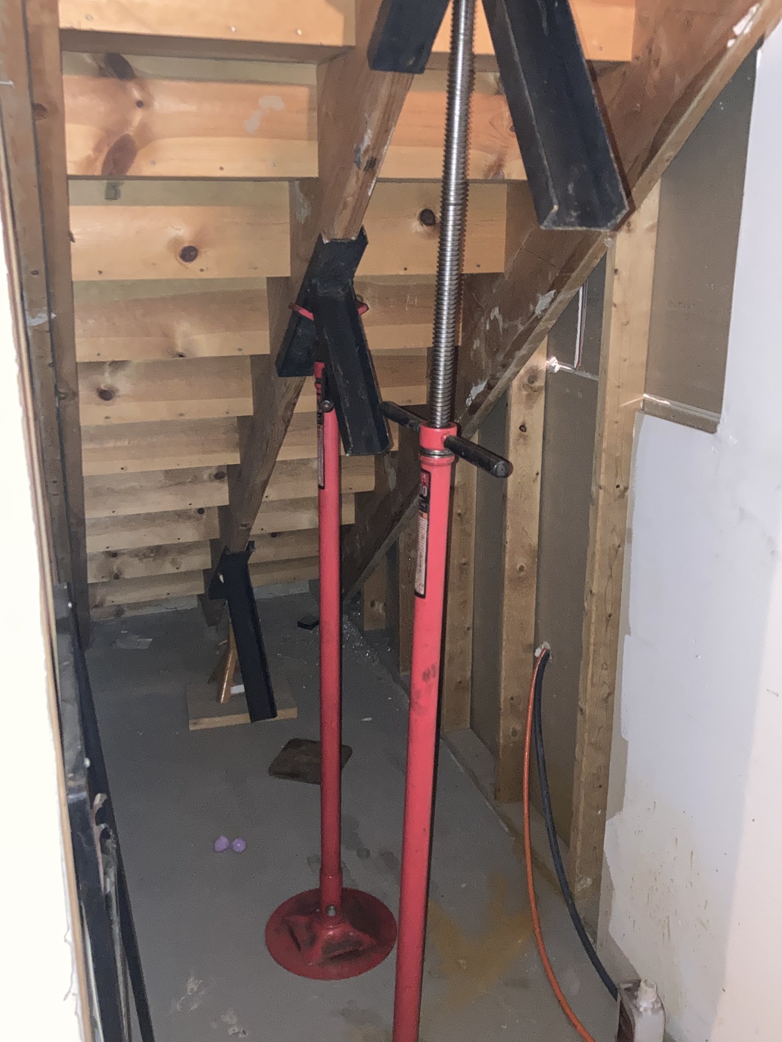

This is will give me a “bigger footprint” but I am still not “lovin it”
I decide that they would be better employed on that middle “stringer” so off to the drill press to make some mounting holes.
Then I attach them to the middle “stringer” with som lag screws/bolts?
This gives me that “warm and fuzzy” feeling I was looking for.

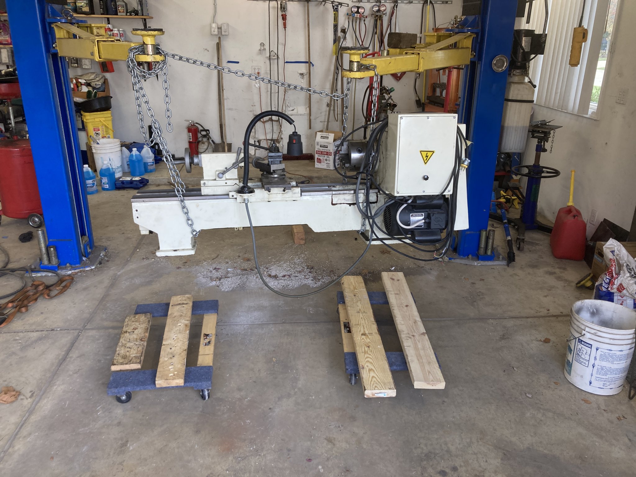

After that, it’s out to the garage.
So I borrowed my BIL’s “cherry picker” to get it on the porch. (what an odd name…Cherry Picker)

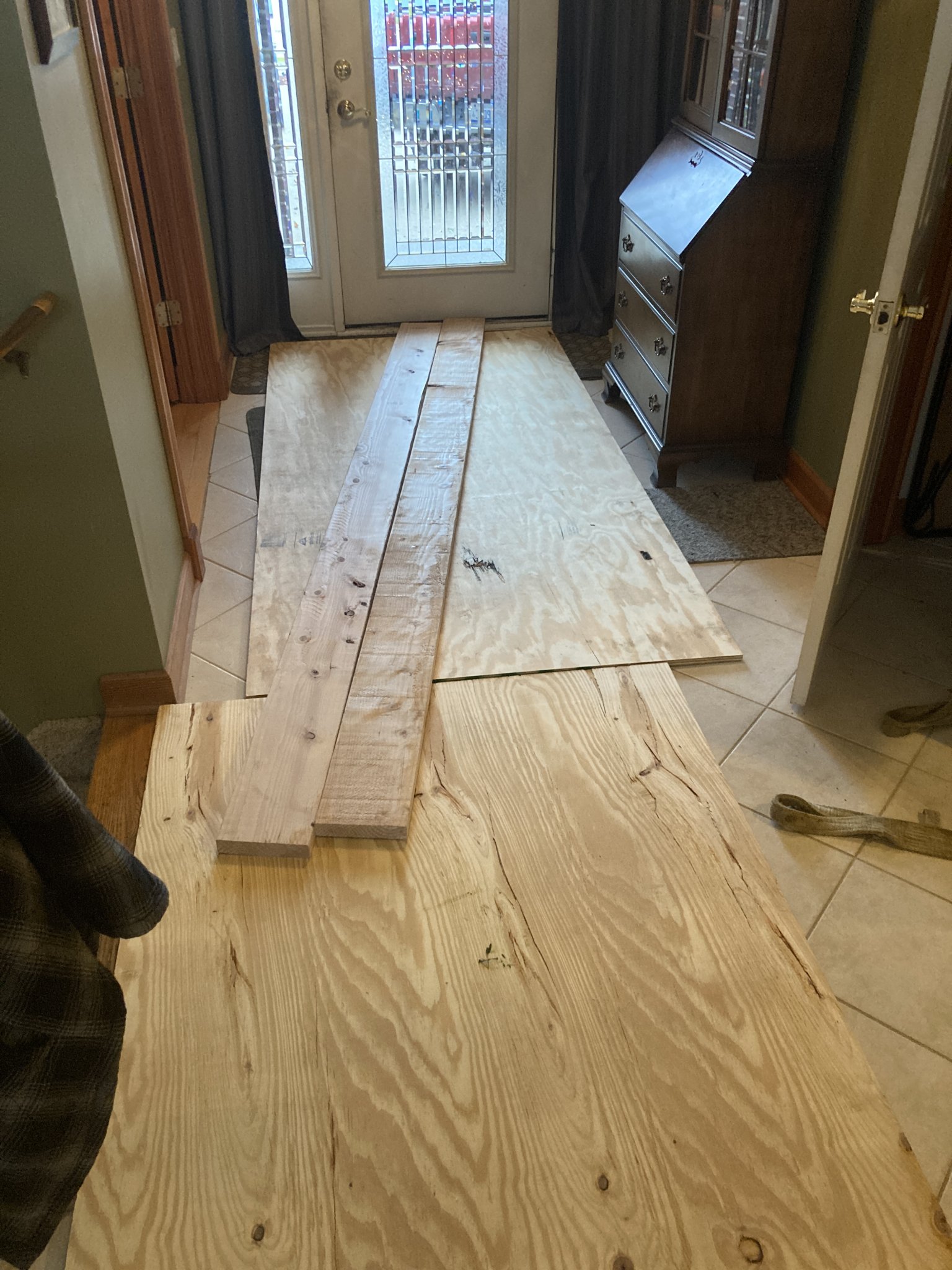

I originally planned to just use two 2x8’s to protect the tile as I roll it “Egyptian Style” across the floor; but again, the image of me hearing that “pop!” sound as I crack a floor tile, then envisioning Mrs. RWS going from "calm and nice, to Full Blown Apeshit Pissed Off at the speed of light, goes though my mind.
So its off to Home Depot to grab 2 sheet of 3/4" plywood to lay down as “insurance”.
(Next house is gonna have a 1st floor work shop, for sure!!! I am tired of this downstairs BS)

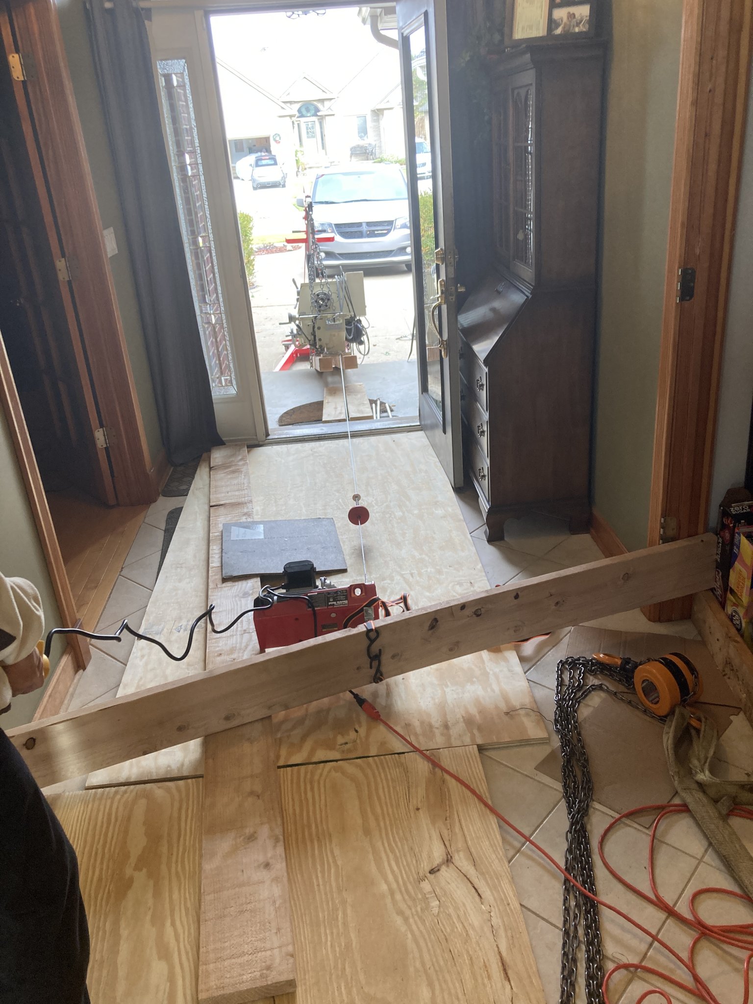

Well all is going well, but the legs of the “cherry picker” do not allow for me to get as close to the porch as I would like.
And pulling it “by hand” is a “losing battle” for my old fat ass. (I swear I could have done it 25 years ago?)
So it’s off to HF to get some help from Nicholi Teslea.

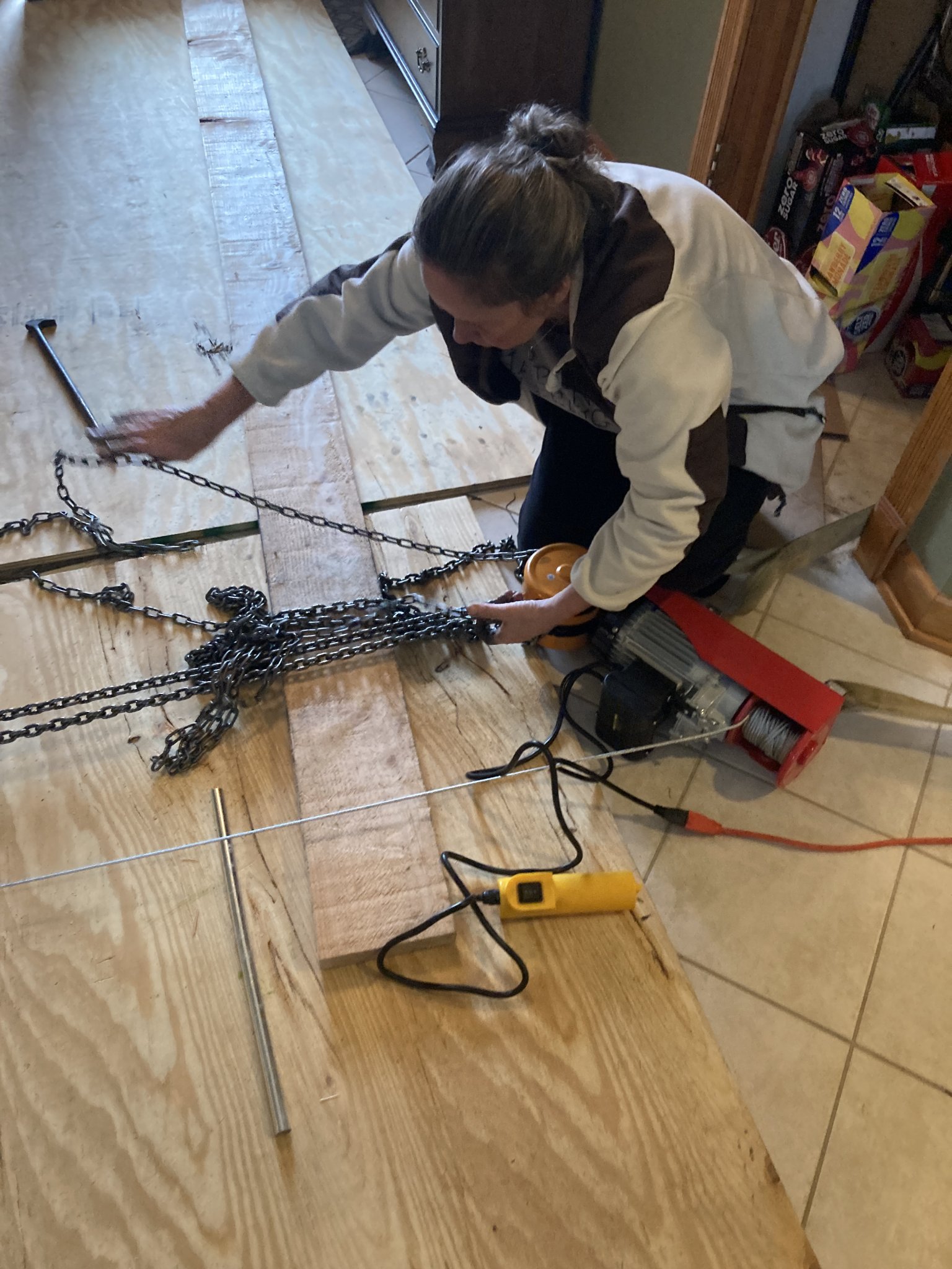

I am having a hard time figuring out how to “anchor it” but after 2 “botched” attempts, I place the board across the opening and use the walls and use a 2x8 to bridge the gap.
It’s about this time that the “safety Nazi” in me, goes on break for a while.
The damn “safety lever” keeps tripping the hoist due to the angle, so after abut 20 times of stopping , I decide to employ the “angle grinder”.
From there all is going as planned.
I cut down 2 aluminum bars to act as rollers and she pulls across those 2x8’s and plywood floor protectors like “butter”.

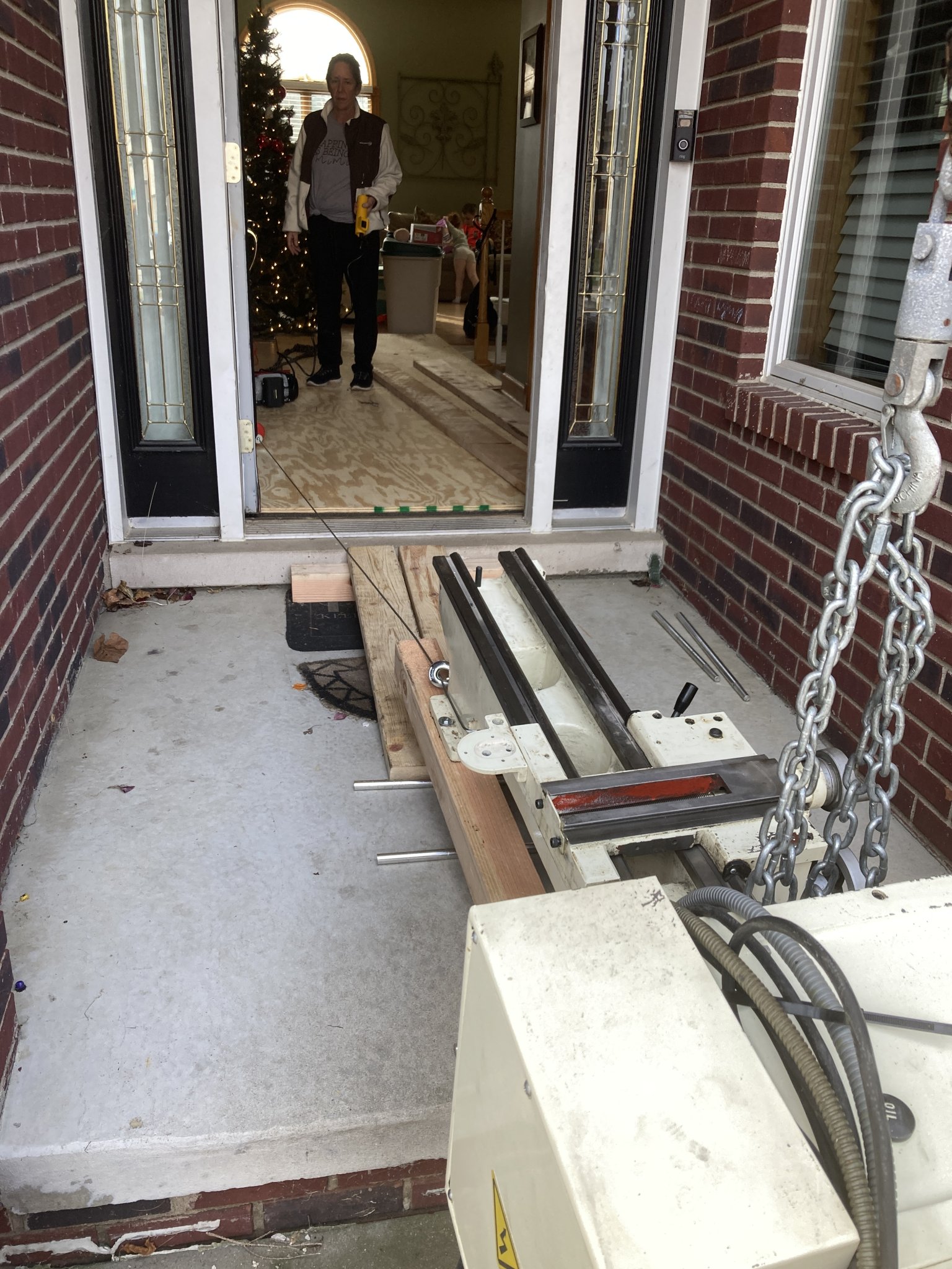

Now the the moment we have all been waiting for…“The Descent”…
I do not like the idea of a “single smallish Chi-Com cable” being the only thing between the anchor point and my 1K pound lathe as it decends.
So when I was at HF, I also picked up a 2 ton “chain fall” to act as a “safety stop” in case things go “kaddi-wampus”
Just like I did when I put the “big safe” down there years ago, I decide to use the walls as an anchor point.
To avoid damaging the walls and paint, I grab my soft “Snatch Strap” and use the ends to attach both “Teslea” and the “chain fall”.
Although I dislike using the same anchor point for both my “main” and my “secondary” hoisting machines, I reason that the snatch strap is rated at something like 15,000 to 20,000 lbs, so we should be good. (I can’t remember the actual rating but was in that area)
OFF WE GO!!!
Here is the Mrs. “manning the chain fall”, and doing a fine job!!!

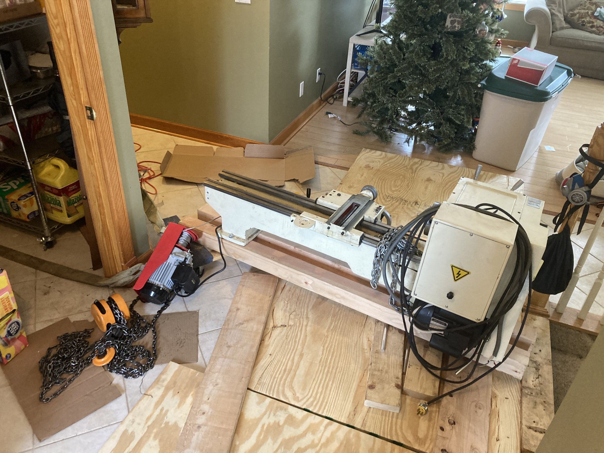

Slow and steady wins the race here.
The Eagle has Landed!!!
As you can see, I had to use Teslea again to pull it when it got to the base of the stairs, I tried prybars but could not get a “bite on it”.
