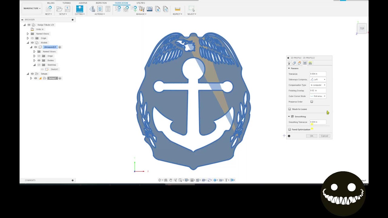

Anybody know why these ghost images appear when I hover over the sketch name in the left menu after they have been deleted? I’ve seen this before but never understood the cause.
I am having trouble getting this sketch to extrude as a solid body and not just lines. Design is not finished but already giving me grief. I’m wondering if the remnants are part of the problem.
Appearance when I hover over sketch name
Edit: I have copied this into another sketch and they go away, but it still doesn’t want to extrude. Still interested in opinions on why they appear.

Here’s the fille. Maybe the images are not part of why I can’t Extrude. I ran Fill Gaps on it and still no luck. I am going to scrutinize for issues more today, but feel free to try it out.
Badge Tribute v24.f3d (754.4 KB)
I could not get your image to accept the Profile. It kept giving this error, which you probably saw:
So I moved the eagle to the side, deleted half of the image and mirrored the other half. Changed the center line to construction. Moved eagle back in place and deleted some of the overlapping contours over the eagle. So you will notice that it is not exactly like your image as it is a mirror now.
Badge Tribute v24Chelan.f3d (2.5 MB)
I was able to make a cut profile. The ghosts showed up there too, but did not become part of the cut profile.

Take a closer look there, there re many odd artifacts within the path you developed. Try to simulated the file
Yeah, I saw some odd mystery points in space, I could probably delete them and refresh. Maybe. I really don’t know what I am doing other than “WWTWD”

@Sticks here is a screen shot of the simulation error.
this is an odd tought error but I think I found the root cause and I’ll live stream a video about it in a few minutes.

Badge Tribute v24 tin mod from video.f3d (2.6 MB)
What an oddity . deleting one line and replacing fixed the issue from warning “Failed to generate profiles as, curves do not precisely overlap”

So Tin, it turned out that I was ‘lucky’ I picked the right side to mirror. I went back and tried to mirror the left side and it locked up my system.

Thank you for the time you guys put in figuring this out. Just watched the video, and in addition to the solution, I learned several other things.
I will mark this as solved thanks to you guys! :clap:
