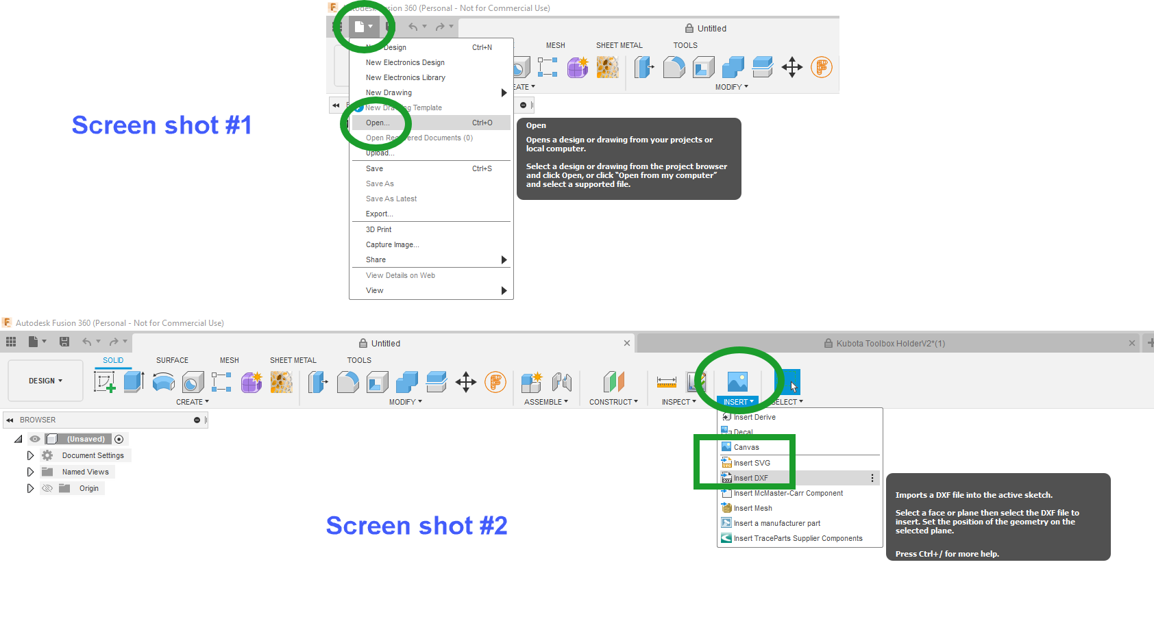

How do I get files from my computer into Fusion 360.I am not the most computer literate guy around,I have tried everything I know and have failed miseralby.Help!

Screenshot #1 shows how to “Open” an existing file you already have on your computer such as a .f3d, .svg, or .dxf.
Screenshot #2 shows where to go to insert a “Canvas” (which is an image file such as .jpg for tracing), a .svg, or a .dxf into a sketch.
