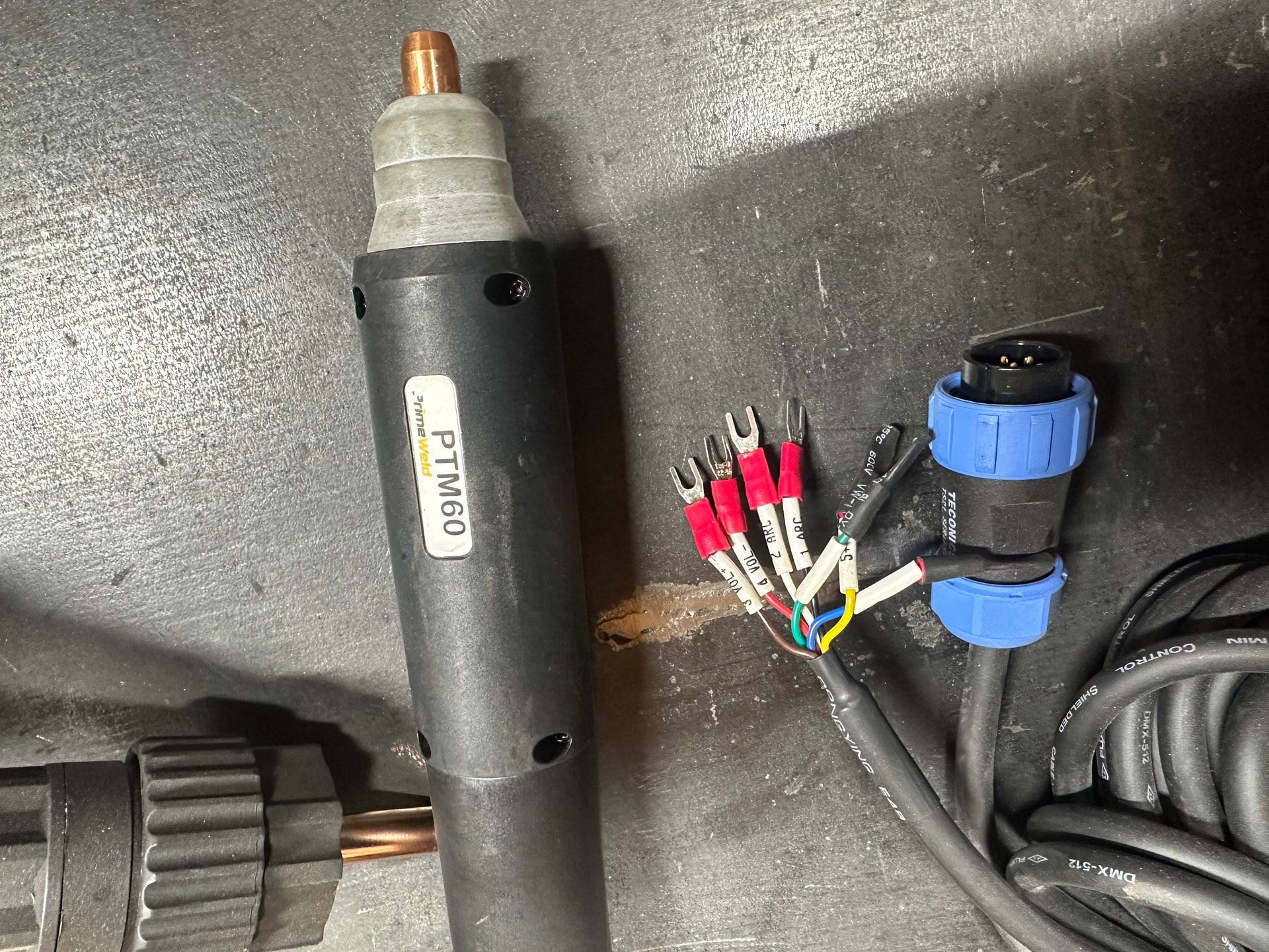

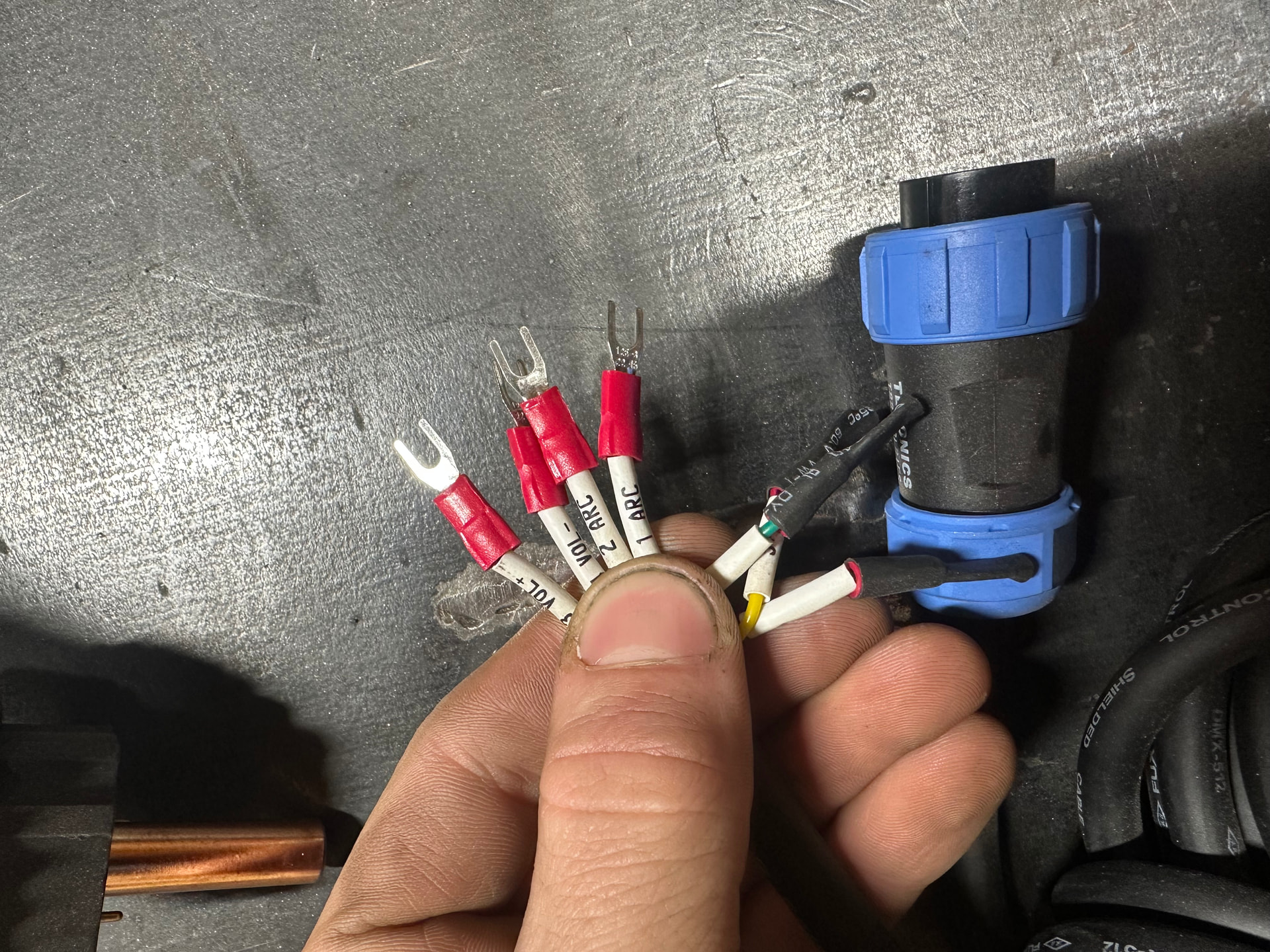

Hi, I’m trying to wire my gen 1 crossfire to my new primeweld cut60. I do not have THC, any guidance is appreciated
You were given the answer on Facebook.
I’ll repeat the same here. Your cable from your plasma cutter is pre-terminated and labeled, telling you what pin is what.
The manual states this as well.

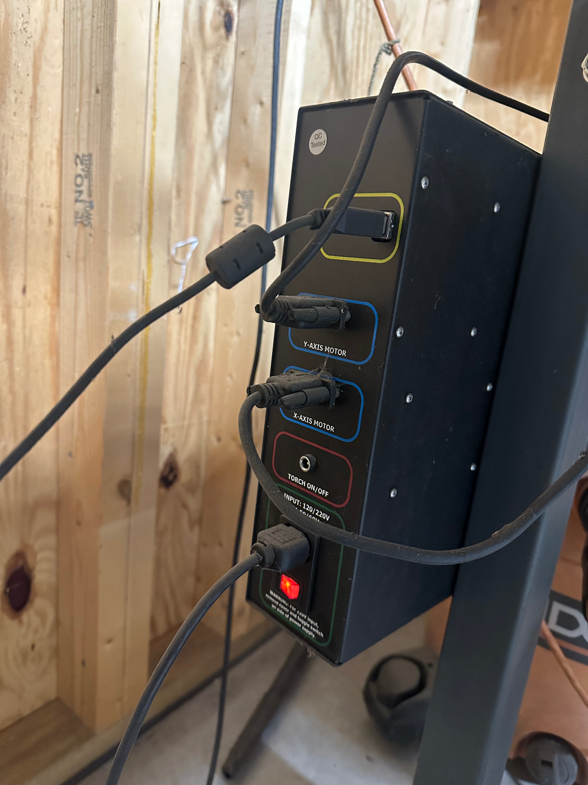

Your Langmuir table (Legacy) states it needs torch on/off to be wired to a barrel plug.
Use pins 1 and 2, as they are torch on/off in your own manual, and solder them to a barrel plug (5.5mm).
