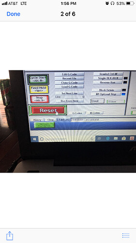

Mach3 is showing the error (“RnR Motion card not found”) that indicates the plug-in was not installed correctly or you haven’t connected the laptop to the control box successfully.
If you did actually run the break-in routine and were also successful in the “cutting your first part” tutorial video then your plug-in is correctly installed and it’s likely your USB connection or the control box. The USB cable needs to be connected and the control box turned on before you start Mach 3 (do you see a red led on the control board when you fire up Mach?).
If the control board doesn’t light then it’s either the board (& Support will need to get you a new one) or the USB cable is allowing interference which can be solved by a new shielded USB cable (about $8 on Amazon).
All of the troubleshooting steps are dependent on whether you were able to run the break-in routine as a starting point.

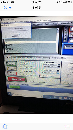

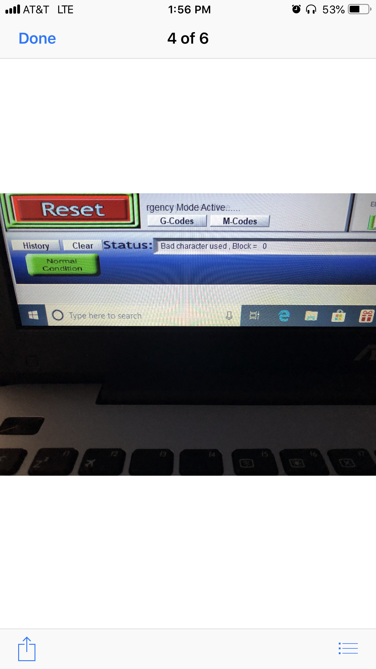

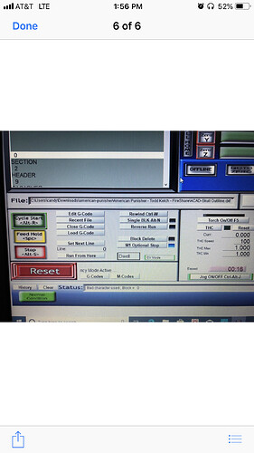

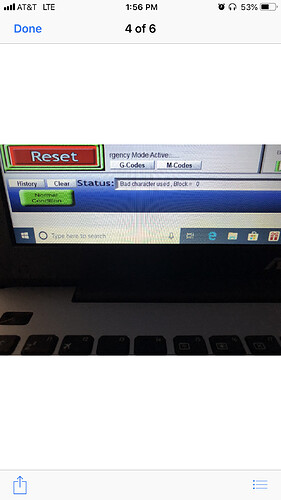

Redone everything. Ran break in program. Next I tried to download an image from Fireshare. It is a zip file so I extracted it to a dxf. When I go to load g code it shows codes but says bad code still at bottom.
A DXF file won’t run in Mach3.
Did you bring the DXF into Fusion or Sheetcam, create the toolpaths and then generate the G-Code (.tap file)?
