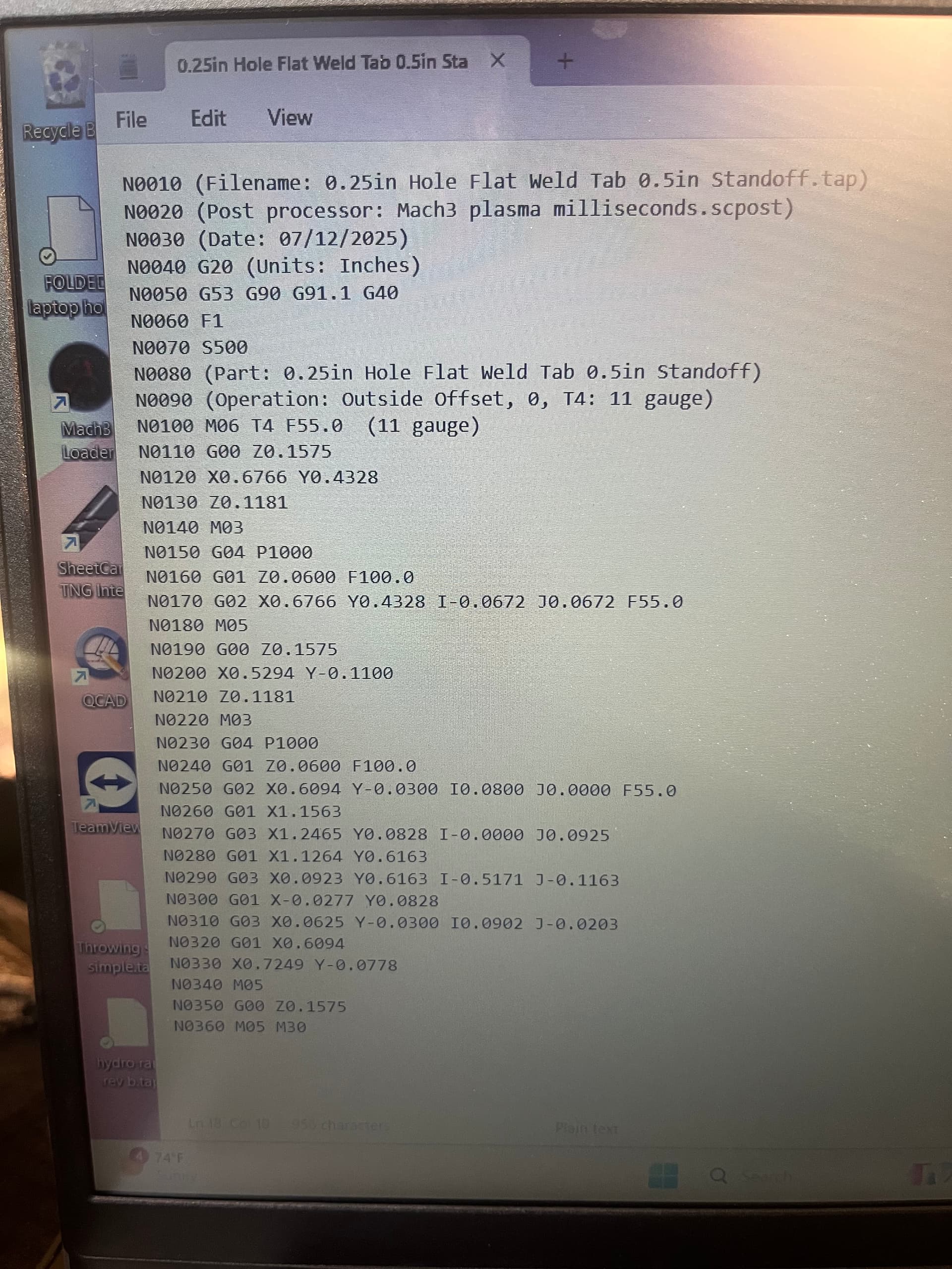

When I put .dfx files into my trial of SheetCam, add cut lines and post processor Mach3 will then start with cycle start, it moves to the first cut origin, the torch fires, but it stays stationary until I push cycle start a second time. It then cuts until it’s done with that cut and stops. If I then push cycle start again it will move to the next place fire the torch and stay stationary until I push cycle start again…this then continues until the part is cut. The cuts look prettty good from both the “cut ready” wrench, and the DFXs Ive added but its pretty annoying to have to constantly push cycle start over and over. What am I doing wrong? I assume its something in the post processing since the “cut ready”.
Post the GCode here and we’ll look at it. You don’t mention installing the Post Processor into Sheetcam. Maybe post the SheetCam .job file would be useful.
Also, Im not sure how to post the SheetCam .job file, but I have one.
Here’s the code
you need to use the “mach3 plasm with no Z” post processor since the original Crossfire doesn’t use thc or have a z axis.
@nicaDd is correct, but you also need to check your delay settings in Mach3. You need to set Config→General Config. Make sure ‘G04 Dwell in ms’ is checked. The checkbox is at the top of the General Configuration panel.
