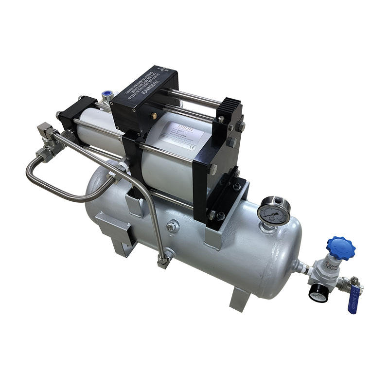

I’ve been contemplating a laser machine for a while and done some basic research as I already have a nitrogen generator. Although it is not able to generate that kind of pressure, I have read that people have used those compressed air boosters to increase pressure. It would need a tank in-between to store some volume and maybe have to increase pause time between cuts.
The same could work for a lower PSI compressor as long as you have the volume.
I have the volume (50 cfm), and the booster and auxiliary tank would not be an issue. If the flow requirements are not crazy. I need more information at this point. My issue with the booster pump is the god awful racket they produce.
Here is one example from McMaster carr, I’m sure cheaper could be found.
It appears that what ever multiple of pressure you gain, you loose the same in flow. I think 2:1 would be ample for most people as most home depot compressors will put out 150 psi at least.
That’s half the compressor..:thinking:
They can be had for a lot less, would need to check the specs of course but here is an example. Use the money saved to get a nitrogen generator. I got mine from Alibaba (4k$) and its been working great for my 3d printers. Now you have a unlimited supply of nitrogen for half the cost of the compressor.
