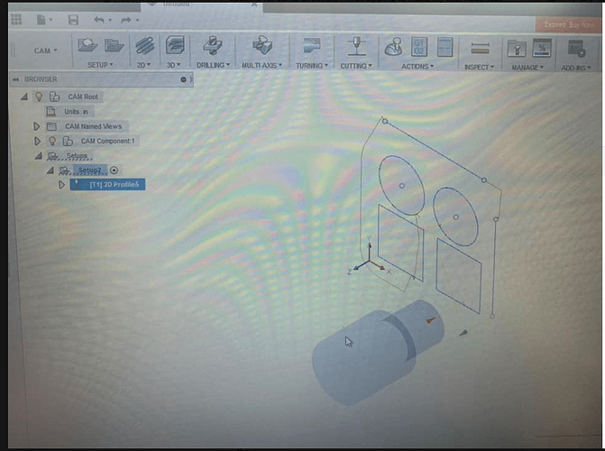

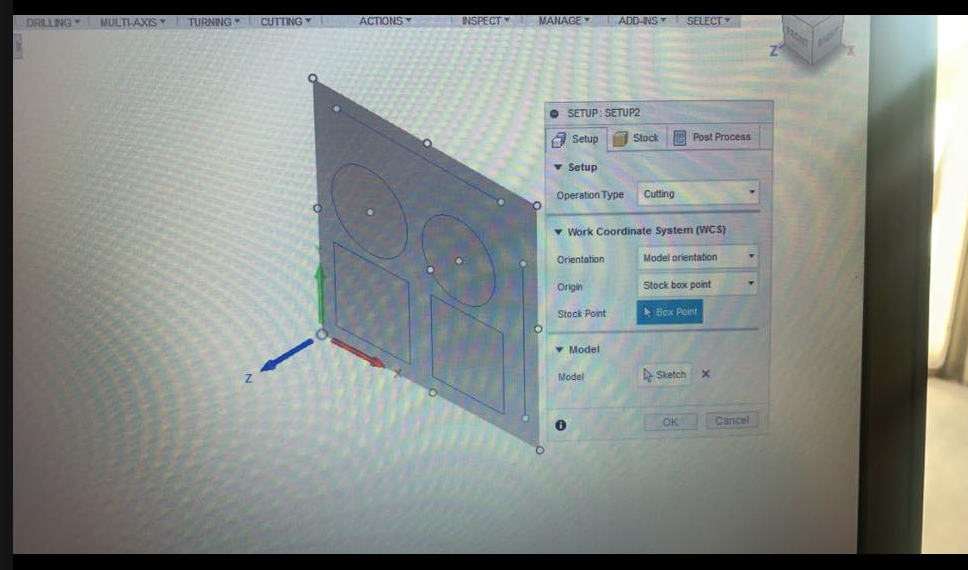

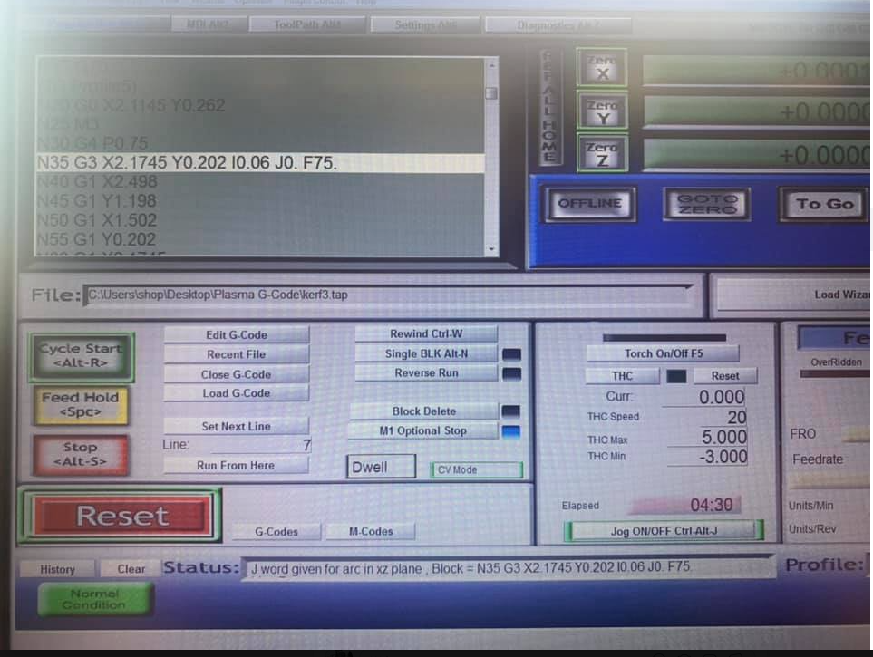

I’m not able to get my g code from fusion to run in Mach 3. I’m just trying to make squares and circles to confirm the kerf width on my plasma cutter. Attached are some pics from fusion and Mach 3. I’m able to run the break-in program with no problems so Mach 3 and the table are functioning. I think there is something wrong with the WCS but it is set like the videos show.
