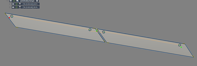

anyone want to take a look at this very simple file that I can not get the holes to cut?
you need to fix it just tell me what I am missing

Crawl space stair ends need 4 Chelan.f3d (183.9 KB)
Good job, Jimmy ![]()
That was supposed to say you don’t need to fix it. I need to proofread more.
Thank you
So after you send it back I found my mistake right off. My tool had a .2 kerf width I sure missed that.
