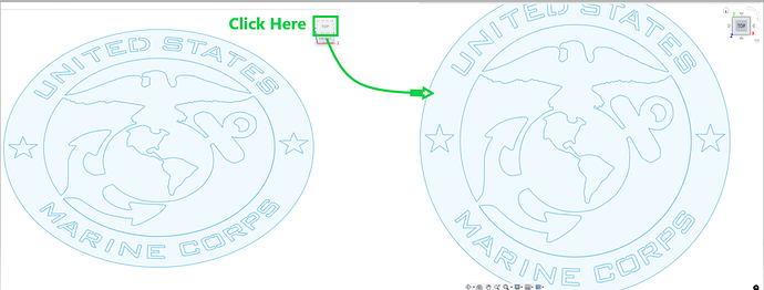

fusion 360 after update is squashing my canvas pic
You sure you’re on the correct plane?
I’m always up to date, no issues.

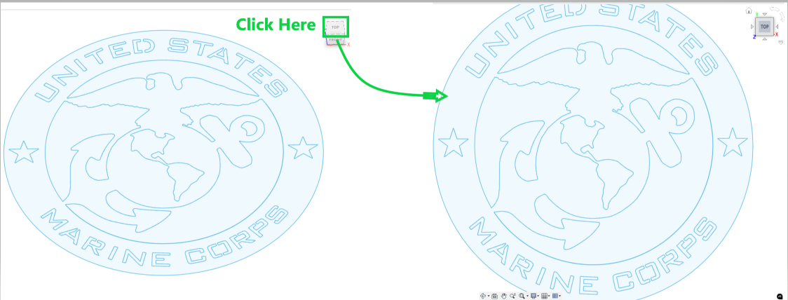

As KwikFab suggests, if your view is slightly skewed with the plane cube you might be getting the “squished view”
Click on the Top or Front plane of the cube and see if it changes:
Note: These views assume the sketch is on the XY plane

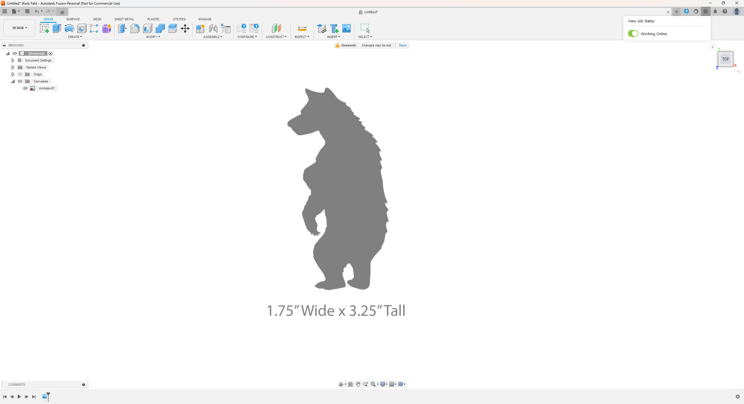

And just to add, I opened up Fusion and attached a JPEG as a canvas -
You can see it’s up to date, no issue
