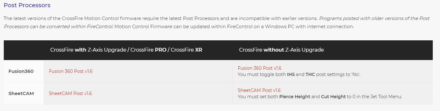

Very new to cnc world. having trouble finding gcode in fire control, fusion 360 was completed but when trying to download the file onto fire control there is nothing there, can someone point me in the right direction.
Thanks
Have you read through this? CAD/CAM with Fusion360 | Langmuir Systems
After you design your part in CAD, you have to create a toolpath in CAM and then post process that to create a g-code file that Firecontrol can use to cut your design.
As ds690 said follow the workflow outlined in the link he provided. The part I missed when I worked through it the fist time was step A5 in the workflow outline, loading the post processor. Maybe you are already past this but it took me reading through it a couple times before I realized what I had missed.
Thanks guys, got it. It would have helped to save it in the downloads
