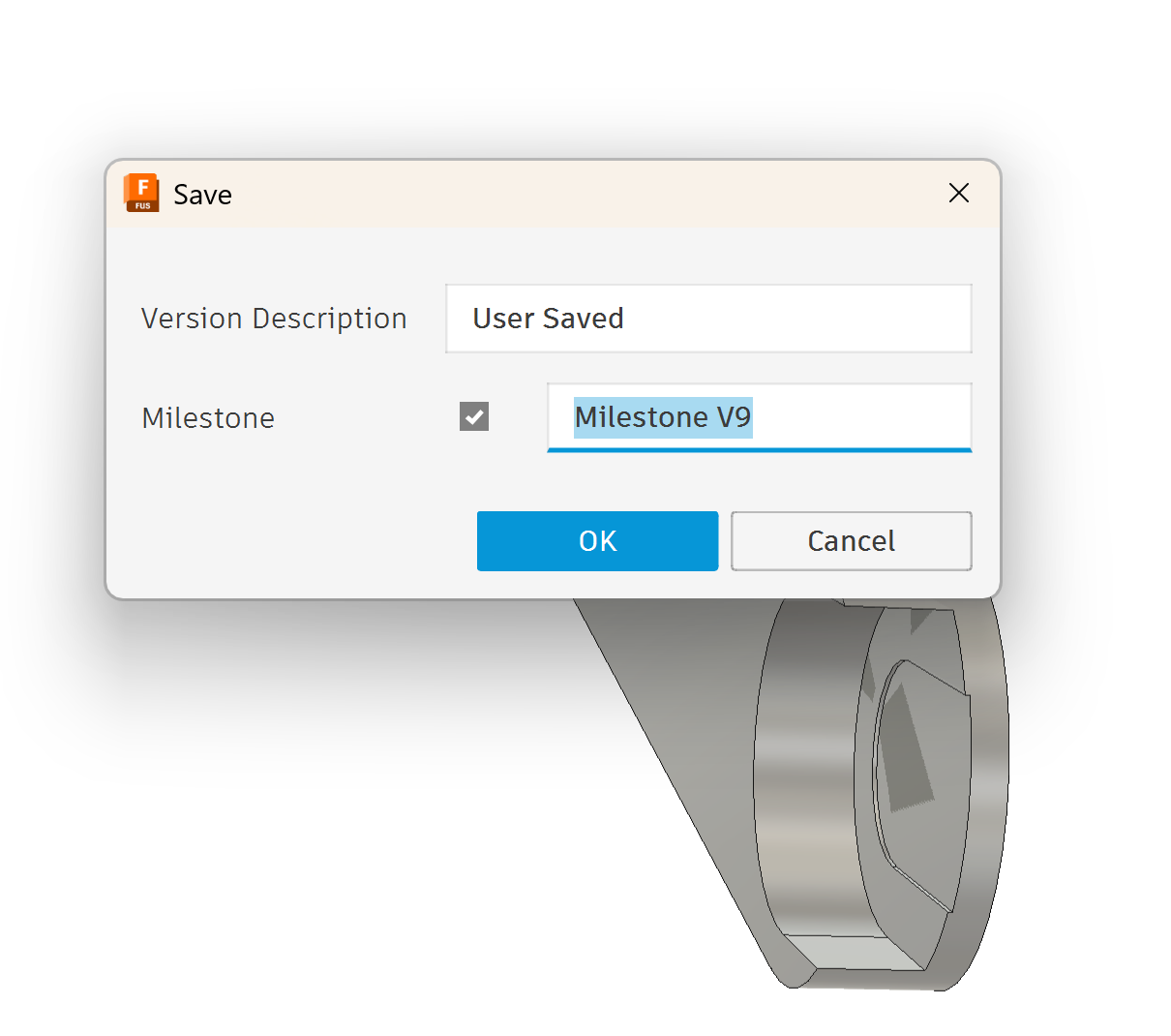

I guess I don’t follow here. I just updated Fusion last night, I just exported a file and I see the version number. The one thing I see different as when I am saving a drawing I have to check a box, and that adds the version number.

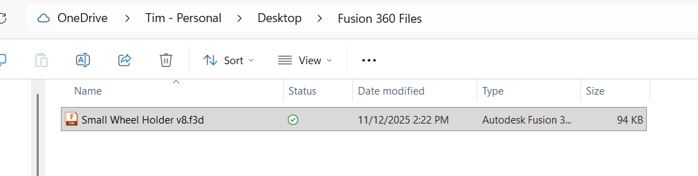

I have been sending massive numbers of Step files to my computer that is married to my printers. I like the version so I can verify that if it’s the newest one.
I also did some designing for a friend and we were making changes and I told him “make sure you are looking at version 8, it won’t be on version 7.”
Jim, What version are you on, I just checked mine, hobby version by the way. Version# 2605.1.18 x86_64
Sorry, I am not at home. I have the paid version.
step export has version in filename.
Perhaps my version is corrupted but nothing has versions in mine.
