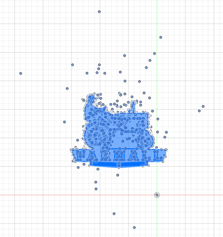

I imported a dxf, that I got off of fireshare, into Fusion 360 and it comes in as 3881 opbjects. I don’t know what I did different than other imports.
It likely just means whomever put the file to Fireshare had converted an image, like a jpeg, to a .dxf or .svg. It’s a common way to get an image into CAD.
Try this one:
Farmall Update.dxf (209.3 KB)
You’ll want to delete the border unless you want to bridge some of the features. It’s the same image but without most of the stray points.
