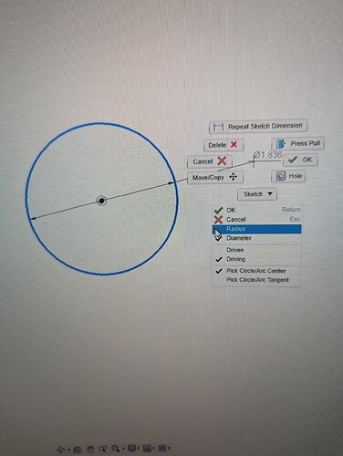

On the radius vs. diameter math thing, you can use the math of course, but you can also right click when dimensioning to set the cirlce dimension as either a diameter or a radius.
