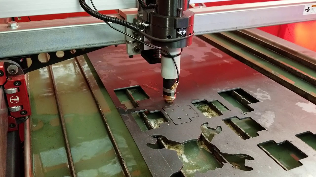

First cut
100 ipm at 45amps and 55psi. Did a 3" test cut with z stepper disconnected to grab the voltage of the THC which read about 69. I am open to suggestions on how to reduce the dross.
