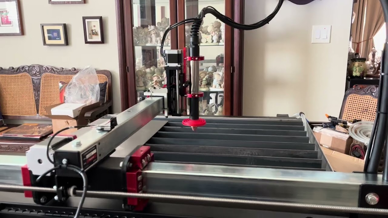

Looking for help as I can’t move forward until I resolve this situation.
This is my configuration:
CrossFire CNC Plasma Table
CrossFire XL Expansion Kit
CrossFire Z-Axis + THC Upgrade Kit × 1
Limit Switch Kit for CrossFire
Razorweld Razorcut 45 CNC with Machine Torch for PRO, CrossFire
Machine Torch Mount for CrossFire
Software is the latest release for both the firmware and FireControl software.
None of the things I have tried have resolved the problem. I keep reading similar threads looking for a solution…
I have tried:
  1. “Reset Machine Defaults” button, then command the machine to home, and made sure not to manually jog any axis until the homing sequence is complete.
  2. Checked all connections.
  3. I can manually jog all three axis without issues.
  4. X-axis moves correctly and stops once it reaches limit switch on that axis. Video shows this clearly.
  5. If manually activating the switches, I can see them lit up on the FireControl bottom panel. So they work… it is the direction of travel of the Y-axis that is the issue…
Video link:
Y-axis travels in wrong direction - YouTube

I should have said something before the photos :rofl:… I am installing everything inside my house because it is hot as heck out in the garage… I wil not be filling with water (I have the plasma cutting fluid recommended by others) while inside the house. Once I have tested everything related to the CNC side, I will move it to the garage and then test whole setup with the plasma cutter machine…
Thank you for the comment on the torch. It is not tight at the moment. I will fix the location of the torch on the clamps. EDIT: Corrected the mounting of the torch and also moved the plasma machine to the other side…
Again, not firing the plasma cutter inside the house… but good point on the location of the plasma machine. I will move it to the other side of the bottom shelf.
I do want the limit switch… and even if I do not use them, the Y-axis is traveling in the incorrect direction… So I need to fix that… if I fix that, I fix the issue with the limit switch on that axis.

I may be wrong, but it looks like you have the limit switch installed at the wrong end of the Y axis. It should be at the end where the stepper motor is located. The “machine home” position is in the rear left of the machine. Movement away from the switches will be X+ and Y-.

Humm… that might be it… let me check the install steps again… I hope is that easy. Thank you!
Why the heck did that did not occurred to me last night??? I must be getting old… good grief.
That explains positive movement instead of negative… it all makes sense now…

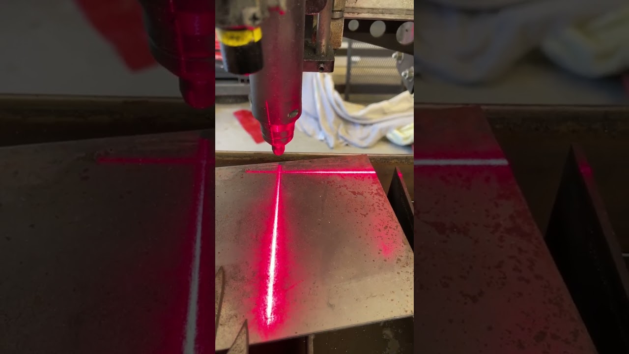

one thing you might want to have on that Beautiful set-up is a set of laser pointers…they really help laying out parts…

@toolboy what a great idea!! I will check out the video after I am done with this call… Thank you!
And @ds690 , you were correct. I installed the limit on the wrong end of the rail!!! Easy fix. Will tackle in a couple of hours.

Was able to watch not only the video on the laser, but also the other ones you shared.
  1. Lasers - looking in Amazon for those and the holders

Search this forum for Laser Aligners, you’ll see a number of different implementations.
