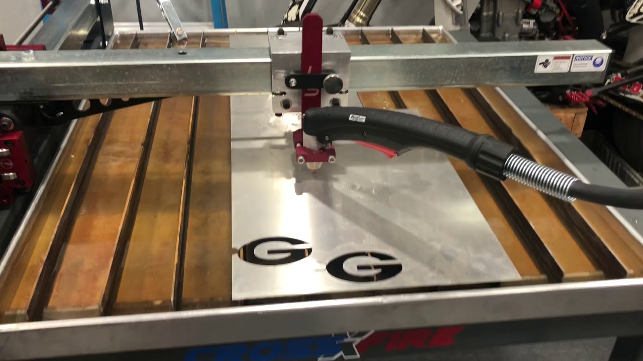

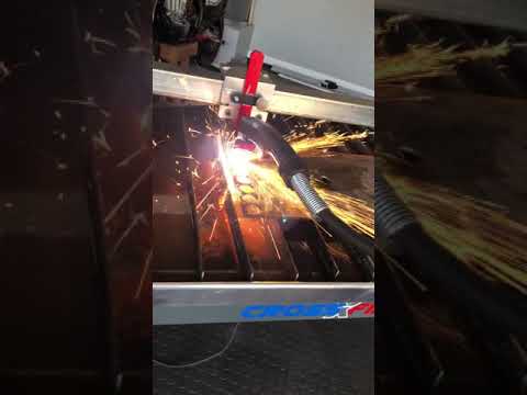

Wanted to start small so I cut out some 1” circles to finish a wine rack I started months ago. He’s a short video I posted on YouTube too.

Great job Brian- what material is that? The cut quality looks great in the picture.
Also, i cant tell from the video but are you using the ‘keep nozzle down’ function in Fusion 360? This arranges the toolpaths and rapid moves to avoid having the torch traverse across a previous cut section- thus minimizing the risk of colliding with a previous tipup.
If you’re needing more time to clear a tipup before the torch moves onto the next cut, there is a way to increase the delay in Mach 3. I’ll try to do a write up when i get some time.

No don’t think I did keep nozzle down was wondering why it kept jumping around so much. Had some issues with linking with this too. It wanted to cut the outsides before finishing the inside cuts.
