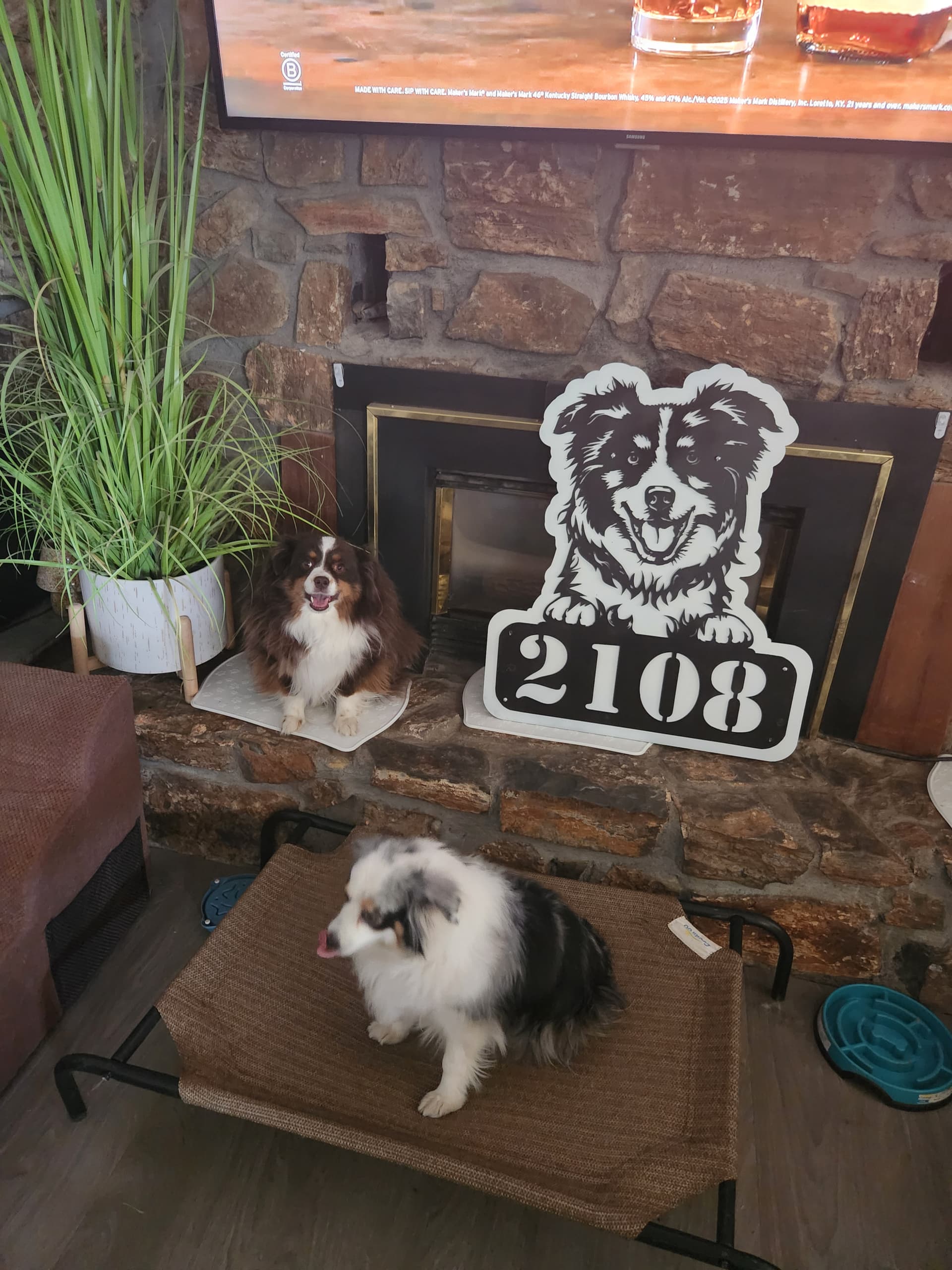

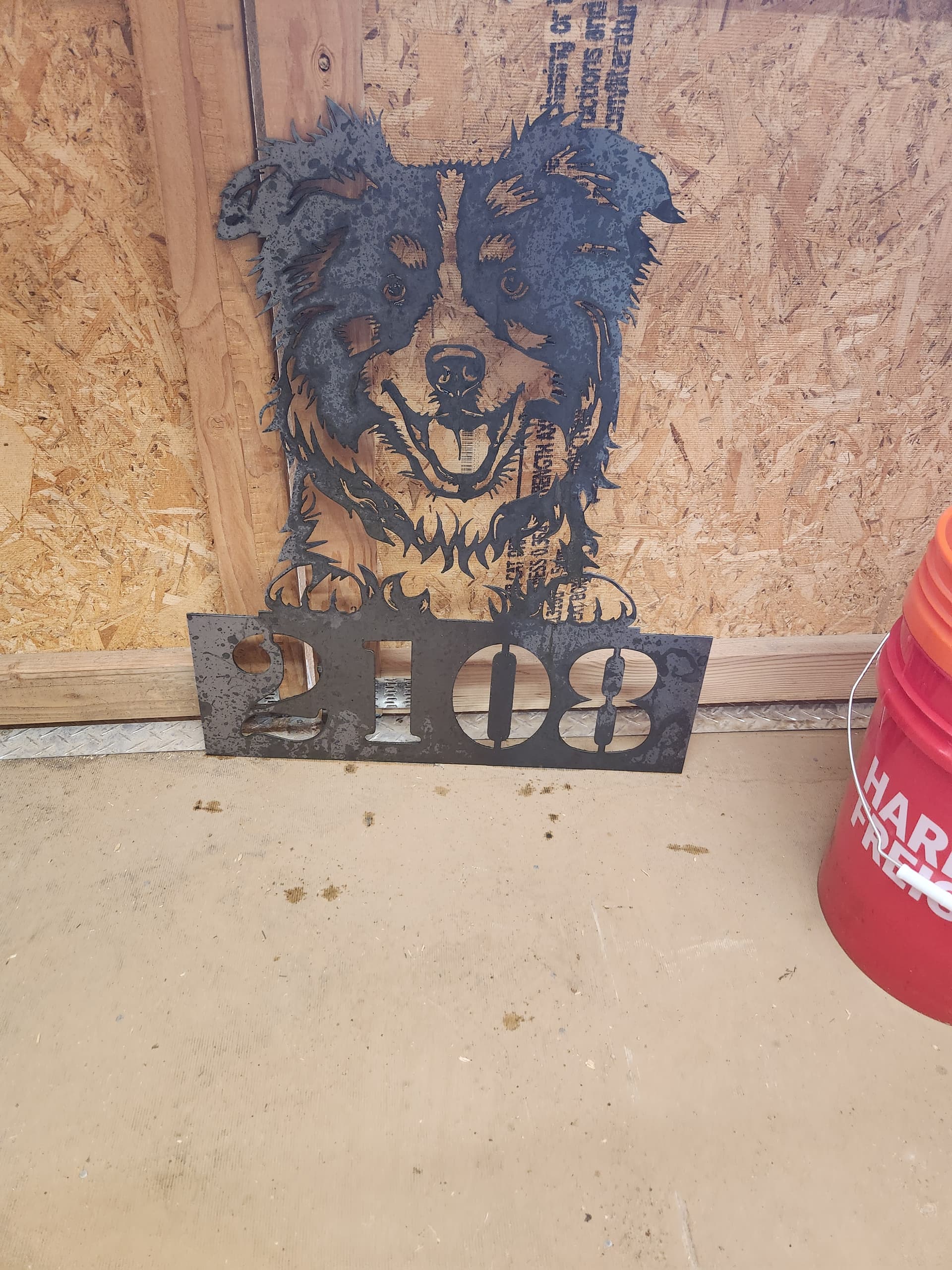

Well here is my first real cut with the Crossfire Pro, and Everlast 82i. Thank you all for your input. finished glueing the mini fairiy leds to the back

Was definitely not expecting the 2nd pic to come out of the first, looked like some kind of demonic zombear
Definitely a hidden message there! I’d advise against doing anything extreme for a while… ![]()
