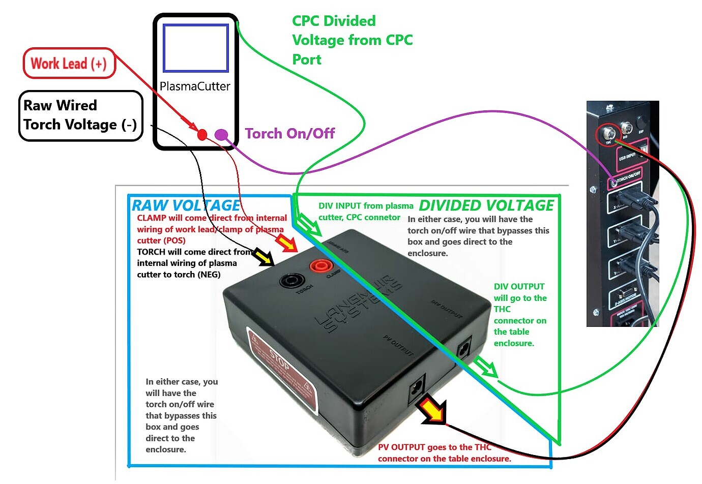

I am running a prime weld cut 60 on a crossfire pro table I did the hook up threw the cbc port 1&2 and 4&6 are the pins the manual told me to use the two white wires that come out of the port I was wondering what port I hook them two one the thc control box thanks any help would be appreciated don’t want to crash the machine on the first cut thanks
if you want reliability with this machine you will hook it up using the raw voltage installation.
Only use the CPC port for the trigger (fire) circuit.

The two white wires should go to pins 1&2 and plug into the control box where it says “torch on/off”.
That is what fires the torch.

Wrong wire, pins 4 and 6, not pins 1 and 2.
1 and 2 go right into the front of the control box with the barrel plug. It says torch on/off.
If you ran raw voltages, here is a diagram.
If you are still on divided voltage from the CNC port pins, follow the divided voltage illustration
I must ask if you have the red lead to the positive clamp? The black lead goes to the torch.
The black lead I hook to the torch side inside to plasma not threw the cnc port
And the red lead went to the ground side in side the plasma
The clamp side is positive, and the torch is negative. But that’s good. Now, take the banana plug with the aircraft-style plug and plug it into the control box that says THC. Take the wires from pins 1 and 2 with the barrel plug into the control box that says torch on/off. Look at the illustration and make sure the banana plug is in the PV output slot on the VMI (black box). Not the Div output.
Then you’re plugging the wrong cable into the PV output.
The cable that is attached to pins 1&2 goes to the torch on /off port on the electronics enclosure that is bolted to the table leg.

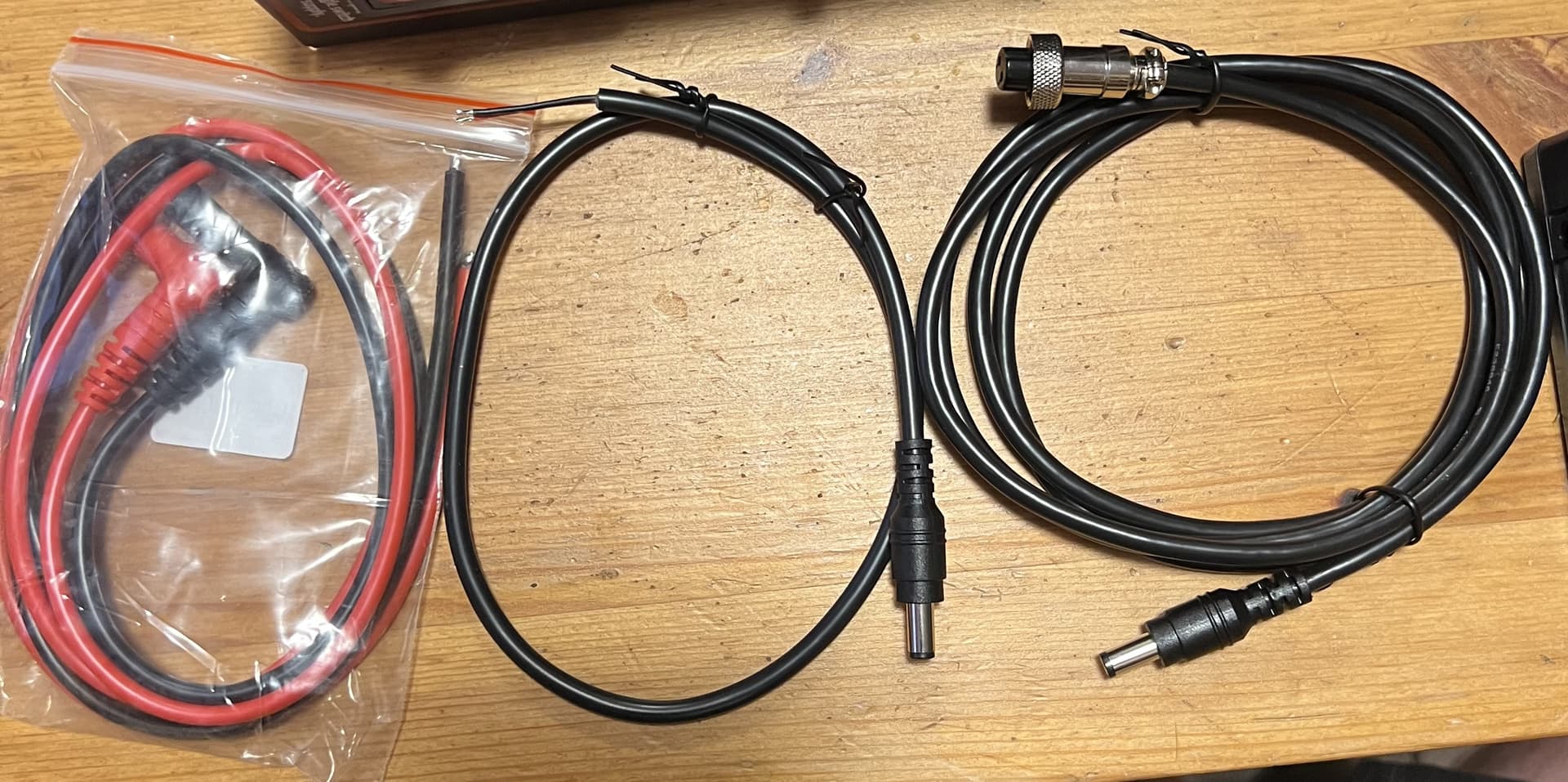

Hopefully one more question I do have water in the pan but do I have to cut the end off the thc connection to hook the banana clip on to the thc original wire with the plug on one end and aircraft plug on the electronic enclosure
Think I have everything else changed just a little confused with the banana clip
You should have one already from Langmuir
These are the cables. Sorry mine has the banana plug but it looks like they changed the style. The one on the right goes from VMI box PV output. The one in the middle goes from your CNC port to the torch on/off on the control box.

If you connected to the torch and clamp inside the machine, you should have separate red and black wires. Those get plugged into the color matched ports on the face of the VIM( black plastic box). Then you need a cable from the PV output on the VIM to the THC port on the electronics enclosure.
No other ports on the VIM are used in this situation.

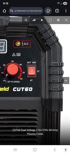

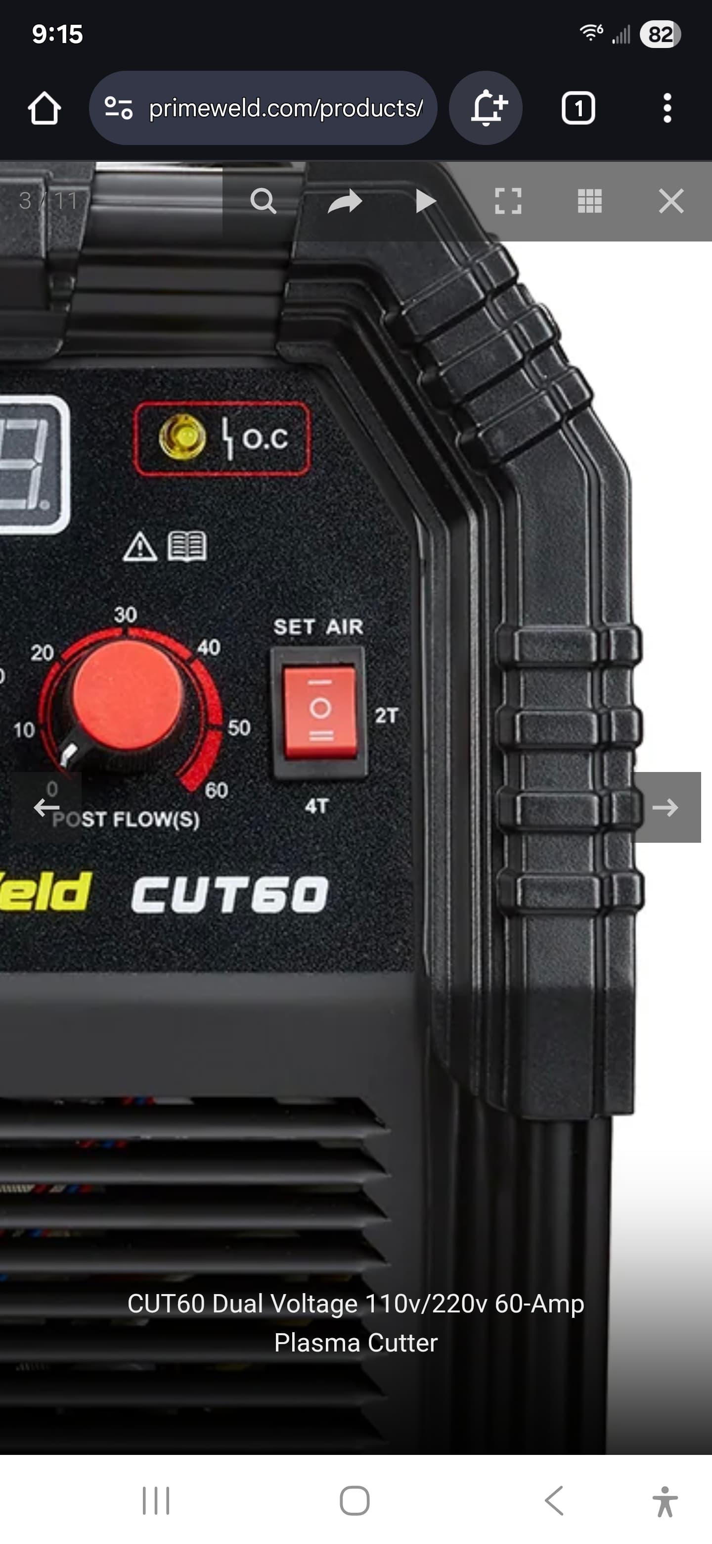

Make sure the primeweld is set to 2 T, not 4 T.
I’m not a fan of the Prime Weld Cut 60, but lots of the guys here use it without any issues.
Set your post flow to 30 ~40 seconds to cool down the torch… Go burn up some metal.
