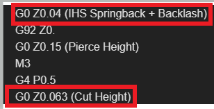

(PS19)
Good g-code.
When you cut you are likely going to have some trouble getting a clean cut because the torch will be too high. Will see.
Why do I say that? You are cutting at a speed of 19 ipm which suggests that you are cutting 1/2" thick steel. I hope you plan to do a sample cut first. Any cut problems are often accentuated with thicker plate.
Your g-code has these two settings (Springback/backlash and cut height that will determine the cut height). Since it is plate thicker than 10 gauge you don’t need the additional springback since the metal will not flex that much. Your g-code will be adding the springback/backlash to the cut height (0.04+0.063=0.103). You will be a full 0.04 inches higher than you want to be.
This will result in a bevel:
And there will likely be poor penetration of the metal with lots of topside dross.
Do some test cuts first.
Actually It’s 7/64 aluminum. I got the 19 from RCs manual. But I’m definitely shooting from the hip here. I’m not even sure about the amps.
Thanks
7/64" is 12 ga., so you will want to be running much faster than 19 IPM to cut that. At 45 amps, you will want to be running at least 100 IPM and maybe faster. I’d do some tesing on a small part to dial in the speed first.
