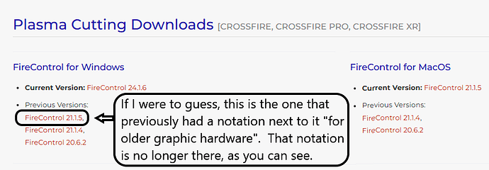

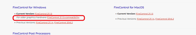

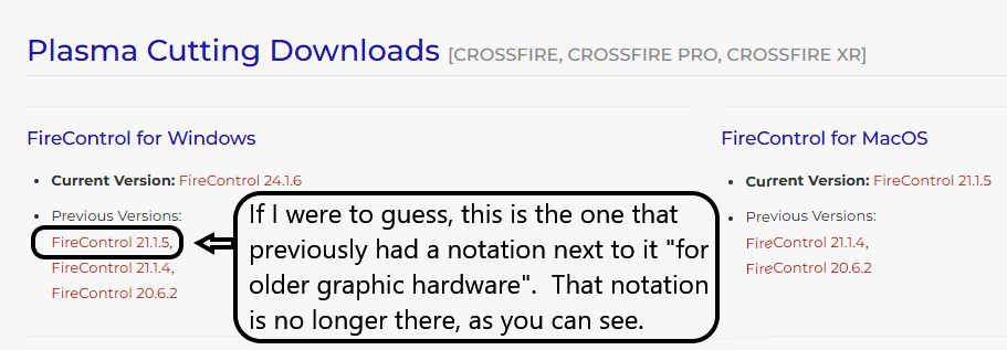

Let me start over. This is how the download page used to look:
I circled the one you will be looking for. It is version 21.1.5-compatibility
My conclusion is the they have removed the plain jane version of 21.1.5; and just left the “compatibility” name off since the new current version supersedes it. Back then, they had to tweak the current version. The current version is obvious a few versions along: FireControl 24.1.6.
That version is still available on that download page linked above. So I would say 21.1.5 IS the one compatible with older graphic cards.

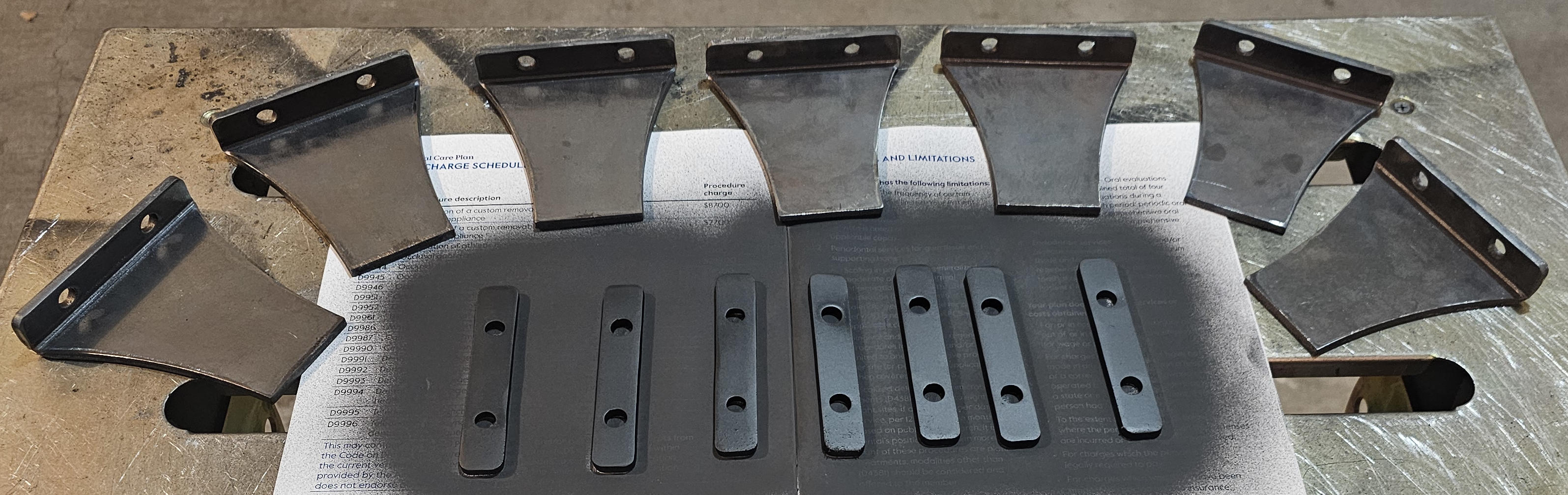

On a fun note, I cut these today (including holes for 8 mm bolts) on my CrossFire table and bent the brackets in my press brake after heating the metal in my kiln to 1000 degrees to help get the crisp bend in each 3/16 inch piece of mild steel without stressing the metal. These are going on my truck tomorrow as mounting points for a roof rack. The 7th piece of each set is an extra.
